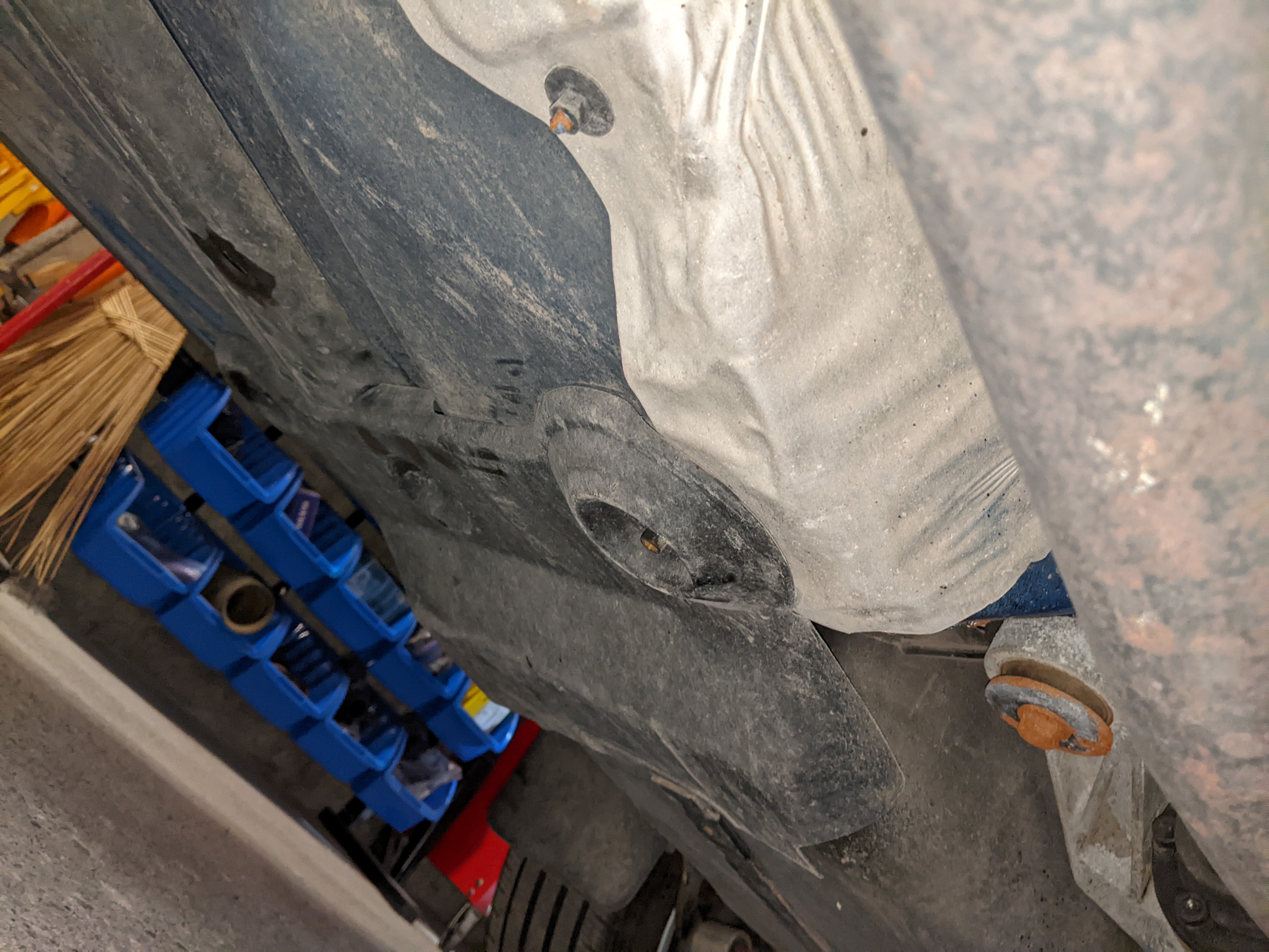

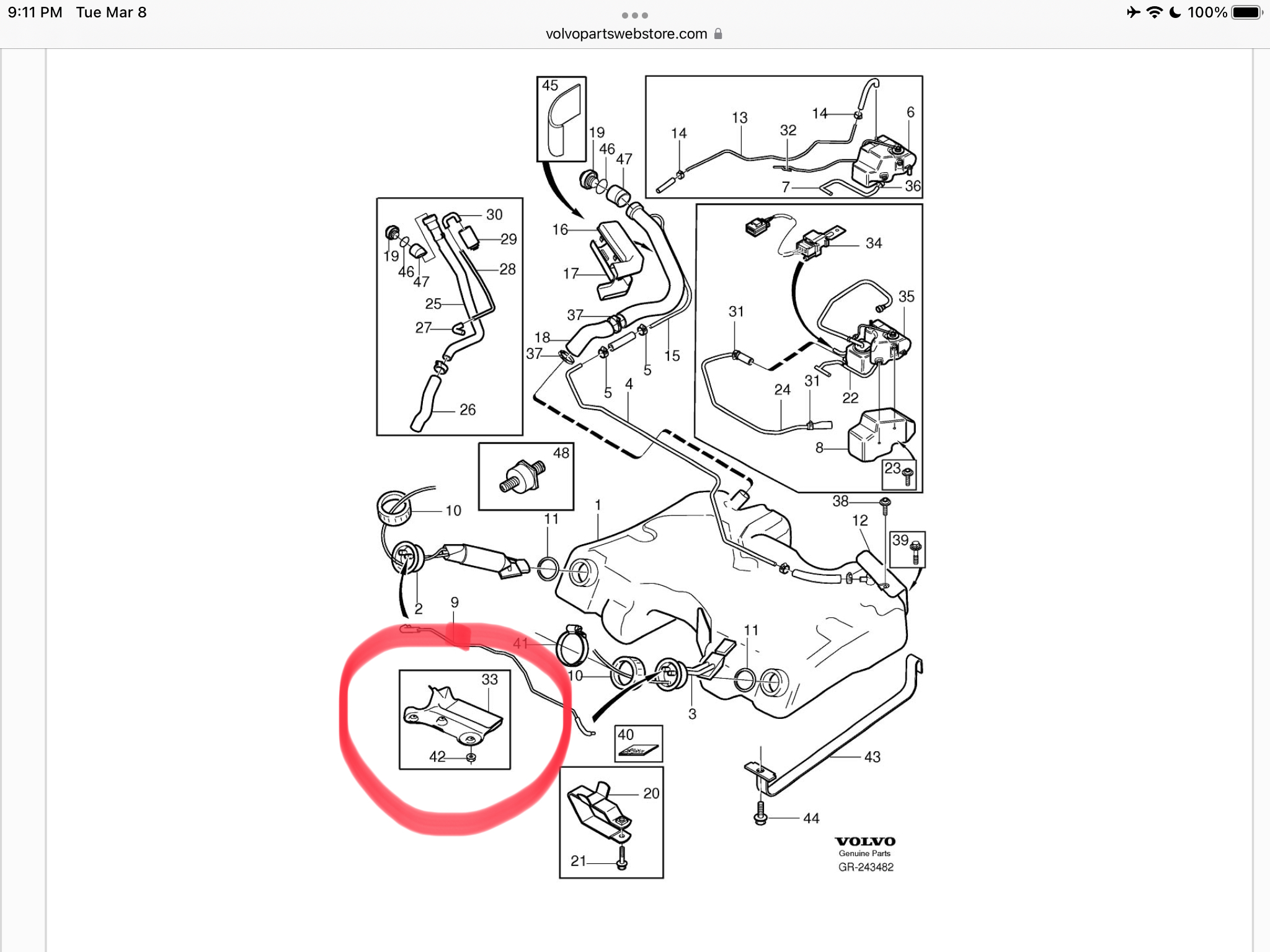

Can someone o the AWD club get me a pic of how these go on? I have to do this in driveway so it’s hard to get these sorted…

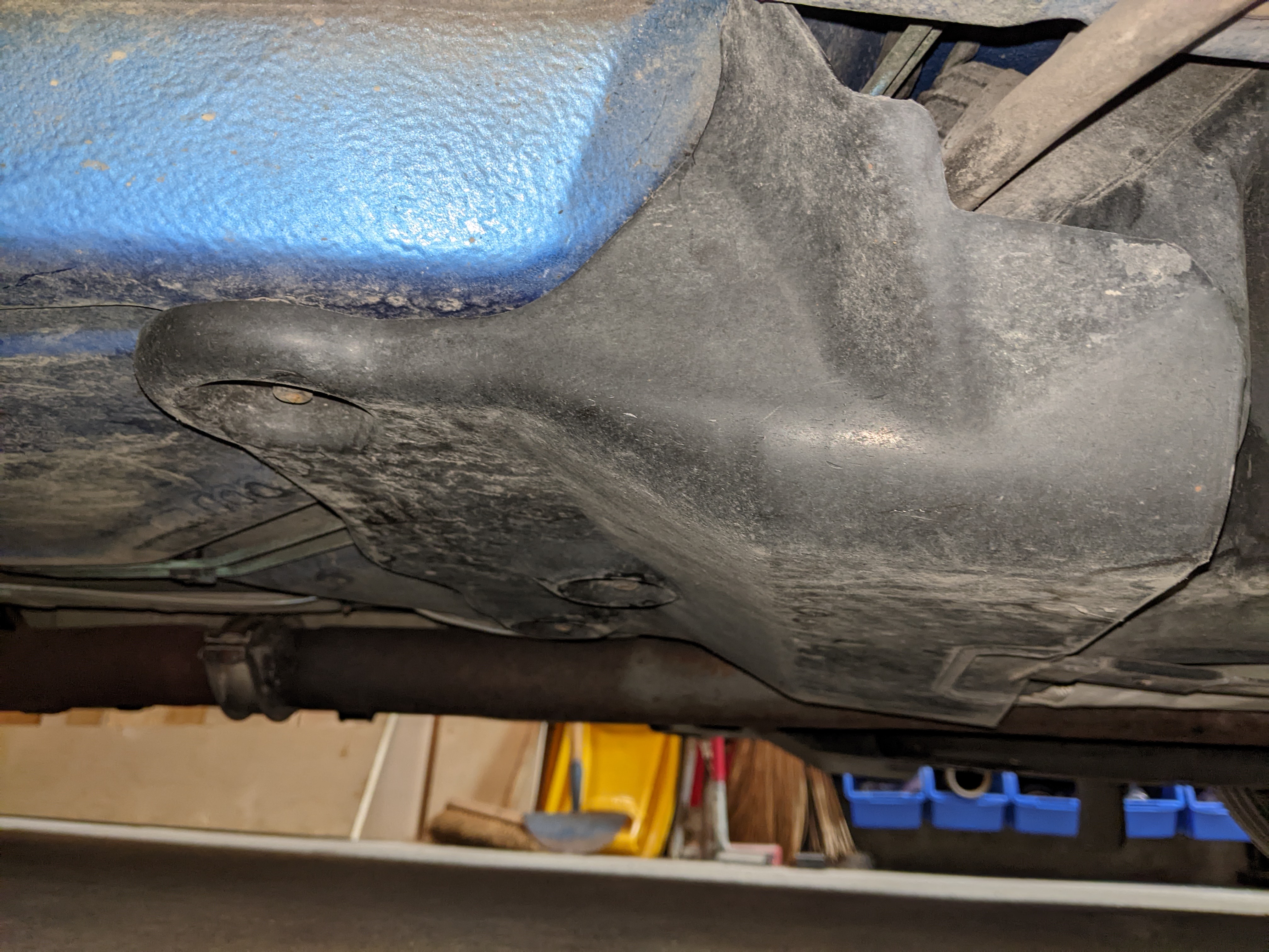

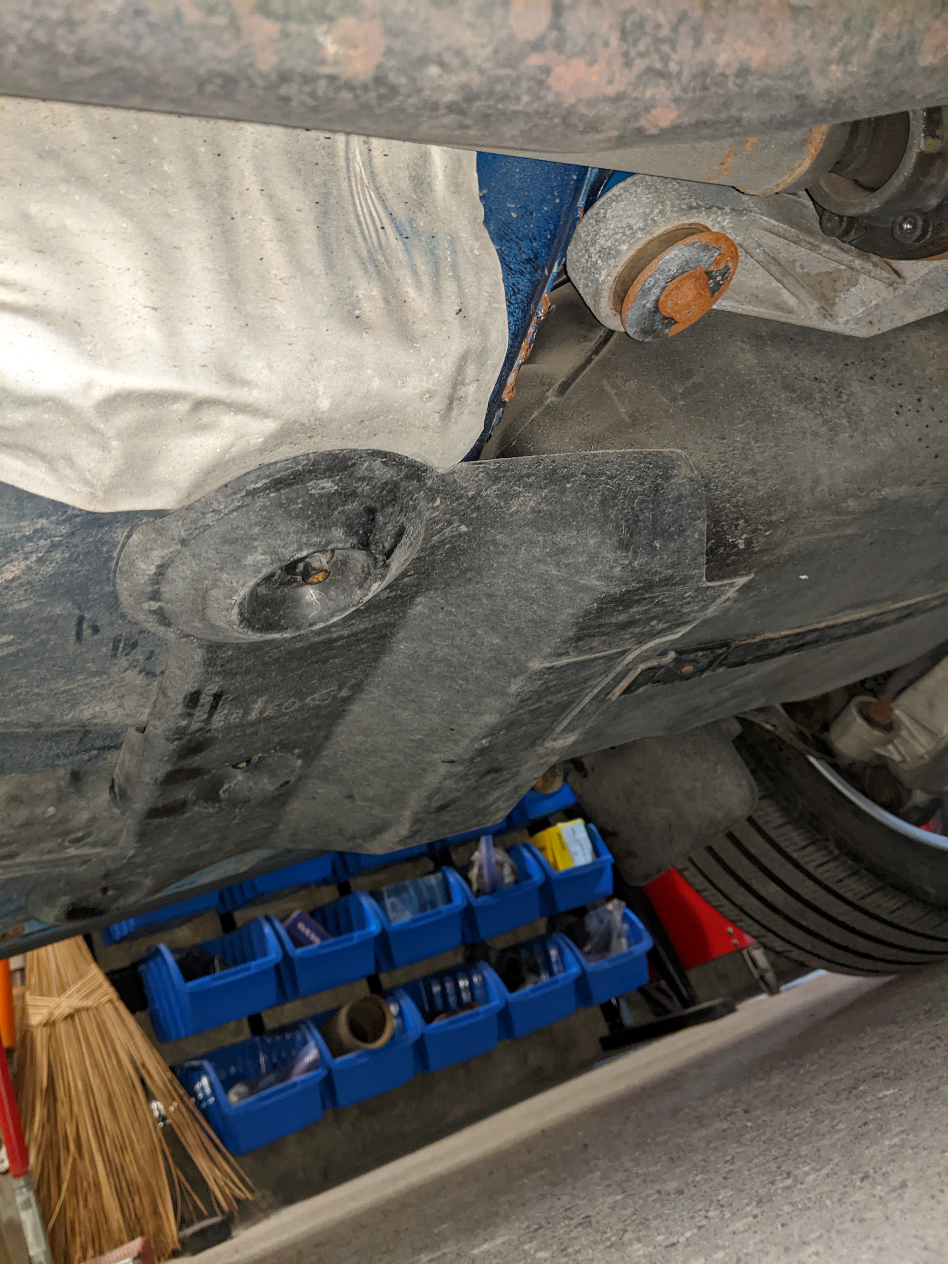

You ask and you shall receive! Fortunately the 'R' is tucked up in the warm garage and is nice and dry!
I do remember it is fiddly to fit as you have to make sure the rear edge fits in the fuel tank strap slot and in my case it only just reached. It should also just clear the parking brake cables on the side. They are held on with those plastic nuts like for the fender liners.
Hope this helps!

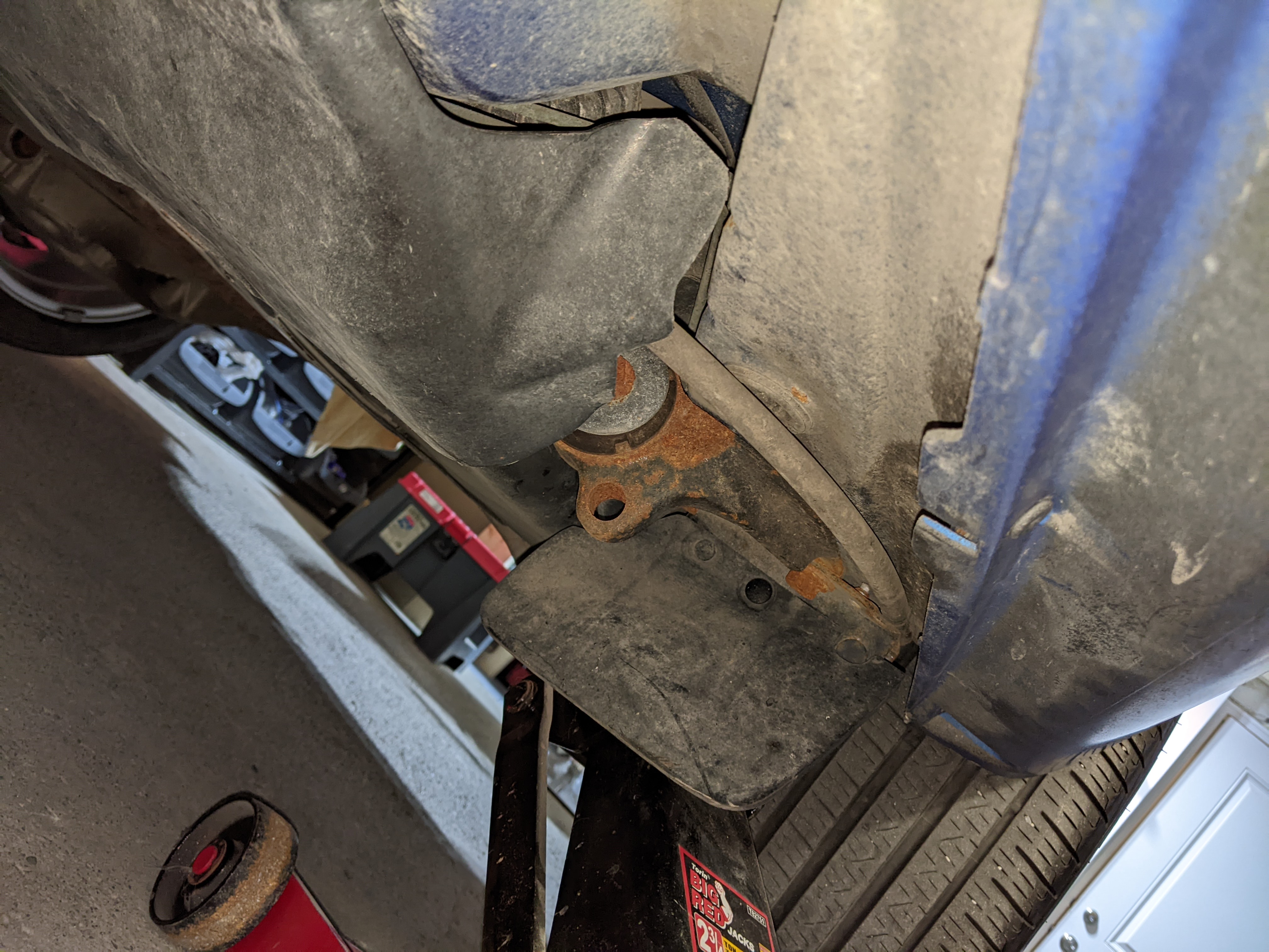

Update, I got these back on but didn’t like the condition of the hardware on the car, so some holes and zip ties were used. I’ll add pictures here. In short , a nice zip tie around the gas tank strap and one on the side picked up support around the brake cables.
