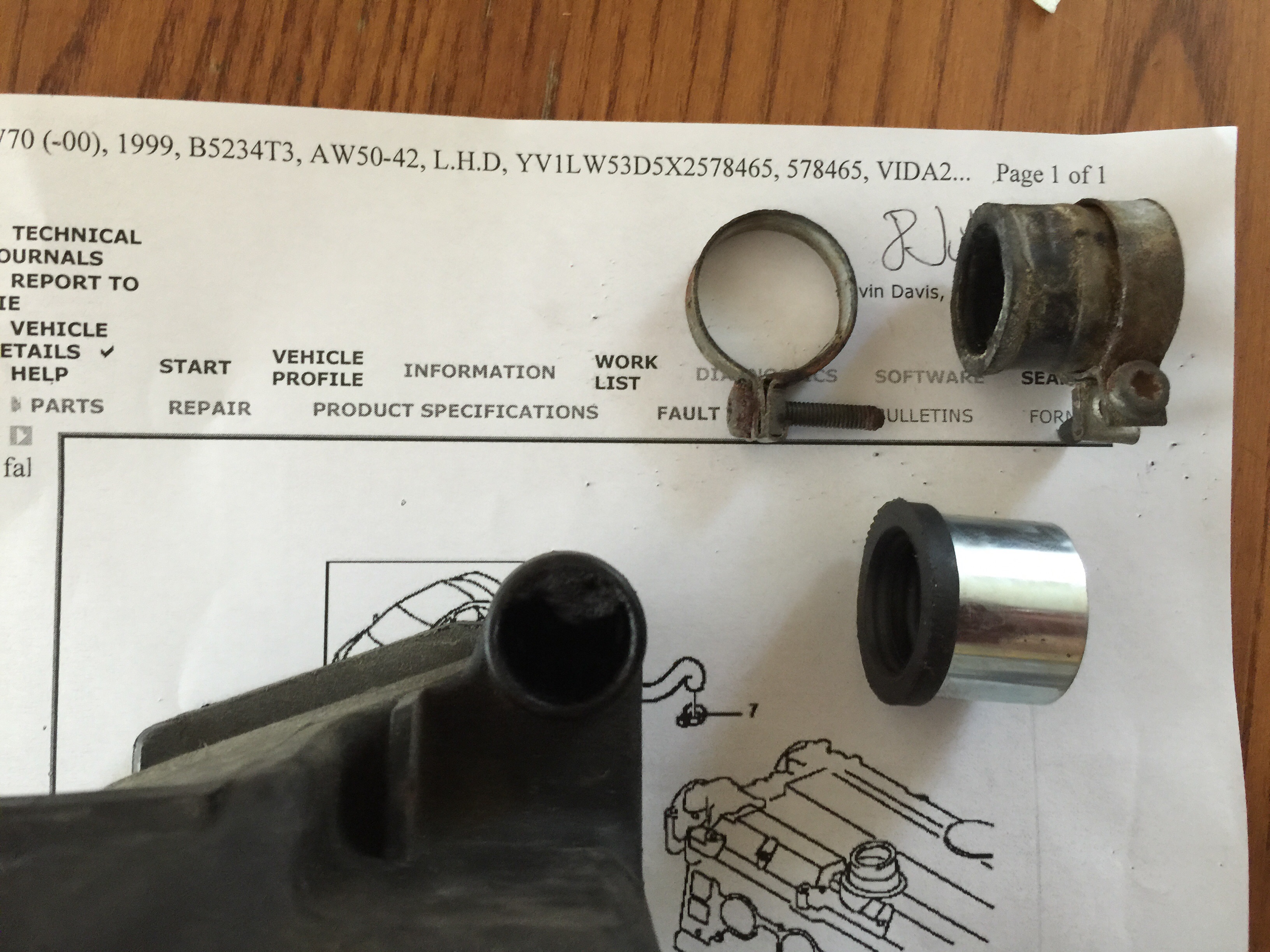

I am in the middle of this job and just found and interesting glitch
Instead of the push-on connector at the bottom of the flame trap/oil box, I had a connector hose with two Torx jubilee clamps (hose clamps)
Volvo dealer here in said that wasnt stock....except I bought this car at 20,000 miles in year 2000 and PCV has never been serviced. What are the chances someone replaced this? All the PCV are date coded 1998, so I think someone ran out of the right part in Sweden in late 1998.
A
Picture below. Correct shiny slip on drain with the actual drain that was on my car...
A

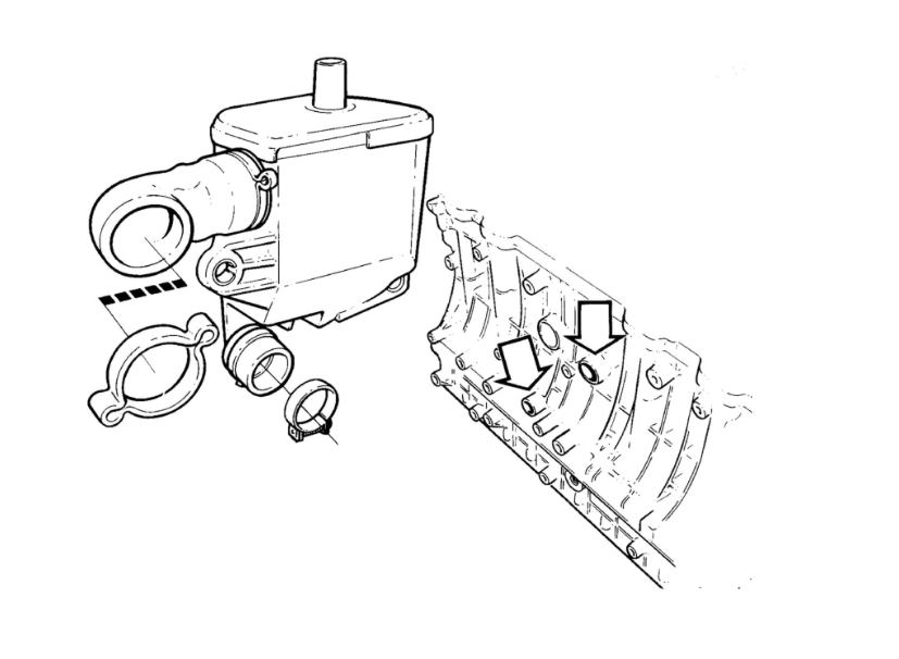

Follow up question - VIDA diagram shows the rubber boss side of the slip on connector touches the engine block. Counter-intuitive to me.
Can someone confirm?
The screen shot from Alldata confirms that early cars did use a hose with two hose clamps rather than the slip attachment.

I found the same when doing the PCV on my 99. I'd bought the kit from FCP and it had the same mystery fitting. Can't remember if I ended up using it or not - I know no shiny metal came out, but some shiny metal might have gone in.

I installed it with rubber side to the engine. Not positive that was right, but it just seemed to fit better that way considering the taper of the nipple on the block. It does take some reasonable force to seat the box all the way as far as it will go before installing the bolts.abscate wrote:Follow up question - VIDA diagram shows the rubber boss side of the slip on connector touches the engine block. Counter-intuitive to me.

A quick shot of silicone spray makes it a lot easier to push that fitting on. Of course, one could use oil too.

Cn90 write up shows the rubber side of the lowest connector against the oil box. That's how I did it too.

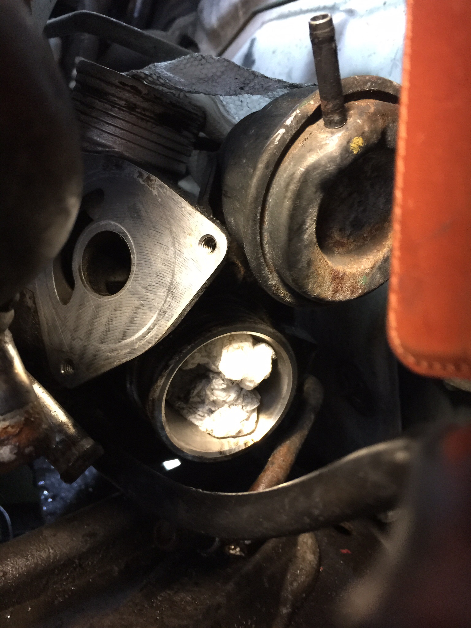

The ETM on turbos sits under the manifold on turbos and this job is tough. I found the only way to get the banjo bolt (vacuum supply to manifold, as well as mechanical fitting for coolant) is to do so with the oil box connector off and then use the socket trick to install it after the manifold is on.

I've got a spare ETM gasket I can mail. Mine was so clean I didn't even remove it.
Also close up of CBV valve with cover removed
