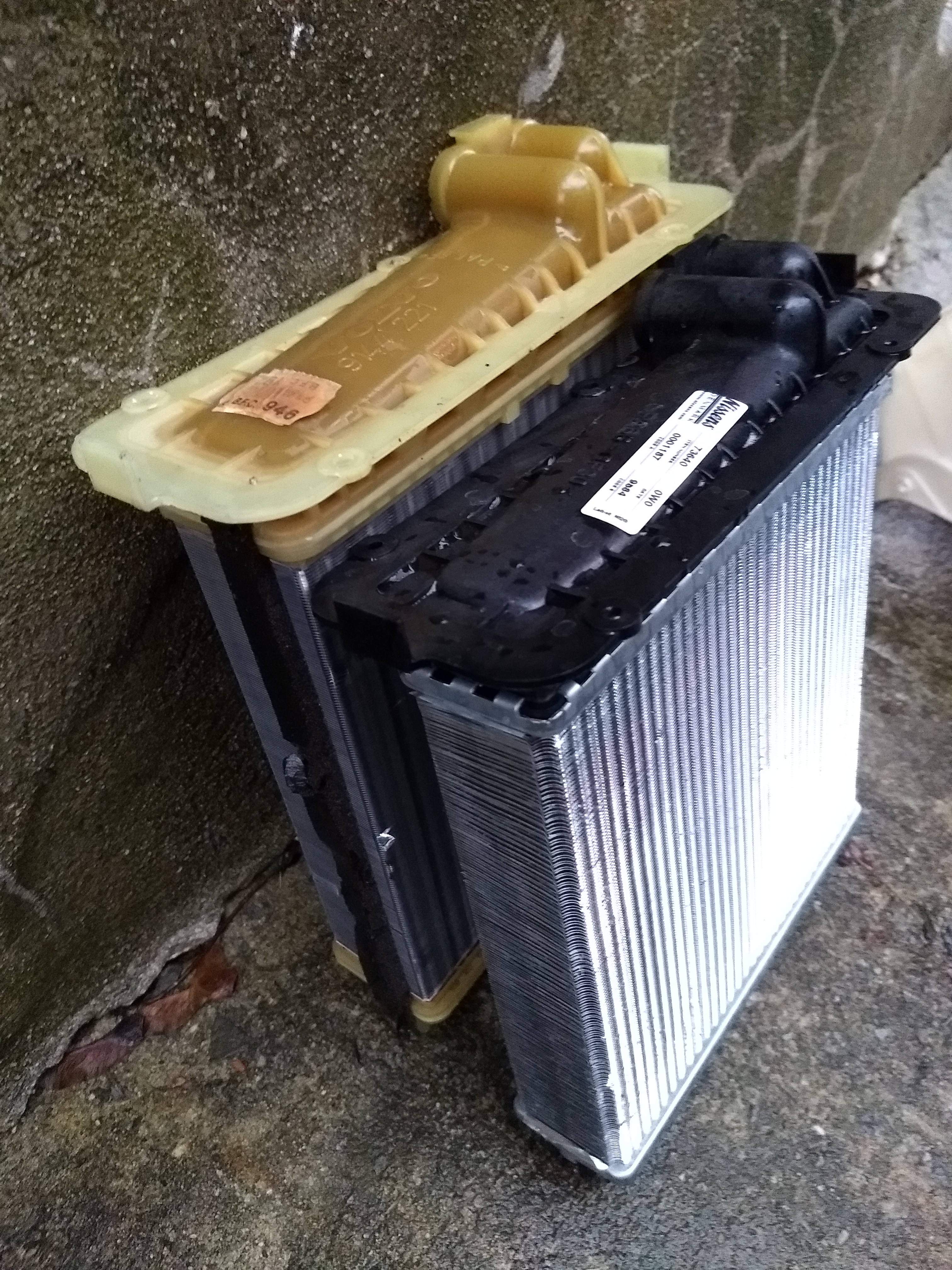

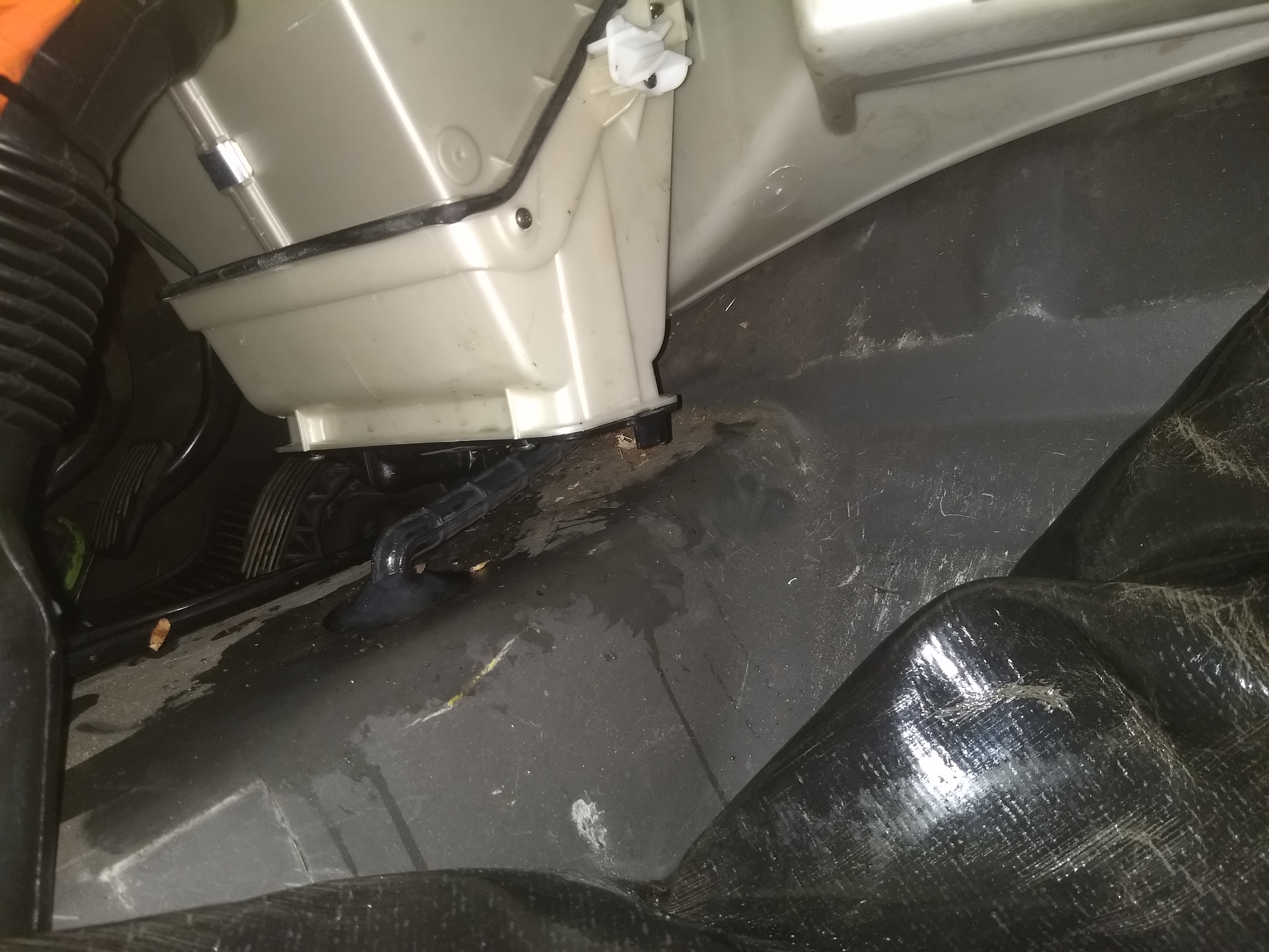

Sick of smelling coolant whenever turning on the heat in the '00 V70 and encouraged by last week's somewhat successful similar repair of the '98 V70, I replaced the Volvo heater core with a Nissens.
The MT shift cables made the space a bit more cramped, but most everything went smoothly. I even managed to catch most of the new Pentosin blue coolant in a clean trash bag. The rubber drain hose was intact, unlike my other one, and it helped to unplug it and tuck it aside. Taking out the passenger-side kick panel, glove box and short duct provided a decent amount of room to work.
After installation, I cut a hole in one end of the trash bag and put the coolant back in the overflow tank. Not all of it took, so I drove around, shifting and steering with one hand while holding a trash bag of coolant with the other — even managing to get my seatbelt on!
The Nissens heater core seemed well made. Like the Swedish Car Parts model, the metal component with the fins was clamped on to the plastic end pieces, not glued together like the original Volvo one. I'm curious to see if one gives out before the other.
Oh, and this time I washed the heater core with Dawn and hot water. When it heated up, there was a vague odor of dishwashing liquid. The Swedish one had a chemical smell my wife described as "toxic," so I might redo that one with an exterior wash.
