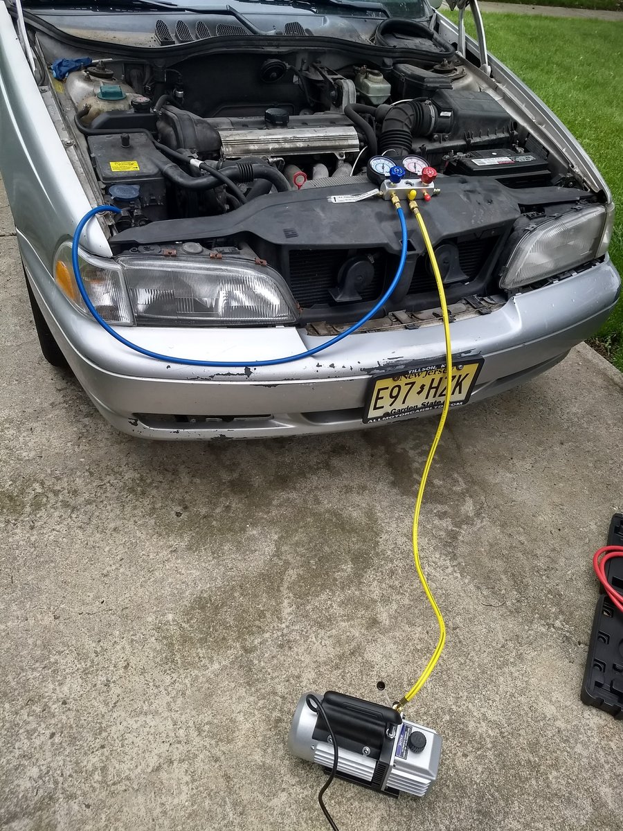

theWIFES_S70 wrote: 27 May 2018, 18:12 Pulled a vacuum on my brother's 2000 V70 air conditioner, got it down to 30 bar and after 40 mins it was at 29. (Good enough for me!) Readjusted his a/c clutch gap too. It was about .75 before being adjusted.
Car easily took in a can and a half of refrigerant and my brother had to shut the car off because it was too cold it there! Hahaha
We also sprayed down his receiver with some anti-rust spray paint. That thing looks like it's going to crumble into pieces... If I had to guess what he'll have to replace next, my bet would be on that. (That thing looks like a pain to replace!
That was fun! Thank you!
