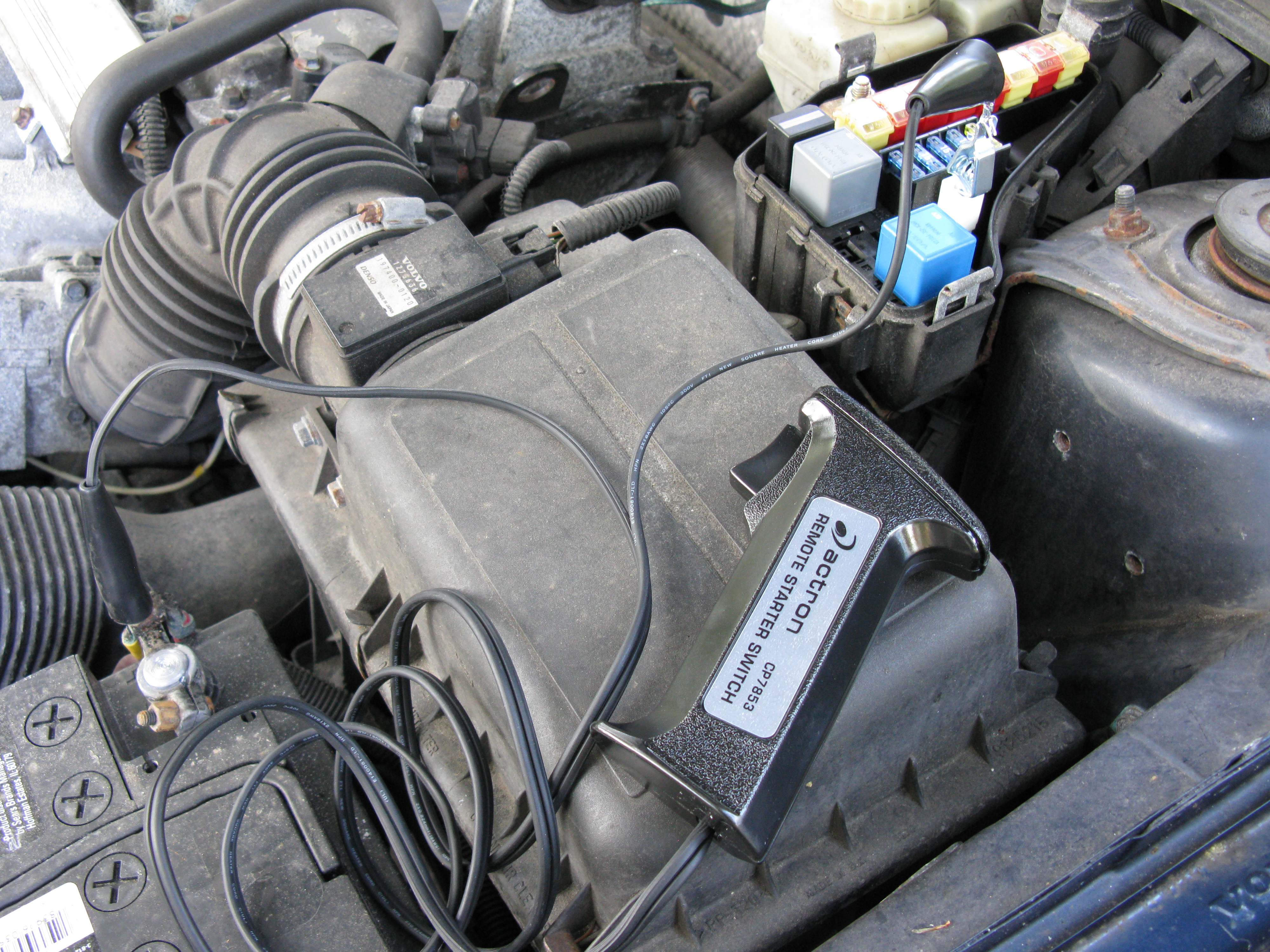

The best way to use this remote starter terminal is with a remote start switch. They should be available at your local auto parts store.
The Actron brand (really Bosch) switch I used has nice alligator clips, but they are so big that they barely fit inside the white terminal or on the starter's trigger terminal (with the red/green cable on it). Find a brand with small, long clips.
While diagnosing my car's failure to turn over, the remote starter didn't cause it to start. I think it was a fault of the car, not the starter.

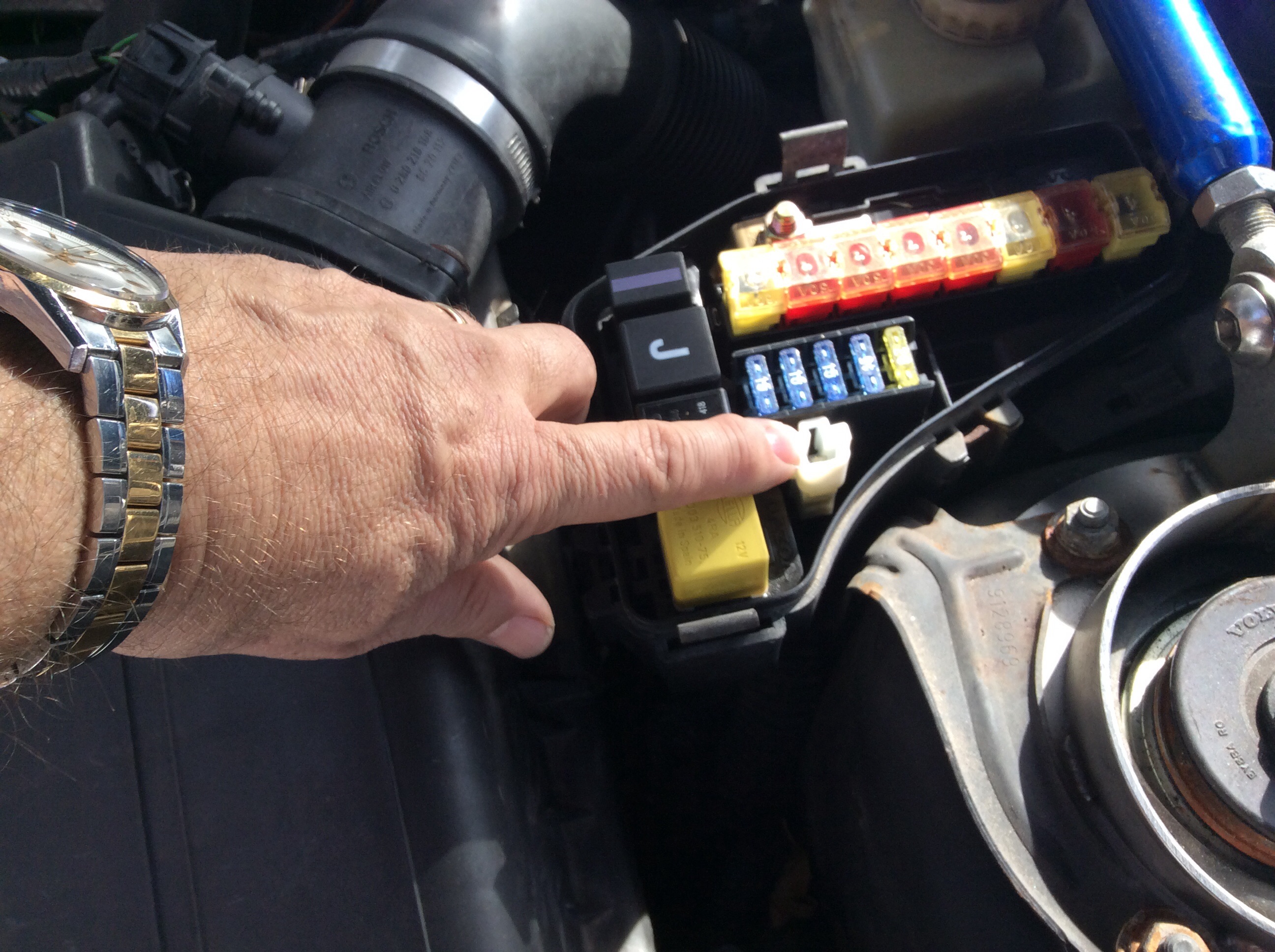

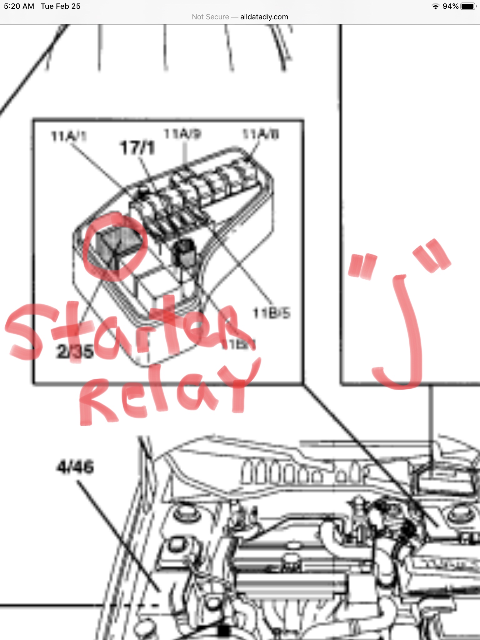

If the bypass works, check the "J" relay near Abscate's middle finger. I believe that is the starter relay (at least according to the weird print in the main fuse box)

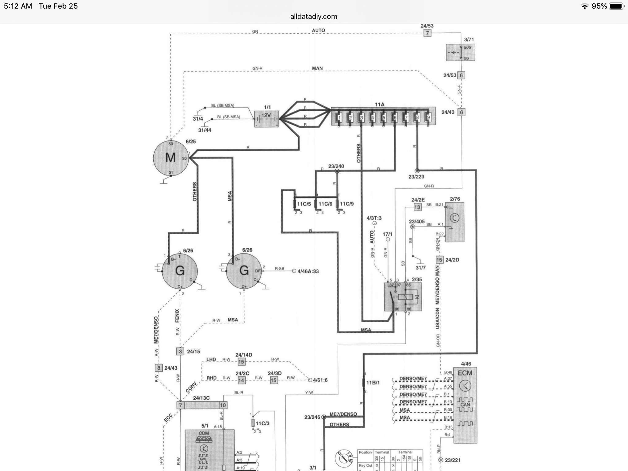

Follow up on this
The RED/GREEN starter bypass wire
It is red/green on all models
It lives under the fuse box cover with a white connector in 1998-1999-2000 models, not sure about earlier
It does not connect to starter directly, but to TERM 87 (load) on the Starter relay.
On automatic cars this does not bypass the PNP switch, so if you have a problem there it will be have to be jumped downstream on the green wire terminal of the pnp
