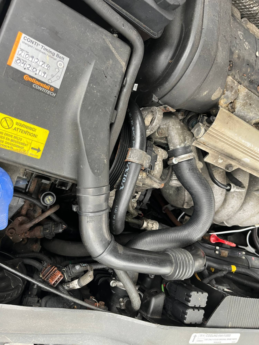

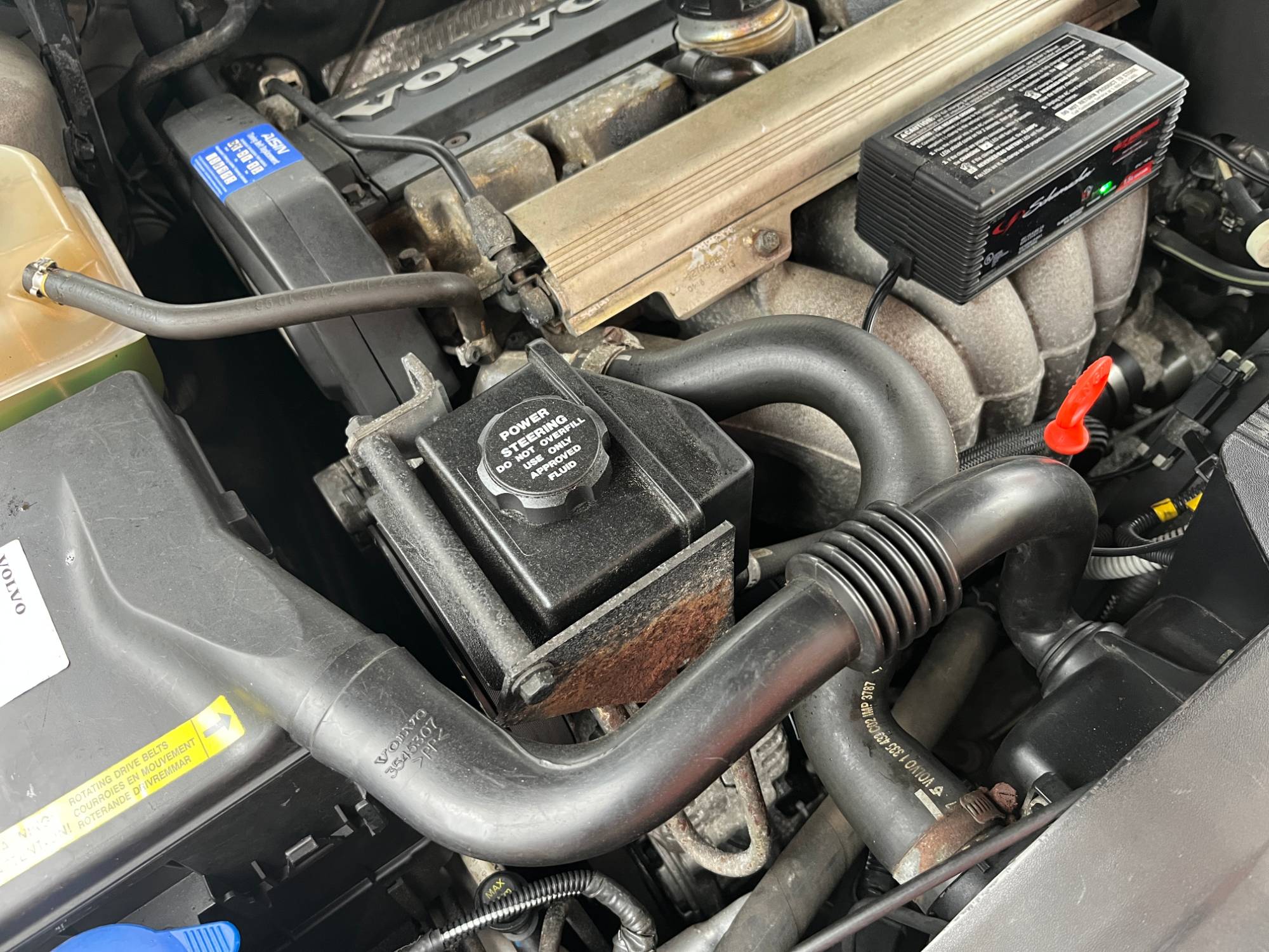

I THINK the '98 uses a hose from the expansion tank to the thermostat housing, nothing to the radiator, and the '99+ used a hose from the expansion tank to the top left (facing the engine bay) of the radiator.
You are correct. Because I was curious I just checked. I have a 98' and a 99' in the driveway, so it's easy to verify.
First photo is the 98', you can clearly see the hose going to the thermostat:
Then this is the 99', hose going to the dreaded nipple on the radiator:
