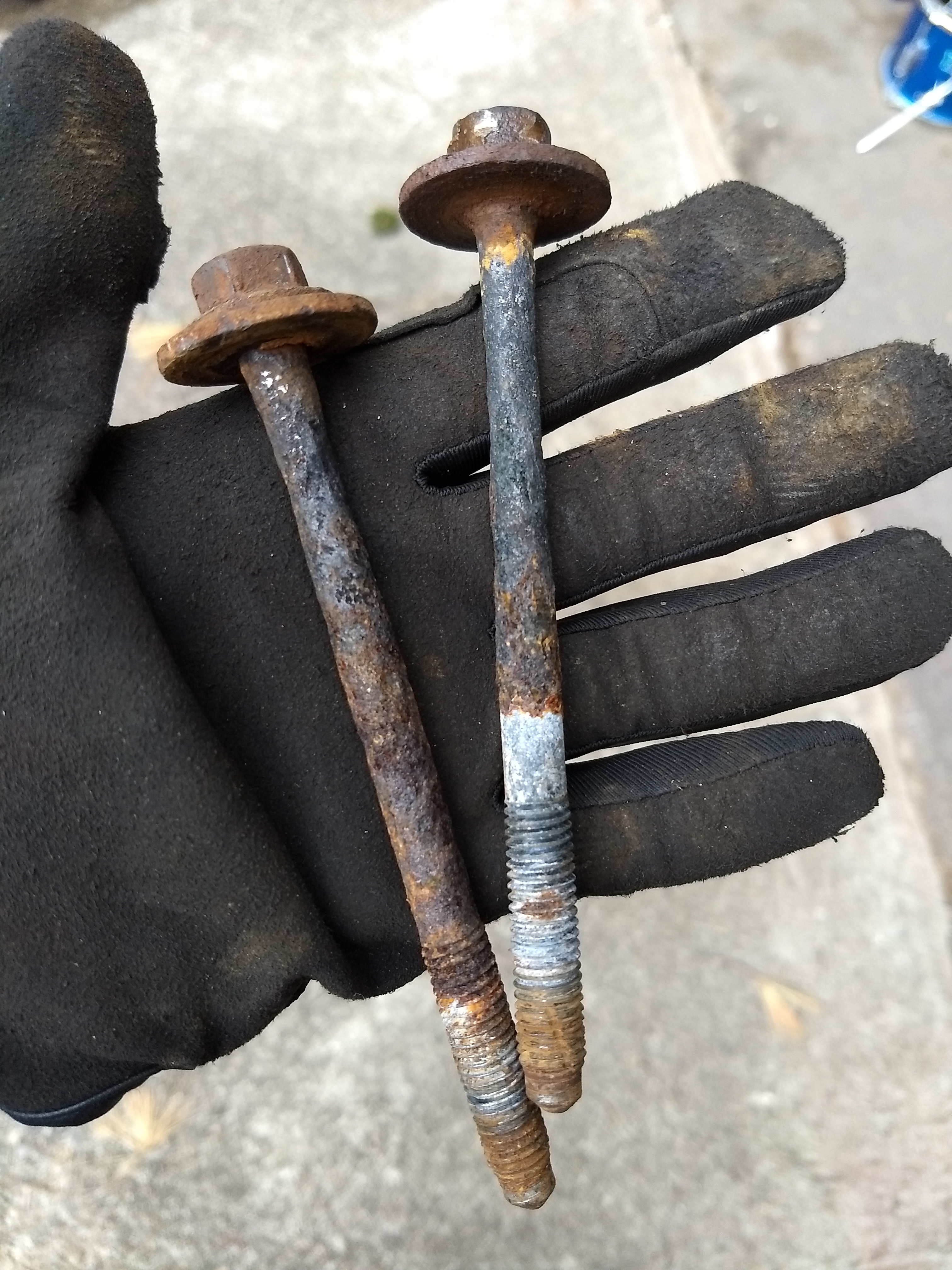

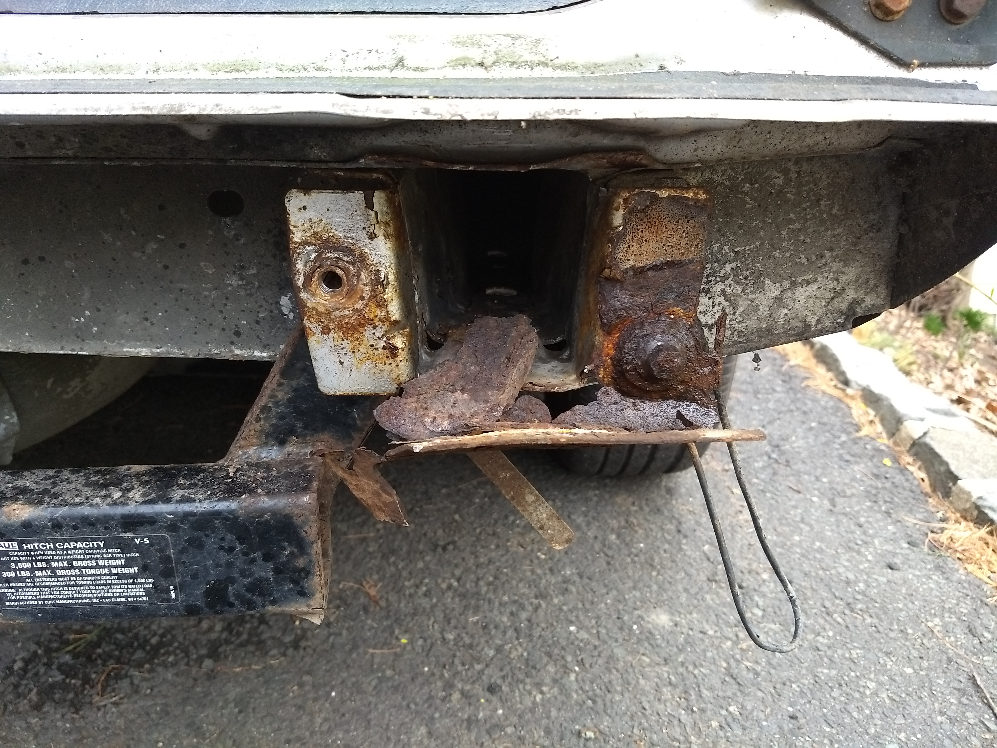

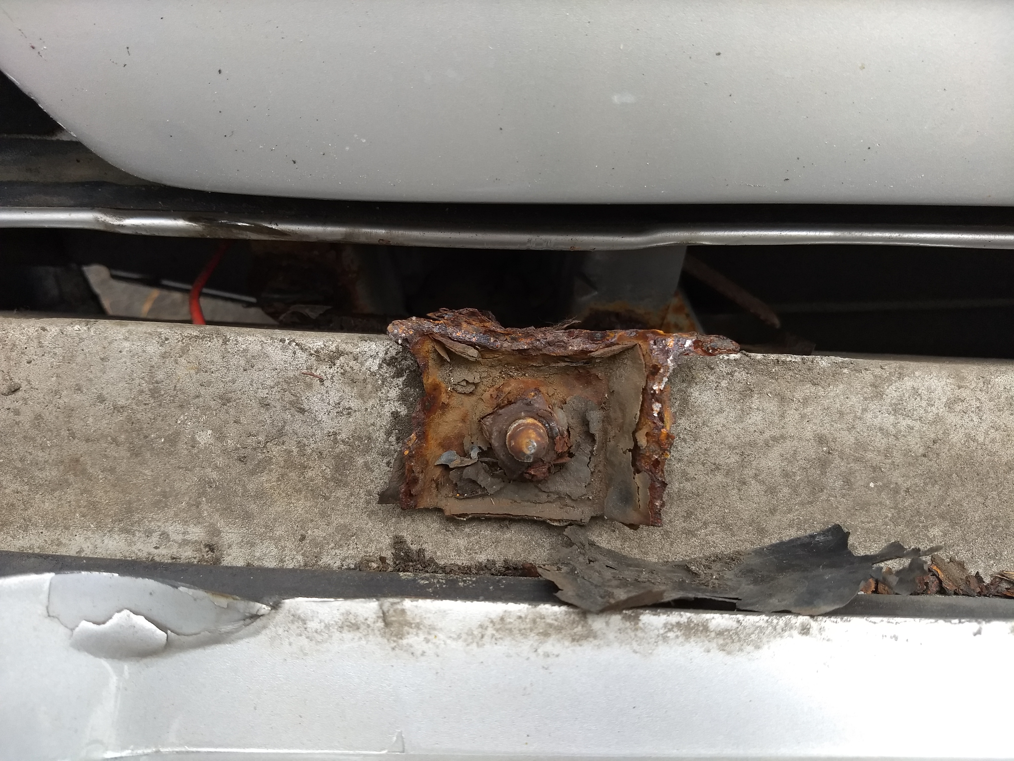

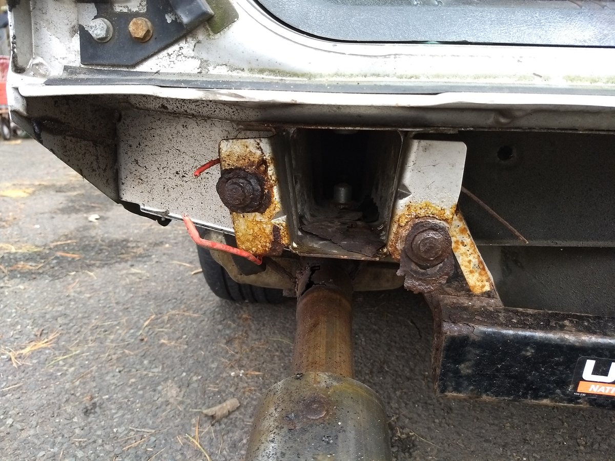

Took off the sagging rear bumper to replace the mounting brackets and found a whole lot of rust. The left side was held on by red electrical wire, as the existing bracket had completely rusted in half. The right side used black electrical wire that was done so neatly that I thought it was part of the original design.
Removing the bolts was mostly unsuccessful so far. Only one bolt came out. The grinder took off the head of another, and the other two have pilot holes for a bolt extractor. Had to go to work, so I'm driving around with 7/8ths of a vehicle.

Wow, that's bad! We were just having this conversation on the BMW forum about rust. That's one of the good things about not living in Jersey anymore... we don't have that kind of rust down here in NC!

Get some heat on those suckers until they are screaming cherry red, then burp them off with an impact...bbbrrrrrppppp.
