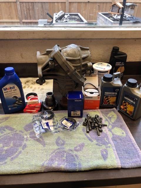

Volvo sells the Collar Sleeve separately and also sells a service kit with the Sleeve and the axle seal (inside the sleeve) plus the transmission housing seal. I'd also recommend replacing the other axle seal on the angle gear at this time.
New Collar PArts.jpg (48.88 KiB) Viewed 2028 times

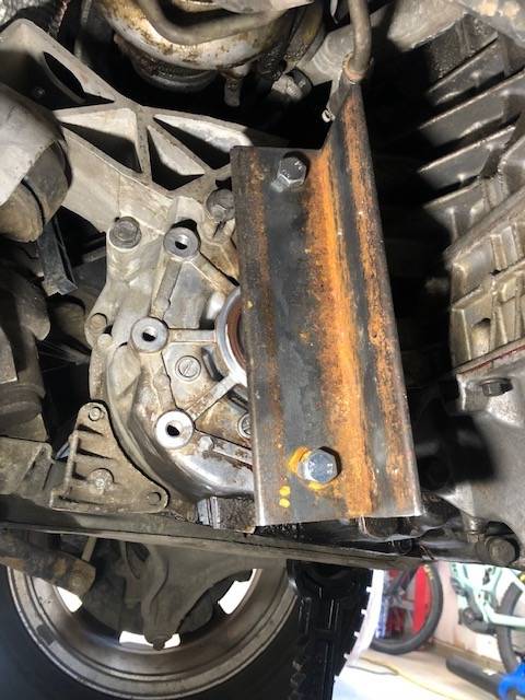

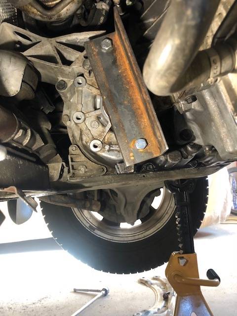

Remove the front lower bracket (12mm x 4) and use two of the bolts to hold the exhaust heat shield in the correct position as shown below:
Front bracket.jpg (75.22 KiB) Viewed 2028 times

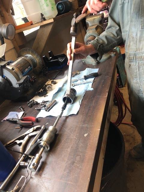

My proprietary tried and true method came next, namely cutting two small grooves in the collar with a 4 inch angle grinder 180 degrees apart and using these primitive tools: A masonary chisel and a 14oz ball pein hammer!
Collar removal tools.jpg (44.51 KiB) Viewed 2028 times
I've used this method on many stubborn sleeves and find it to be the quickest and most effective. the photo below shows the approximate angle to strike the sleeve. I give it a half dozen hits on one groove, then rotate it and give it 6 more hits on the other side. The sleeve will be off in 5 minutes of this being repeated several times.
Collar Groove.jpg (105.14 KiB) Viewed 1916 times

Install the new Collar Sleeve: The service kit has Volvo's hygroscopic grease in a tube to be applied to the splines. Make sure everything is super clean and put lots of transmission fluid on the seal and collar also. Offer up the collar to the splines and gently tap the collar with a plastic hammer. I've seen videos of people that hammer the sleeve all the way on, also people that get it on part of the way and then use the angle gear to press it in using the AG attaching bolts. From an automotive fundamentals perspective; both of these techniques are wrong. I built a simple press out of sturdy L Iron to press the Collar Sleeve in. If you've not done this job before there is small interference fit on the splines on the transmission, not so on the angle gear input shaft splines. The sleeve needs to be installed such that it protrudes 41mm proud of the seal bore.......this number is important!
Collar sleeve press.jpg (56.46 KiB) Viewed 2028 times
