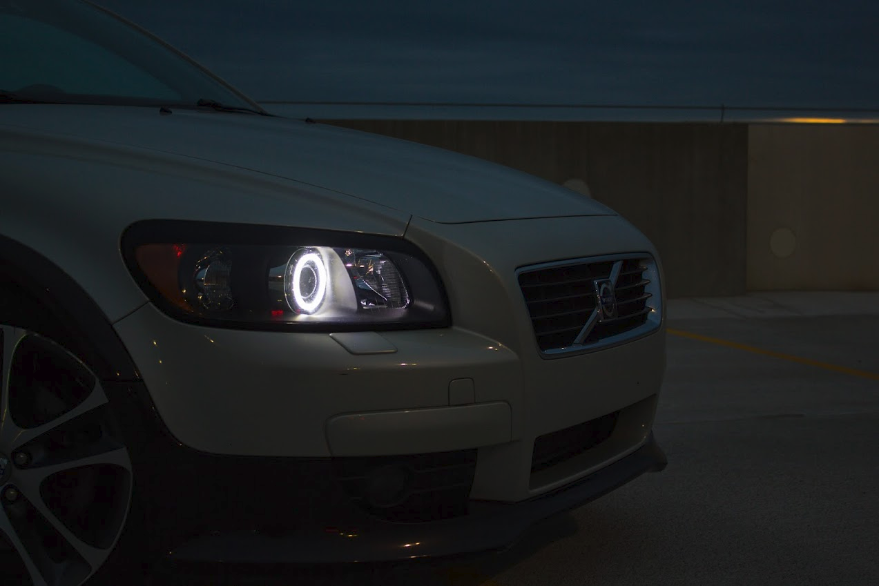

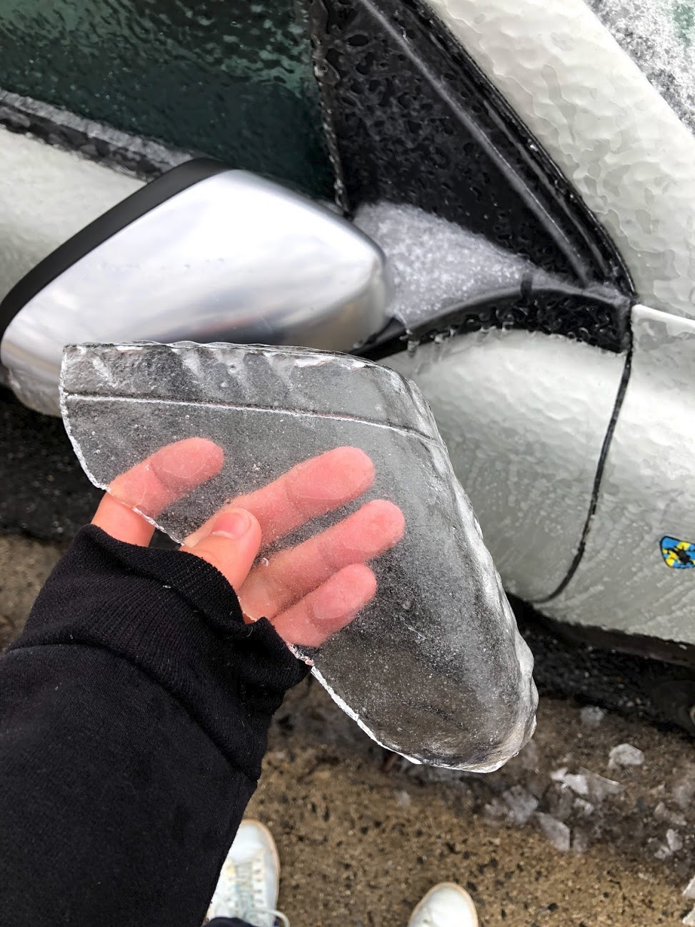

We used Avalon King on the glass, front, side and back. Head and tail lights so basically the entire car except rims. Wash about 3 times a year then spray on Tech Choice (thanks Pete) after a quick wipe to remove the large droplets of beading water. The Tech Choice just wick away the remaining water so no hard drying but rather the towel feels slick across the paint. Absolutely no streaks!
The headlights have very deep pitting so we didn't sand it smooth but the ceramic coat gave it clarity and sparkle after polishing with sand paper up to 5000 grit. We should have ceramic coated the inside of the lens when installing the Halo's.
The ice also came off the windshield in one sheet as with the bumpers with light tapping.
