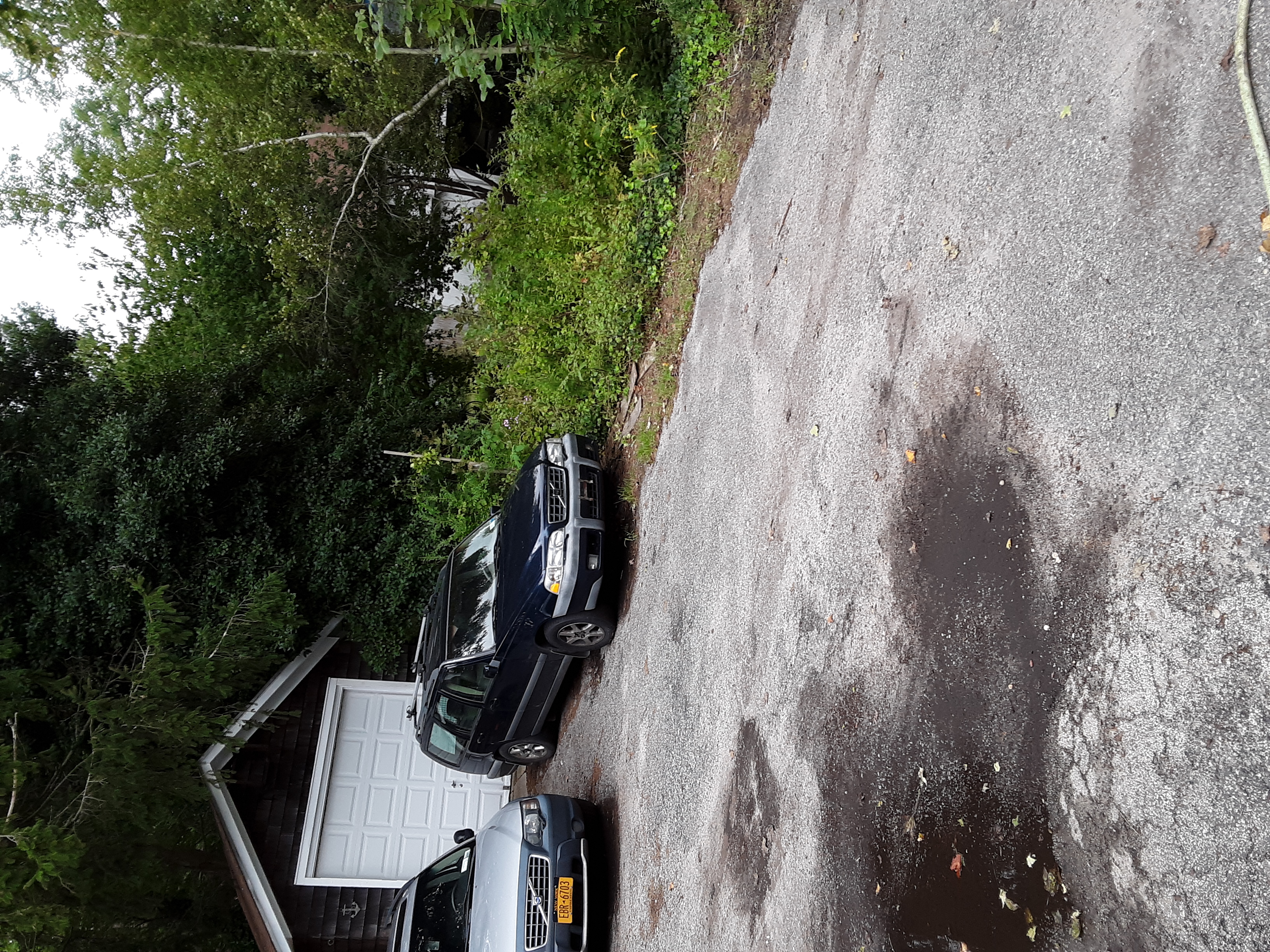

Best fix for glazed over plastic headlight lens is set of glass lens. My 2004 XC70 has glass lens with bi-xenon low/high beam and separate day running beam.
I believe it can be seen here sitting next to my 1998 V70XC.
