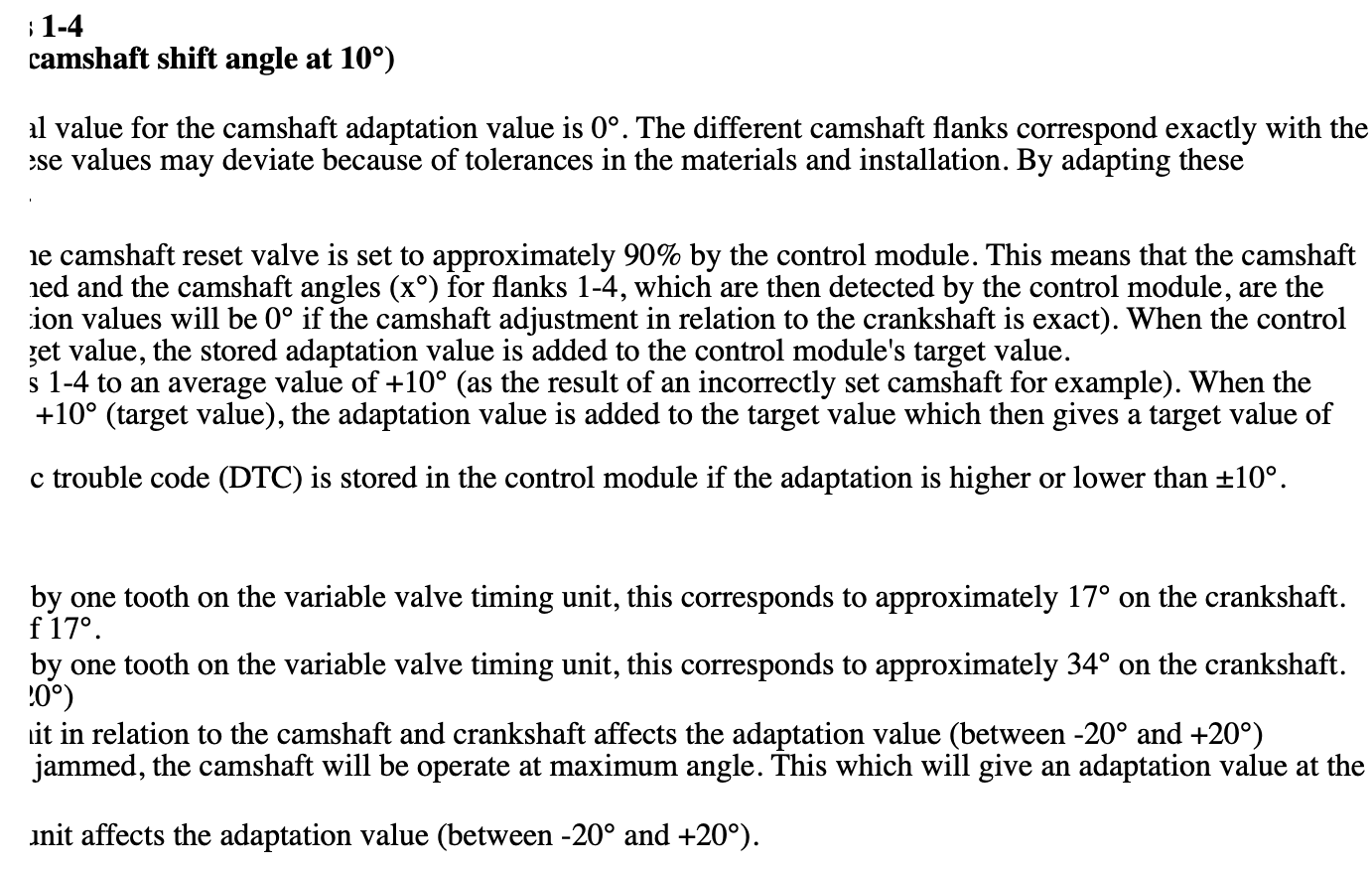

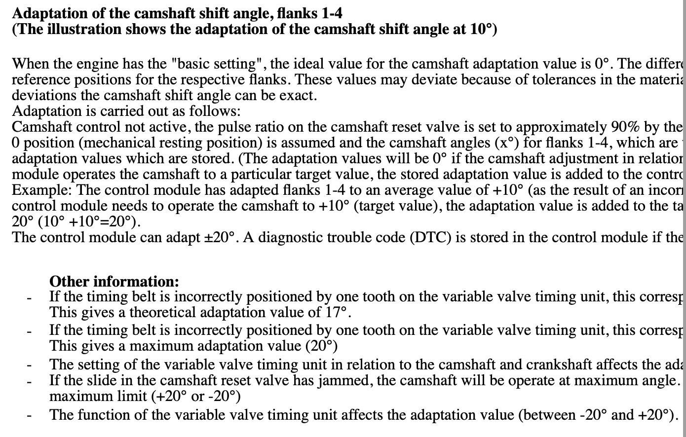

I have been fighting this code for a week now, and found this reference (the most annoying ad laden website I have ever seen , by the way) on how cam flank angle works and is reported
The ECM 644A Code is misleading - it has a "Cam overadvanced text' but in fact is reported for any flank angle larger than +-10 degrees, so its basically a cam in bad place message.

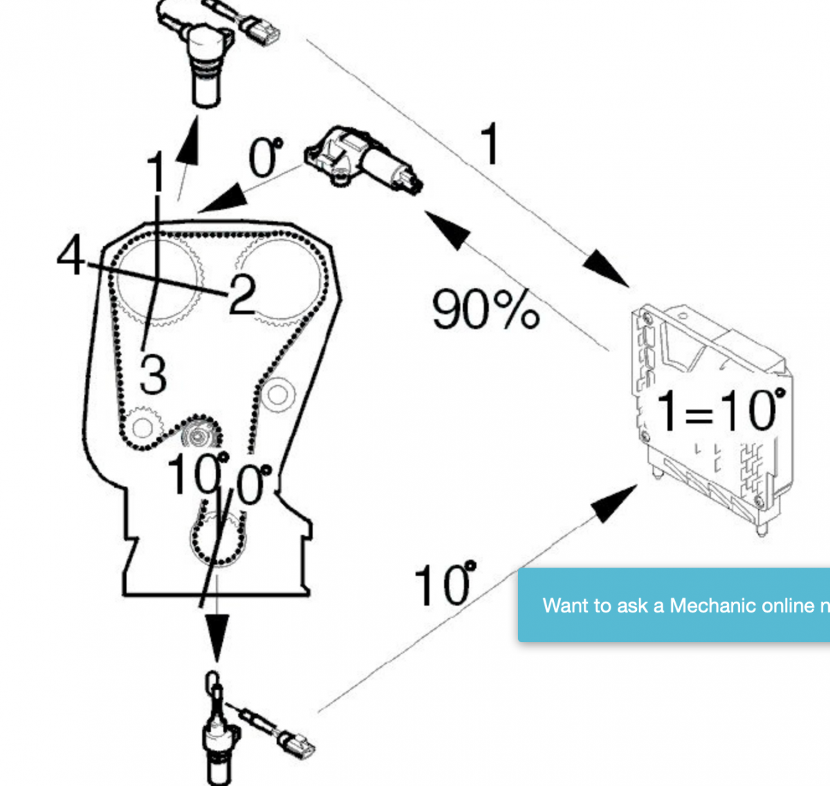

Here are some pictures and text of how this works.
There are some logical inconsistencies in this document I am still working through.
Note the two sentences where the same error gives rise to two different cam offset values - I suspect the second sentence was supposed to read" 2 teeth error"
I just got my cam flanks to read below the -20 crank degree limit, for the first time, so Im hoping I can figure out which way they are off and get it right today.
An error of more than 10 crank degrees trips the ECM code (about one tooth) and two teeth will max out the cam flank at +_20 and also trip the code. the ECM code disables the cam solenoid.
The code will not trip the CEL until the car is restarted but it will pend and disable ECM

(1) First the definition
FLank angle is the number of CRANK degrees the CRANKSHAFT is off from the timing mark when the cam is in its reference position
(2) The Math - cam sprockets have 42 teeth, so 8.6 degrees per teeth. The CRANK rotates at 2x CAM speed, so 8.6 cam degrees is 17.2 CRANK degrees per cam tooth.
IF the Flank Angle is positive, the Crankshaft reaches the mark before CAM reference mark, so the cam sprocket needs to be moved clockwise to retard the CAM
If the Flank Angle is negative, the Crankshaft reaches he mark after the CAM reference mark, so the cam sprocket needs to be moved counterclockwise to advance the CAM
Example - I recently timed my 1999 T5 with exhaust VVT to the marks, set after advancing past and return to the marks.
I then got Cam flanks of about -16 degrees. I removed the timing belt and set the exhaust belt one tooth ccw from mark.
I then meaured flanks angles of 1-2 degrees.
The range of adjustment is +- 20 degrees total
The ECM 644A (P0014) error code is set if the flank angle exceeds +- 10 degrees.
