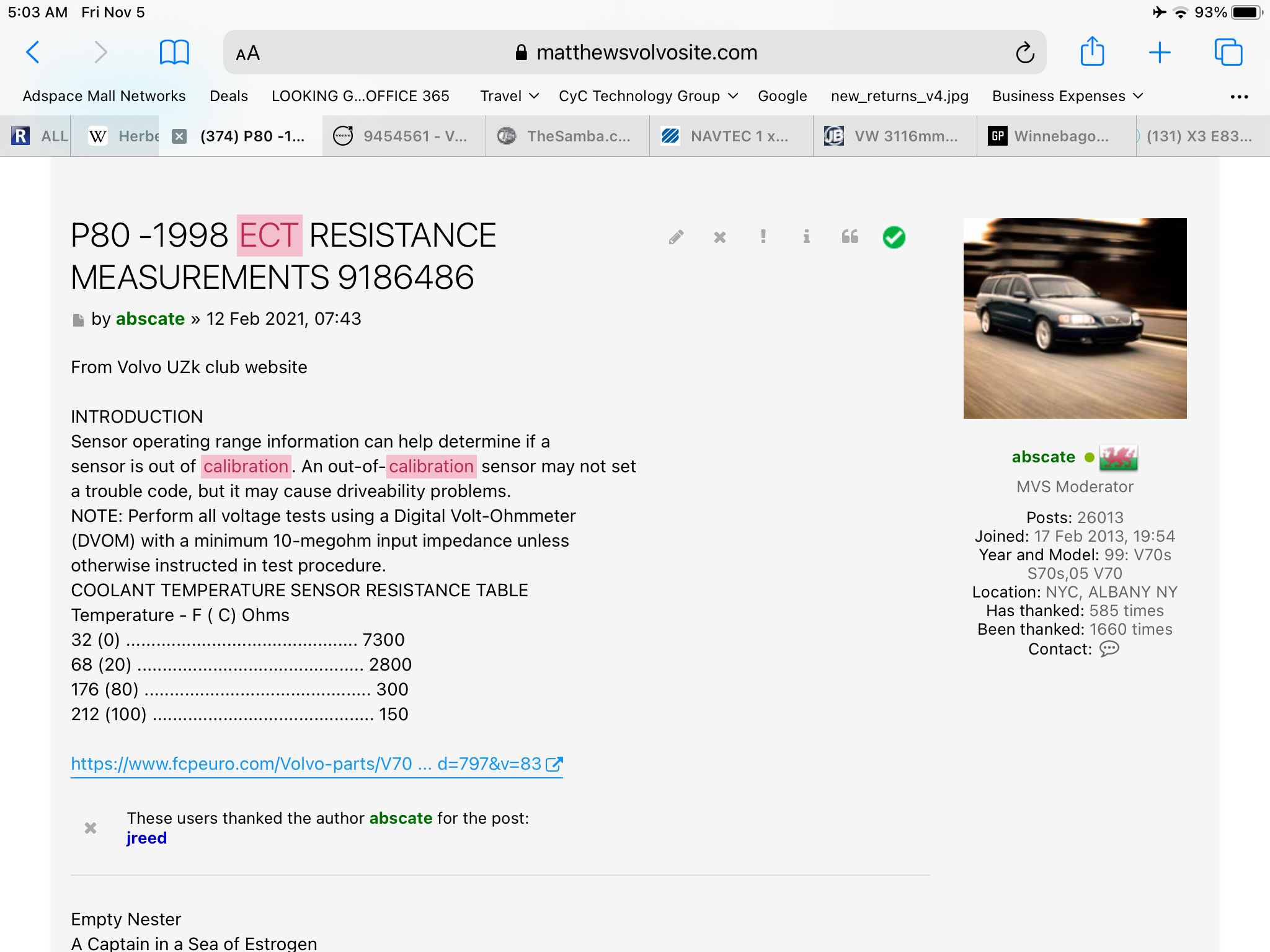

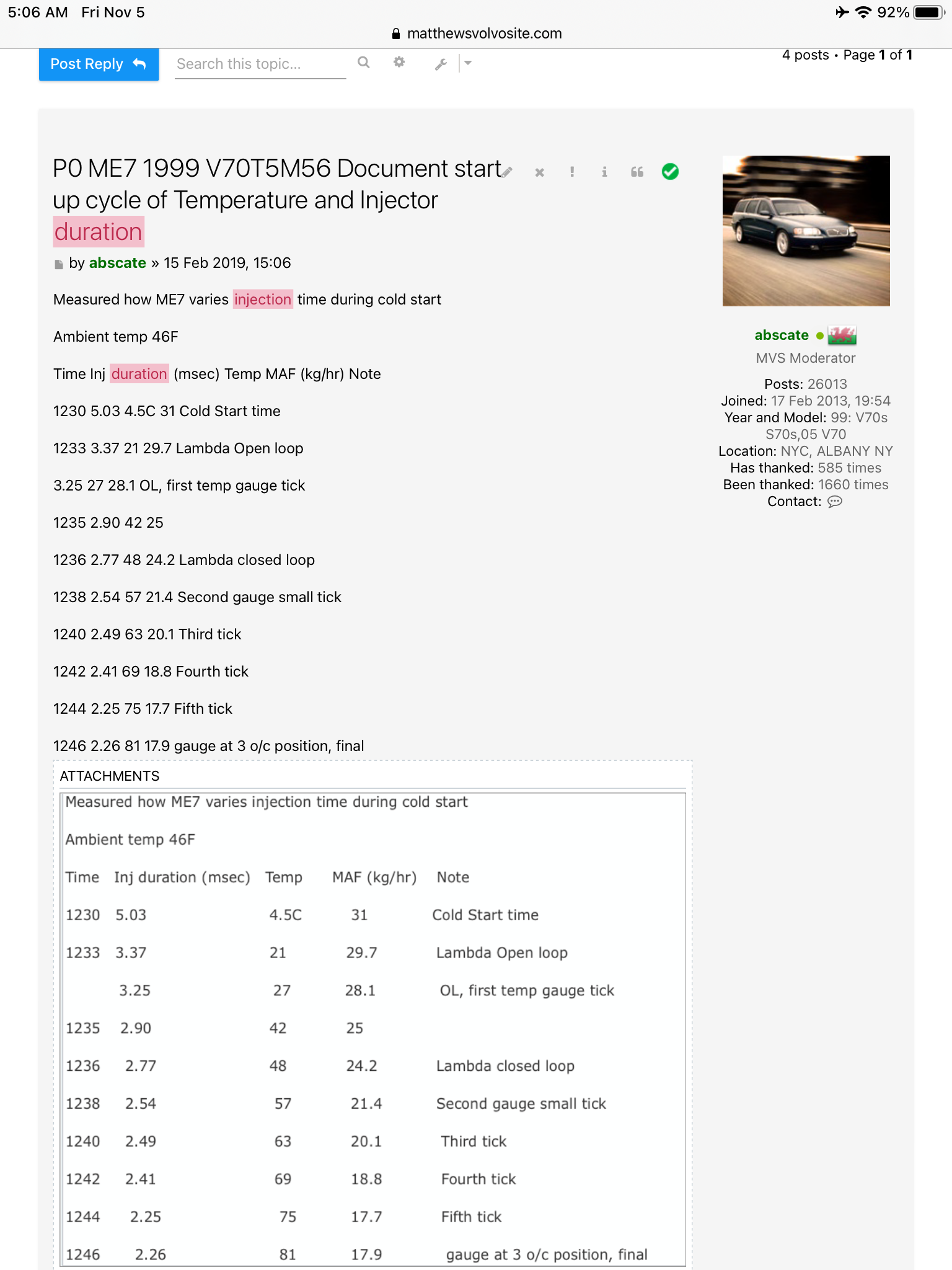

You can’t use the temperature gauge as a test for the coolant sensor. It’s a very coarse measurement tool, I think I documented it here somewhere. The ECU has to precisely meter the fuel according to engine temperature, injecting 3-5x more fuel when cold than when hot.
Make those resistance measurements in ice water and hot tap water!
Grabbed screen shots , you can use titles to search fir more info

Hello mate,
You say make the restistance measurements in ice water and hot tap water, are you saying to disconnect the sensor from the thermostat? Do I check the resistance at the plug or on the sensor itself?
Cheers,
Jacob

For these measurements you remove the sensor and bring it into the kitchen. Be careful unhooking the connector, it is notoriously crumbly. You'll lose a little coolant unless you drain some out. Check R across the plug socket.
I like to use boiling water for the hot (100 ˚C) measurement. As the water cools you can check some intermediate temps too if you have a thermometer nearby.
