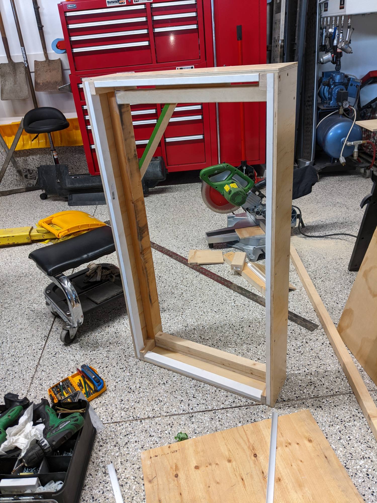

Support frame
Support frame
This is the starting point. Building the main support frame.

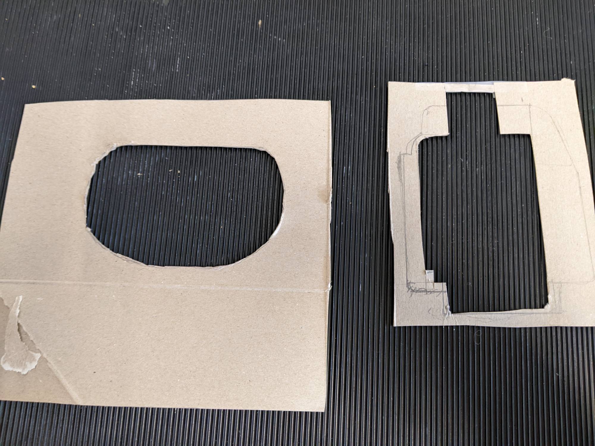

Naturally none of the speakers is made to make it easy for this purpose. All the speakers have their own challenges to flat mounting depending on where in the car they are. I did not want to cut them up to make it easier as they may be needed one day!
These are 2 (not particularly well cut out templates) for the rear speakers giving some idea of the challenge to mount them to a flat panel.
2 templates for rear speakers

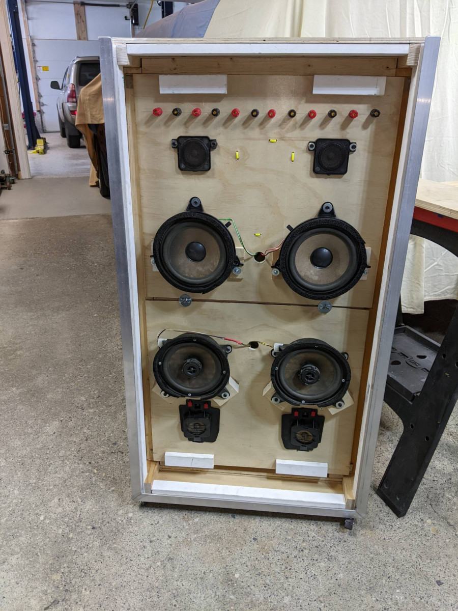

Final picture is of the mostly completed box:
Box mostly completed
This is before the holes and mounts for the speakers were made. I will add some more pictures later. I have now mounted the speakers and removed them again for wiring the box. The box has a sliding cover for storage and beefy aluminum angle irons for protecting most of the top and bottom (and yes there is only one of the speaker flaps mounted in the picture!!) :o :lol:

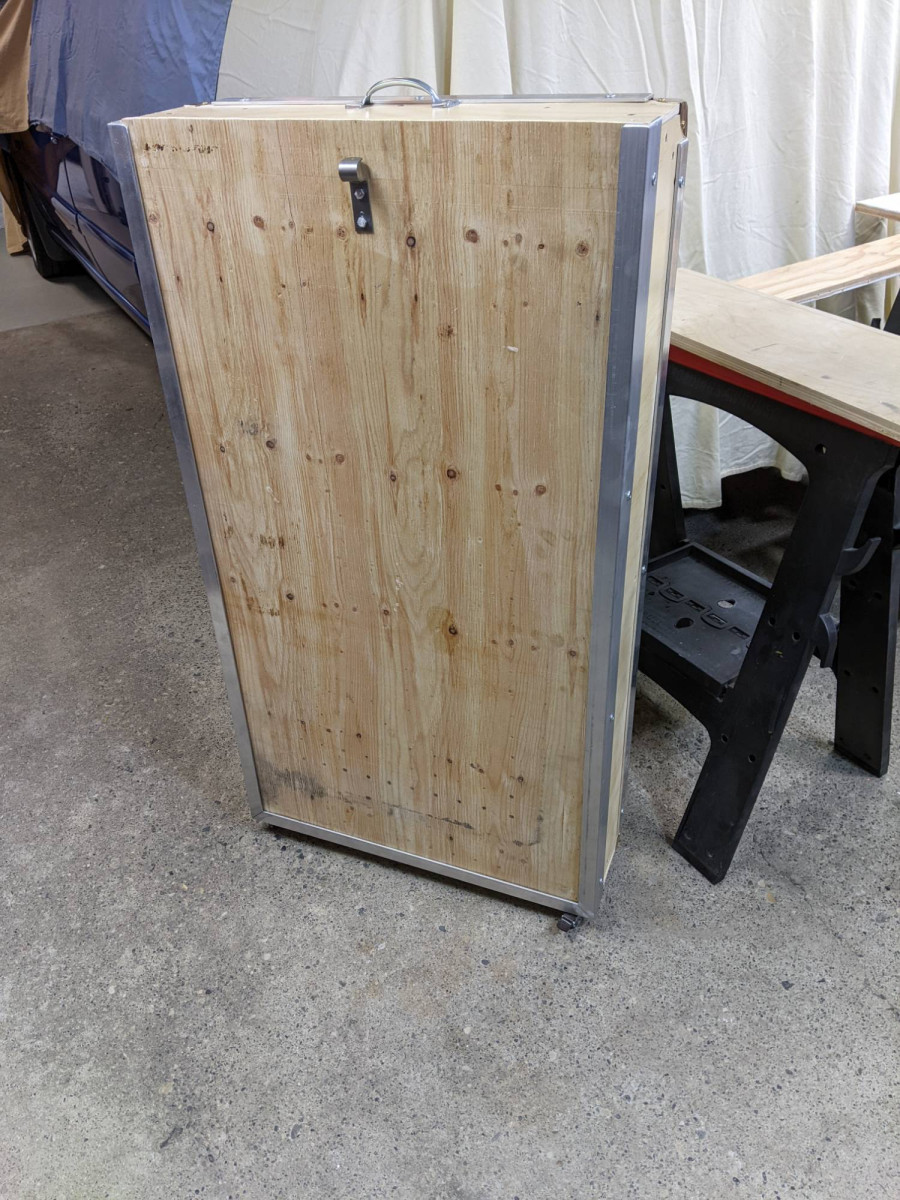

This is the speaker system box completed

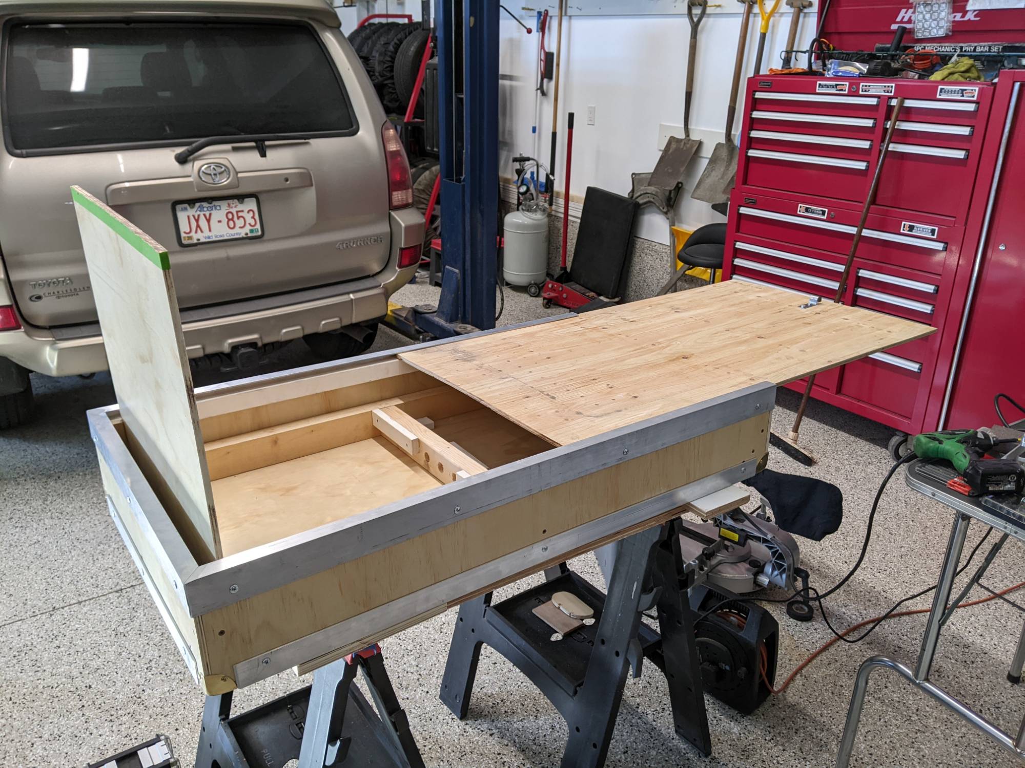

Storage cover in place
This has been an interesting challenge and although frustrating at times, I can now at least test all the head units on my workbench and clear them out of the way to get workspace again!
