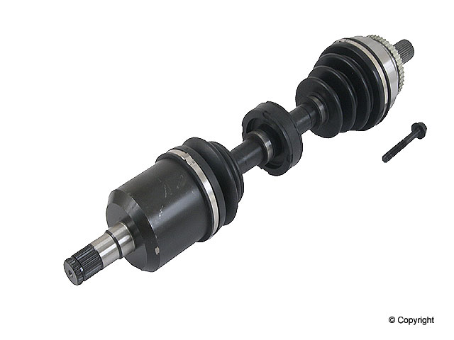

Is this photo the axle you're talking about?
Not sure what you're asking for. Are you getting your drive shaft rebuilt?

Post by adam180 »
That's it what it called at the end the closest end in you image.
