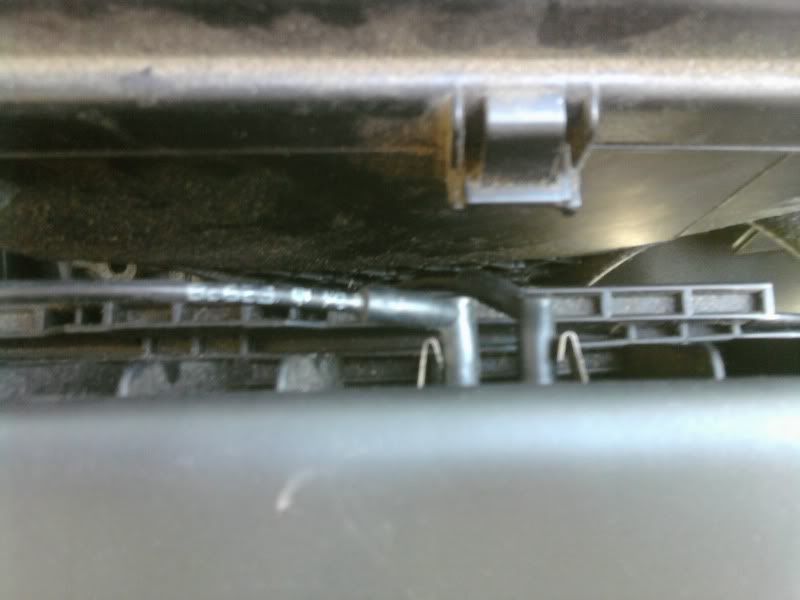

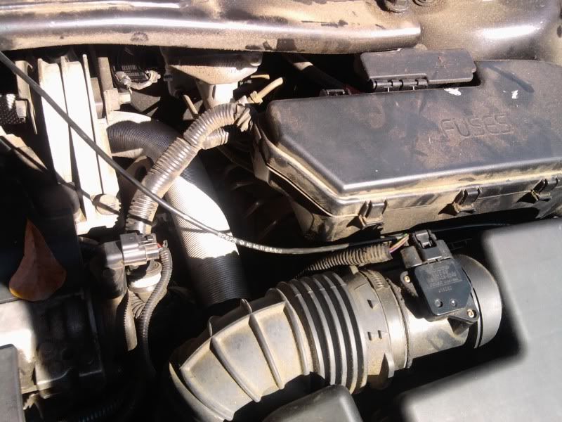

Thanks for the reply. Mines doesn't have the turbo. Here are some pictures--
The hose running out between the breather and the fuse block but it isn't connected to anything.
This is where it is connected to the breather (right between the breather and fuse block). It's the hose on the left that isn't connected to anything.

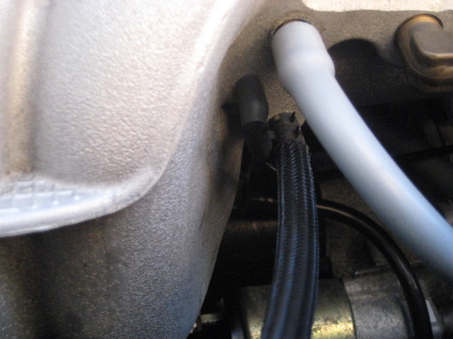

Thats the hose connected to the intake manifold (left one on my pic).
- IMG_0716.JPG (113.16 KiB) Viewed 1575 times

Thanks for the info and picture! The hose came out of the rubber boot at some point. That's why I couldn't find it. The boot was still hooked to the port and I was looking for something much smaller to plug that hose into.
