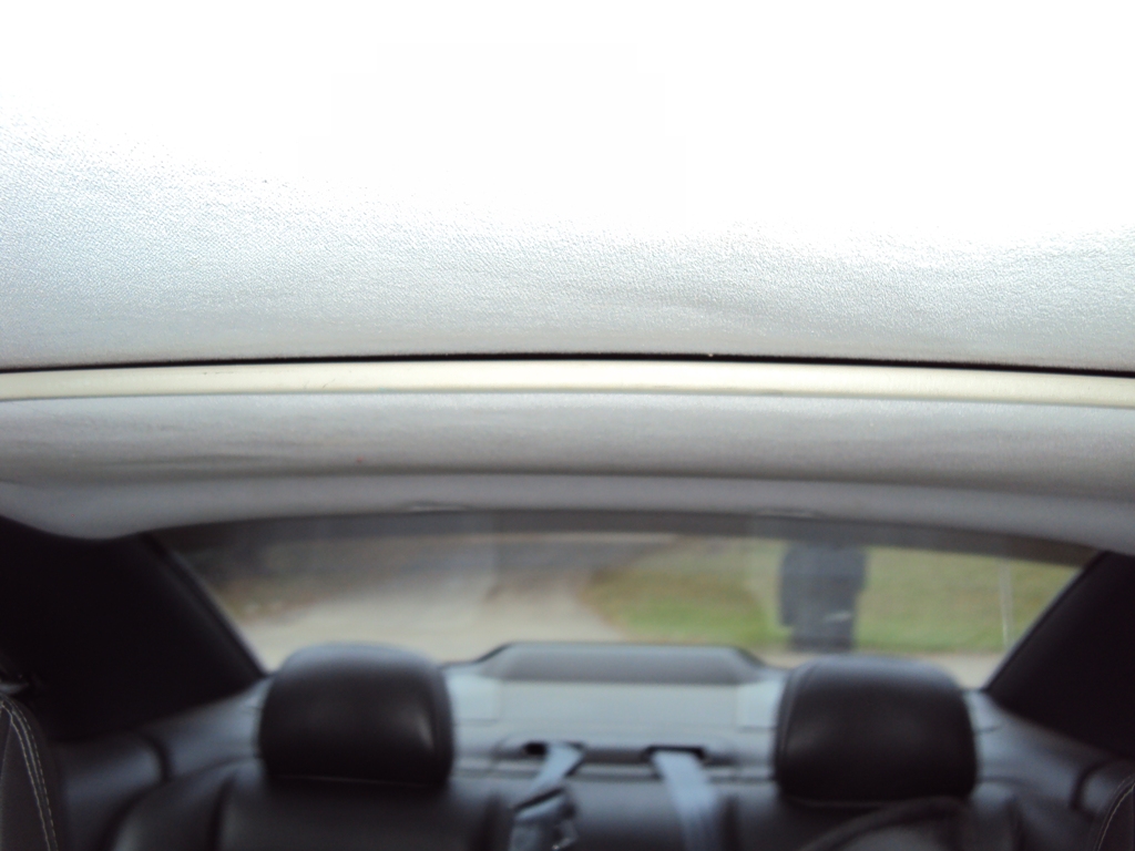

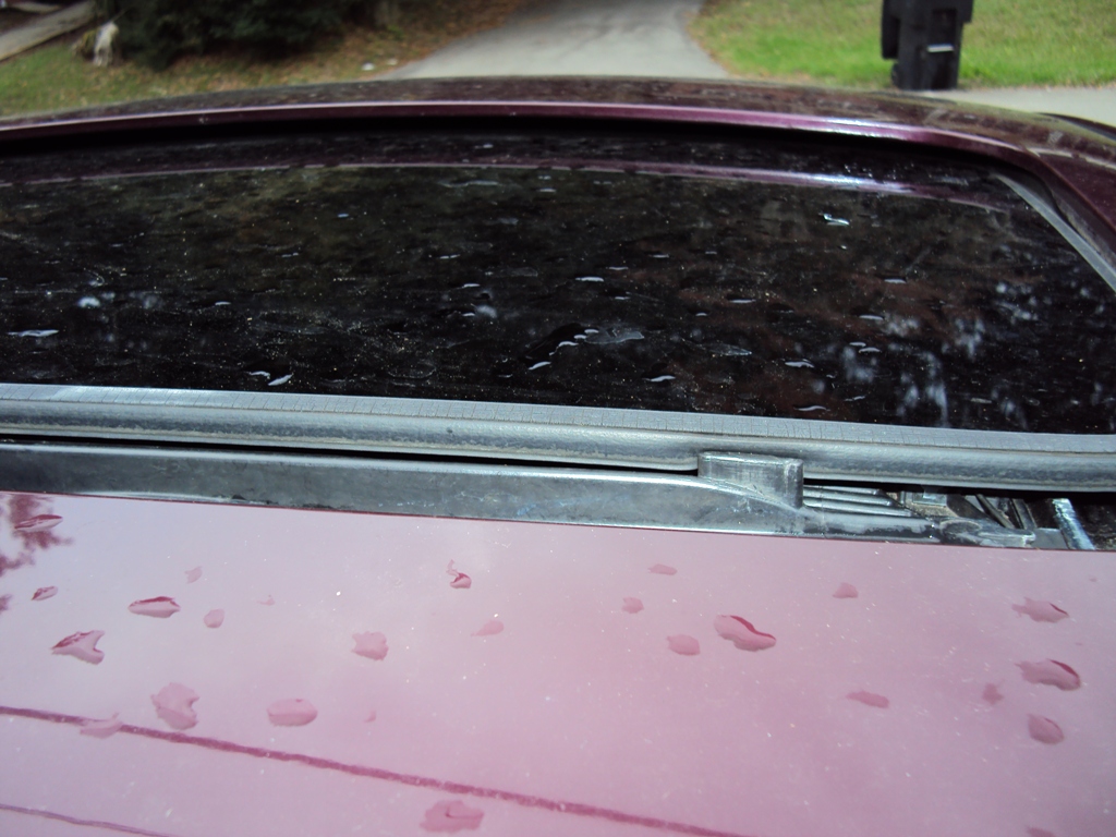

Ok definitely a stupid question, changing the pixel size is pretty easy. Here are some pics, let me know if any other angles will help diagnose the problem.
- Bens Car 001.jpg (333.93 KiB) Viewed 2574 times
- Bens Car 002.jpg (415.64 KiB) Viewed 2574 times
- Bens Car 004.jpg (351.73 KiB) Viewed 2574 times
- Bens Car 005.jpg (333.93 KiB) Viewed 2574 times
- Bens Car 006.jpg (312.87 KiB) Viewed 2574 times

If it wasn't for you living that far away I would say. meet me somewhere and we can work on it.
Def email him the photos so we can get you back to a closed moonroof before the rain starts./
