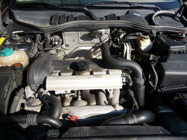

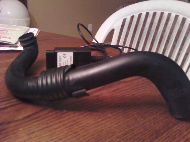

i am ordering my O2 sensor and wanted to replace this hose in the picture.
i looked through the hoses on fcp's website but didn't see one looked like this.
can you help me with that?
thank you..
it is in front of the car, next to the red oil dipstick.

BRO!!! that goes to your Cpu box. do what i did as a temp fix untill you can get one!
Get some electrical tape and wrap wrap wrap it!
I managed to find the hose at a auto yard when they brought in an 850 WHILE i was walking thru!!! usually they gut the motor and this part comes out too. Check FCP's site for it.

IPD calls it the air duct hose. It connects the ECU to something...

What does that thing connect to? Ive always wondered.. I know it goes to the ECU but the other connection.... yeah no cluejtp wrote:IPD calls it the air duct hose. It connects the ECU to something...
but here it is.
http://www.fcpgroton.com/product-exec/p ... gory_id/10

Without going to Vadis which means shutting everything down and booting a windows partition I can't give you an official name for it or a part number. It is an airflow line to the ECU box and it is relatively unimportant. It is under no pressure at all. I do know that it is relatively cheap but you can just wrap some black electrical tape around it and it will be fine for years to come. Even if you don't wrap it it will be fine for years to come.

The purpose of that plastic hose is cooling of ecu's in that box with outside air.The other end goes to cooling fan carrier.

Those things only cost about $8 at the dealer if memory serves. Particularly in hot weather, I think you want to have a hose there that works. Your chip MIGHT not burn up but, why take a chance? It's only $8. The computer it cools costs a lot more than that.

The part number for an OEM is 3545307 >PP<
My old one is wrapped in electrical tape. Workd great, I just wanted a good condition one and wasnt about to pass it up.
Note the tape! lol.
Note the tape! lol.

i am going to wrap it up
