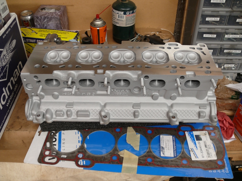

Messed around in my shop this morning cleaning the cams, a little touch up on the head, and did a dry run locking the cams into the top half with fordman's tool. Heading out to the garage where the car is to finish cleaning the block/pistons. Might even bolt on the head. Stay tuned.
AFAIK, I shouldn't have to do anything but time it properly. It has Hydraulic lifters which have been in oil since removed iand labeled in order. The head/valves were rebuilt to specs. so I'd assume Clearwater knows what to do. If anyone knows differently, now's the time. The head will be bolted on tonight prolly around 4-5 Eastern. Finishing cleaning #5 piston now.

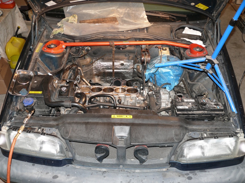

Yeah, I have a new respect for these motors. After the valves blew, I shut her down and the next day figured the worse via compression test. Fast-forward 3 days later I was towing. Cranked it over-n-over on a weakened Optima Red Top and it finally fired up. Drove it up on to the tow dolly. Towed it to the garage (hour later) cranked it up again and drove it into the garage. Hope my Cat isn't fried from raw gas.

Don't know about the valves, but the ones that were replaced seem to be the same as the original ones. I'm really just trying to get it back on road with as little $$ as possible since it's a daily driver.

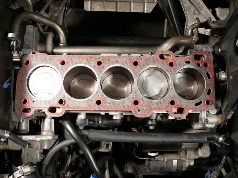

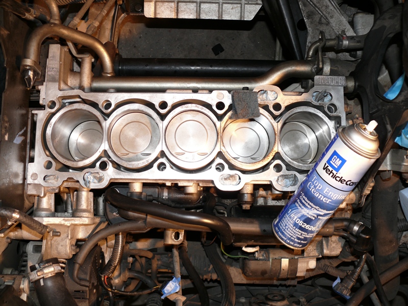

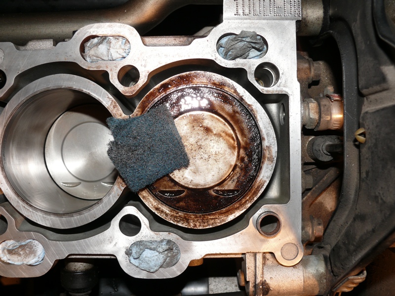

Here are the pics from finshing the block cleanup and head bolt down.
Cams and top half tomorrow, stay tuned.
