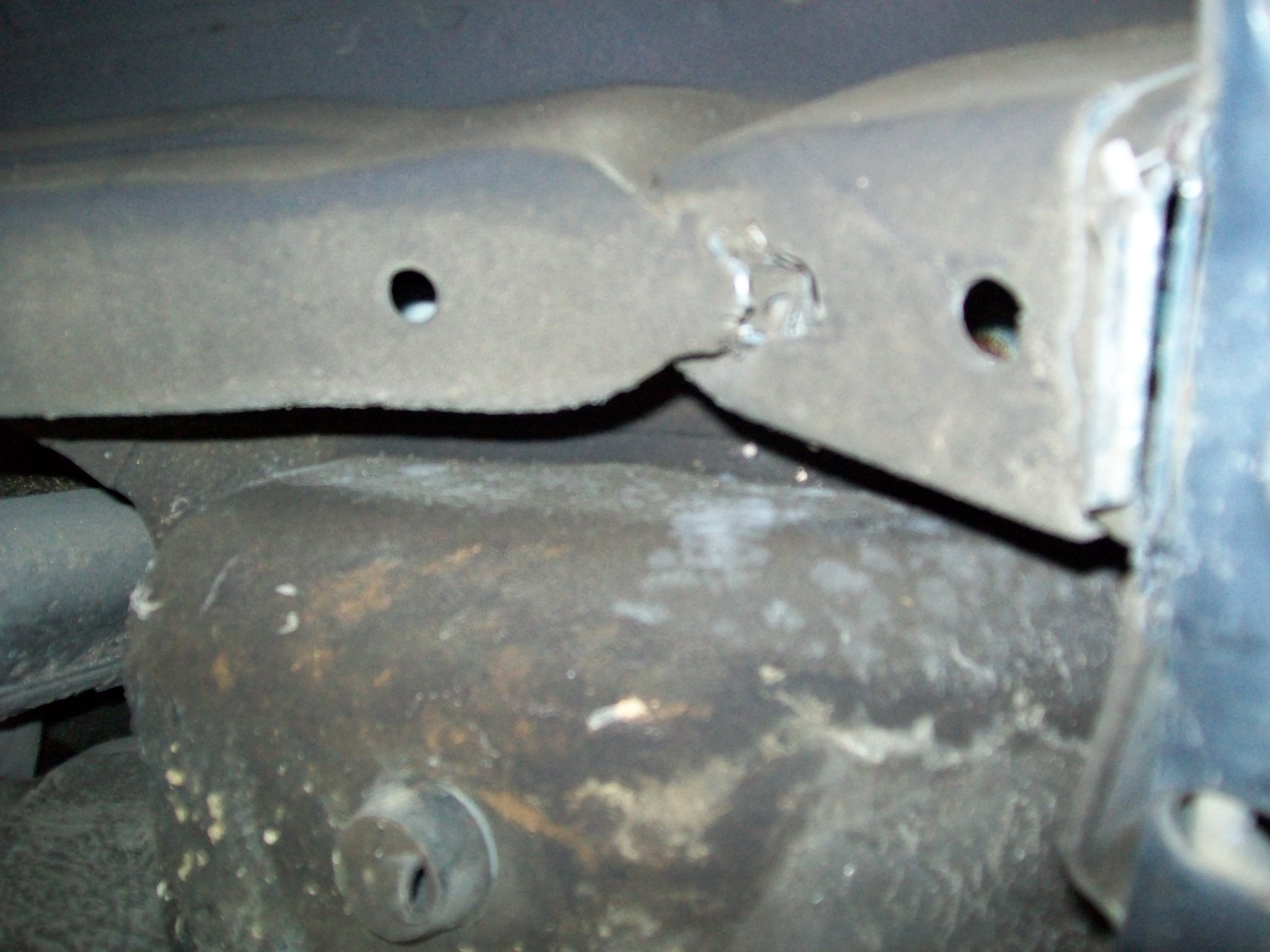

Here is the frame/bracket just in front of the bumper on the passenger side (the driver side isn't as deformed). It looks like it might need to be welded or bolted back together. That doesn't worry me as much as if it were a front bumper problem.jablackburn wrote:Probably not the answer that you want to hear, but I'm gonna say it depends what got bent under it.

I know the picture looks like there is damage there, but it is just a reflection. The sheet metal is smooth. The only sheet metal problem is a slight outward bowing effect around the rearedge of the wheel well just in front of the bumper.JDS60R wrote:Do you know what happened to the right quarter panel and right rear door. It looks like the rear impact caused a kickdown and kink in the frame.
The underside picture I just posted is the only damage I can see from underneath.

I see. It has damamge to the rear body pane as well . It will need about $350 in metal work (weld, pull frame) and then the parts from a salvage yard. Car would be worth about $200 in its current condition.
