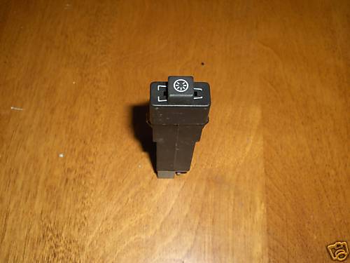

Any suggestions on how to check the dimmer or connector, or perhaps a link to someplace that could tell me?
Posts: 8363
Joined: 31 Mar 2010, 09:54
Year and Model: 2004 V70 2.5T
Location: Omaha NE
Been thanked: 504 times
Post by cn90 »
Gently pry out the dimmer switch.
Disconnect the switch.
Now short both ends of the connector, if all lights are ON, the dimmer is bad.
