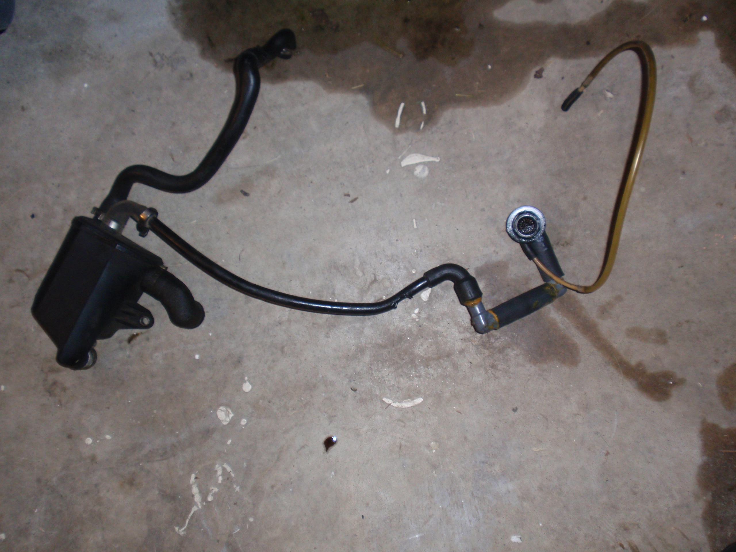

Another short update, I made good use of the last collection of parts I got. It's no secret that I took some short-cuts to get the car at least operational and get it moved, yeah, yeah, procrastination. I really ran into more hurdles than I expected simply due to the difference in the two engines.
I hadn't shown any pictures of it, but I believe that I had mentioned having to modify/extend the breather hose from the oil trap to the flame trap on the PCV system. Well this came back to bite me in the butt :oops:.
Turns out on the < '95 models the hose to the flame trap is longer and comes up between two of the intake runners, then over the top of the manifold to the flame trap. The ≥ '95 models the same hose runs under the manifold. I used the PCV system off of my original engine because I knew it was operating correctly, and I had no clue about the system on my new engine. Only after I had the engine in the car and mostly together did I realize the newer PCV system didn't "fit" on the older engine.
So here's how I modified it, this is a bit more of my famous booty fabrication :wink: :
Here you can see the problem, circled in red, the hose got up against the line from the exhaust manifold to the EGR and melted a hole in it:
Which resulted in this oily mess:
After a can of oven cleaner and a good preassure washing, I put the new and proper PCV system on, and hey look I actually used an intake gasket this time :lol: :
I did all of this a couple of weeks ago, and I don't smell burning oil anymore, weird huh?
