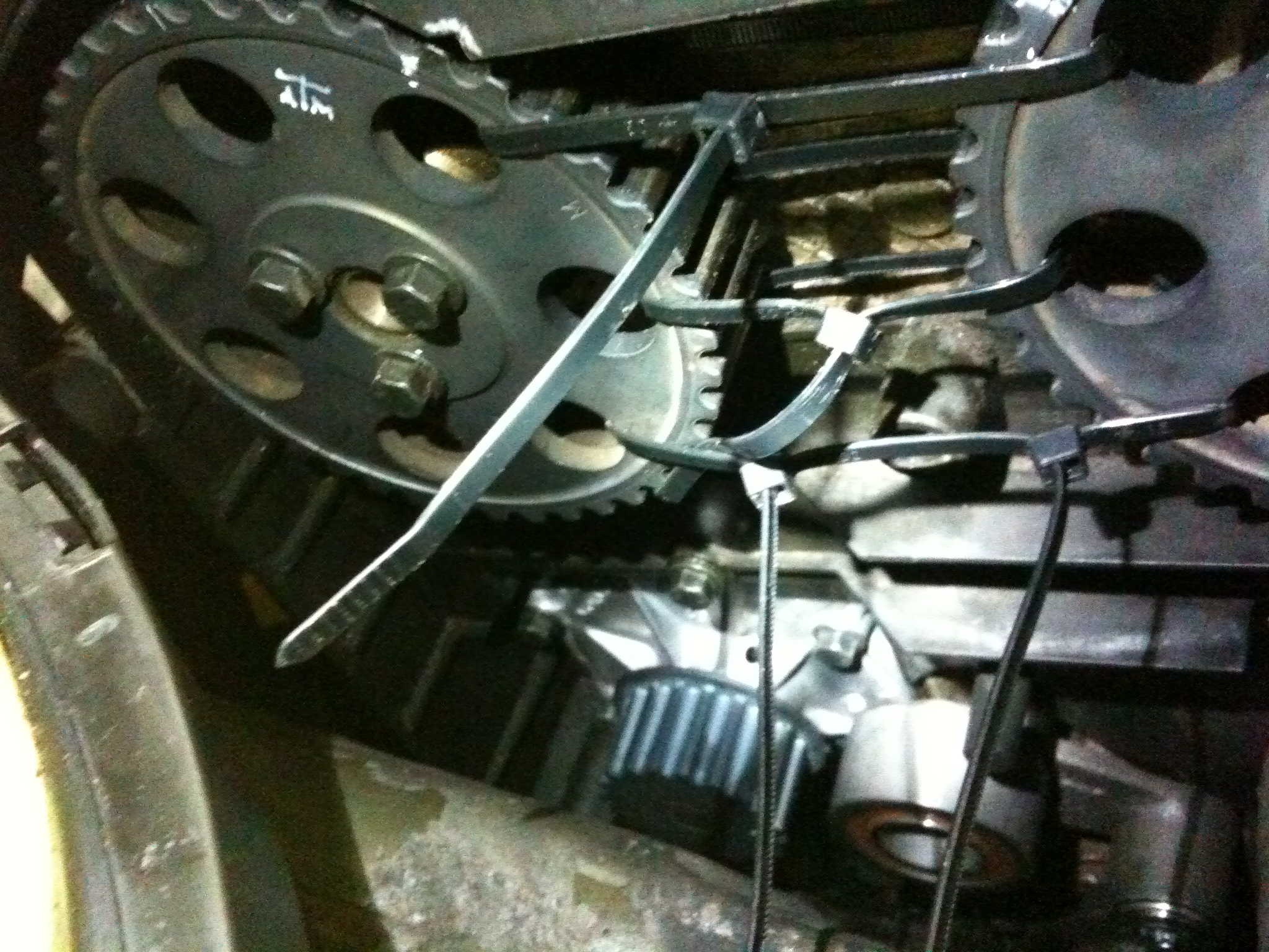

but if I had to do it again ..I would pull out the serpentine pully FOR SURE.. the part problem was with the tensioner not being as tall as the one that came out so yes it will go back. One thing I did learn/try and it worked was using zip ties in the exh/intake sprocket holes before removing the original belt. one in the middle real tight and two more. They hold the sprokets in place real good if thier real tight. Also marked the belt and those sprokets with white out then just counted the teeth in between the marks and matched the new belt by counting the teeth and sprocket marks to make sure the sprokets didnt move that worked well.I guess I hate working on things that I must use my fingers half the time to feel rather than see whats going on (: The disc brake tork T-45 socket is the trick, its shorter than most torx sockets. I must admit I was a little scared when I turned the key!

We changed our second belt. I agree the Haynes manual is more of a guide. We didn't remove the lower pulley, instead choosing the method of going around the pulley. I mark the cam shafts at the top and the one at the bottom. I don't move them, but zip tie the ones at the top (pictured). The exhaust cam moved a little while we were working, we just took a large screw driver and using the screws, gently pried it back when we put the new belt on. I figure with the zip ties, they can't move more than a tooth.
