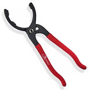

Use a oil filter wrench. Not the flexible kind, but the kind with teeth. It is sold at Auto Zone, etc...
- try one of these
- oil filter wrench.jpg (12.5 KiB) Viewed 3578 times

Thanks for the suggestions. I'm going to try either pkc's suggestion or a generic in tank pump removal tool like the following...
I'll try to do a write up on the this as Vadis was somewhat vague in my newbie opinion...
The generic tool above worked quite well. Was $18. I had to modify it with a grinder to fit the volvo spacing, removing the extra length and reducing the width of the teeth.
