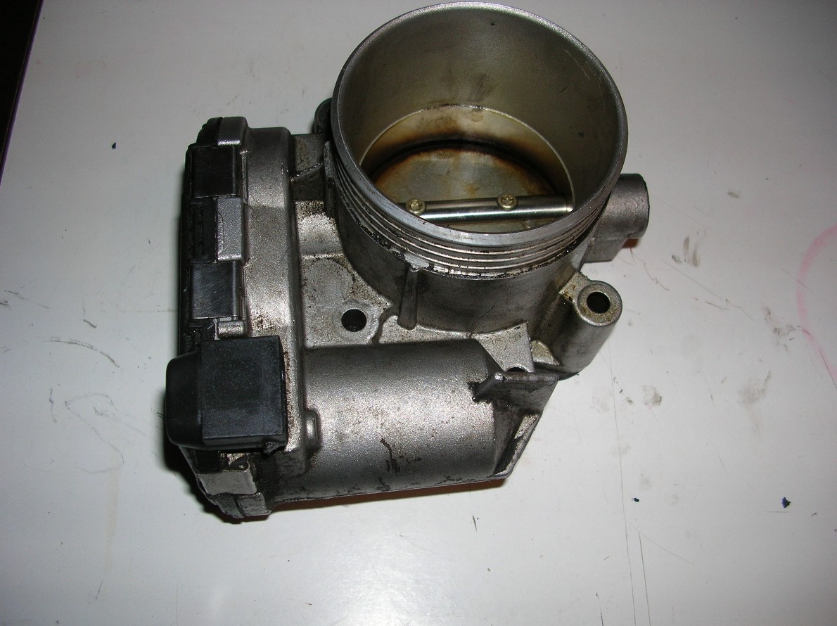

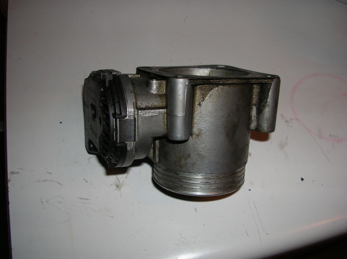

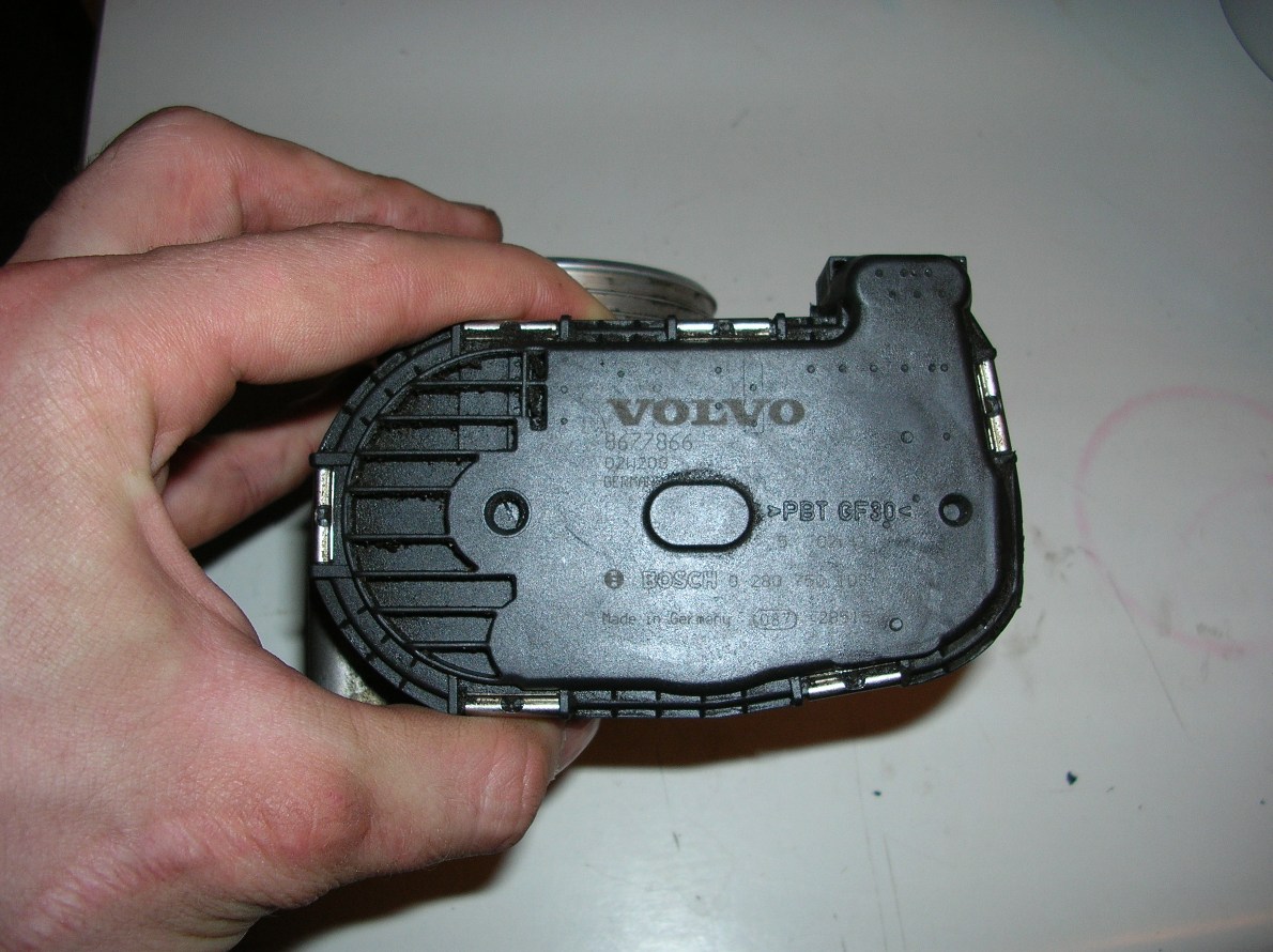

I took out the ETM yesterday and did not see either a yellow or a white sticker on it. I opened the side and there was a semicircle resistance strip with two gears to drive the butterfly valve. Is this a model that XeMODeX can fix? I am attaching pictures of the ETM.

I would try to eliminate the misfire code on #1 cyl. first, before replacing the throttle. Since you did the plugs already all is left is the coil on that cylinder. Once you got that out of the way and still have idle problems call us we have Bosch throttles in stock. There is no messing around with software, just plug and play.
