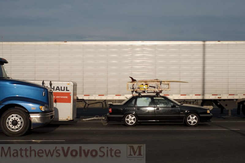

Your Volvo should be fine if you don't do lots of shifting. If you feather that clutch over and over on your trip you'll burn it out. While my 850 is auto, I tried to get up to speed and not vary things too much. Do the same. Find a comfortable spot in the slow lane and take it easy.

1997 Turbo. Power is not really a concern with any US-spec 850 unless you're literally running out of muscle going up mountain roads and thereby being a dangerous slow-moving target. You'll be able to get up to 60mph and stay there.

Matt's is a Turbo. I've been thinking about putting a hitch on mine to move stuff in the near future; I'm just concerned at this point about the rear wheels dragging. My car has a factory sport suspension (in need of replacing too), and I had it packed down with moving stuff last week, and shingles the week before that, and the wheels looked like they were just about dragging the arches. Your NA should have smaller tires and a higher ride height, so you probably won't have that problem.
The most important thing to remember when towing with any car (especially one with a smaller engine) is just don't push the car too hard. Both the engine and transmission are working harder to move along, and it can overheat if you're running flat out, running AC, and its hot outside.
Plan way in advance (especially for braking), shift HIGH (3500 RPM or so rather than 2500), and keep the revs up on hills to avoid straining the engine. Most of the torque in the NA engines is above 3,000 RPM, so depending on how much weight you're carrying, you may have to climb hills at highway speed in 4th gear or whatever's appropriate for your speed. Your engine will be happier to work less hard at a higher RPM than giving you everything it's got at a lower RPM.
Other than that, like Matt said with the Stage 0 things, new fluids and new hoses are probably the best thing you could do to prepare your car for the trip.
