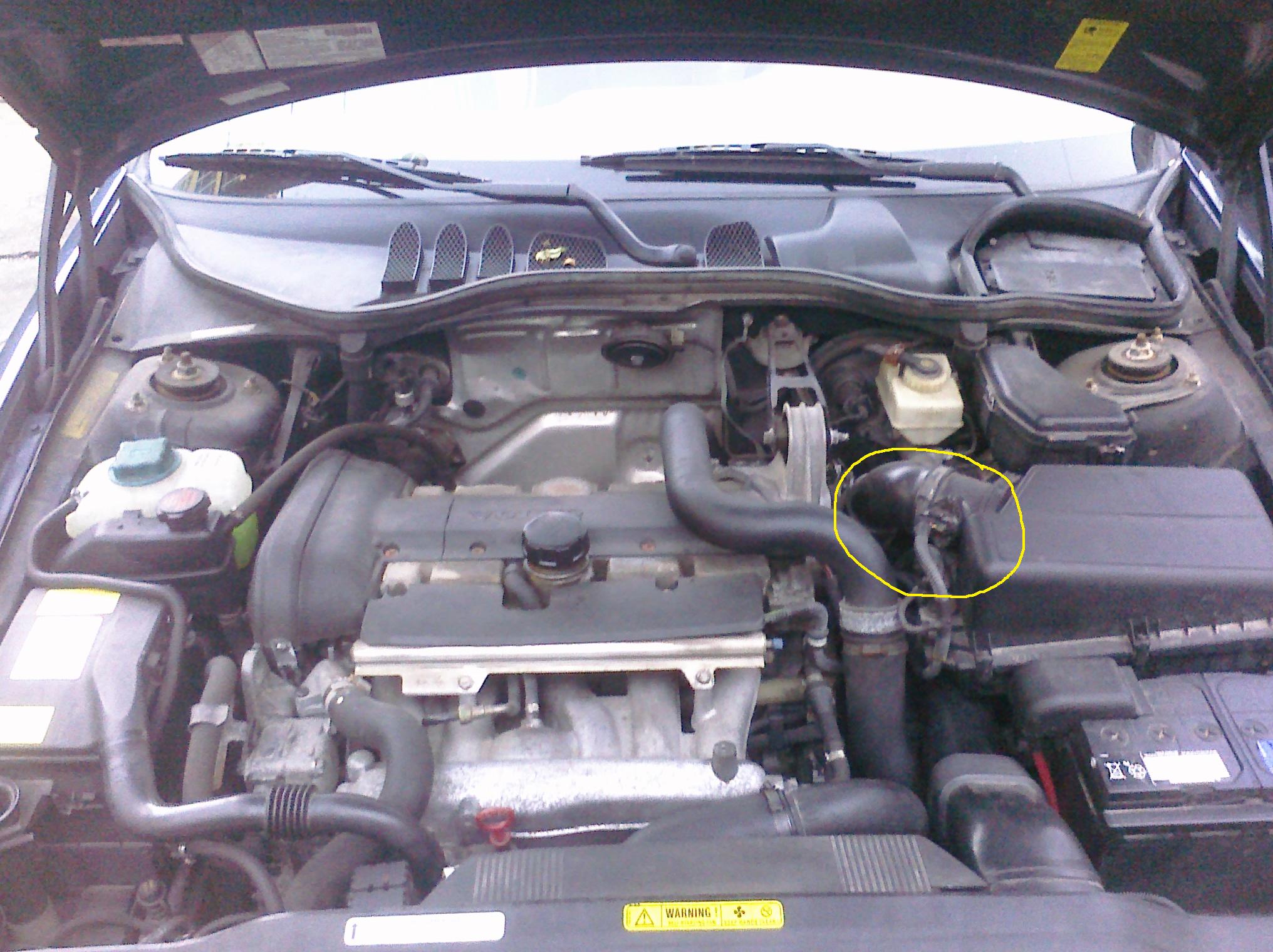

I used carb cleaner on my IAC and still have the same symptoms. This morning I started it cold and let it settle down for about 60 seconds, and then I pulled out the MAF (the circled component in the picture). It died immediately. Dumb question but, Is that normal or not?
