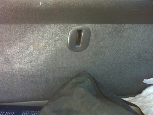

I recently installed a third row seat in my 1996 850. I cut through the carpet on the back of the back seat (using a regular utility knife) and pushed the plastic piece into place since it's useful in keeping the carpet out of the way of the plastic latch. I don't think the plastic piece serves any other purpose. It's quiet true--all Volvos really do come from the factory with all possible options and bolt holes, and all you need do is make the right attachments.
I've attached a photo of this plastic piece. To keep the upright part of the 3rd row in the upright position, just pull the little strap on the bottom of the upright seat. It causes the lever on the back of the 3rd row seat to pop out so it can insert into the back of the 2nd row seat. When you want to collapse the 3rd row seat, just pull the same strap and the lever releases.

Does any one have a part number for the piece that goes in the back of the middle row with the slot in it?kidink wrote:I recently installed a third row seat in my 1996 850. I cut through the carpet on the back of the back seat (using a regular utility knife) and pushed the plastic piece into place since it's useful in keeping the carpet out of the way of the plastic latch. I don't think the plastic piece serves any other purpose. It's quiet true--all Volvos really do come from the factory with all possible options and bolt holes, and all you need do is make the right attachments.
