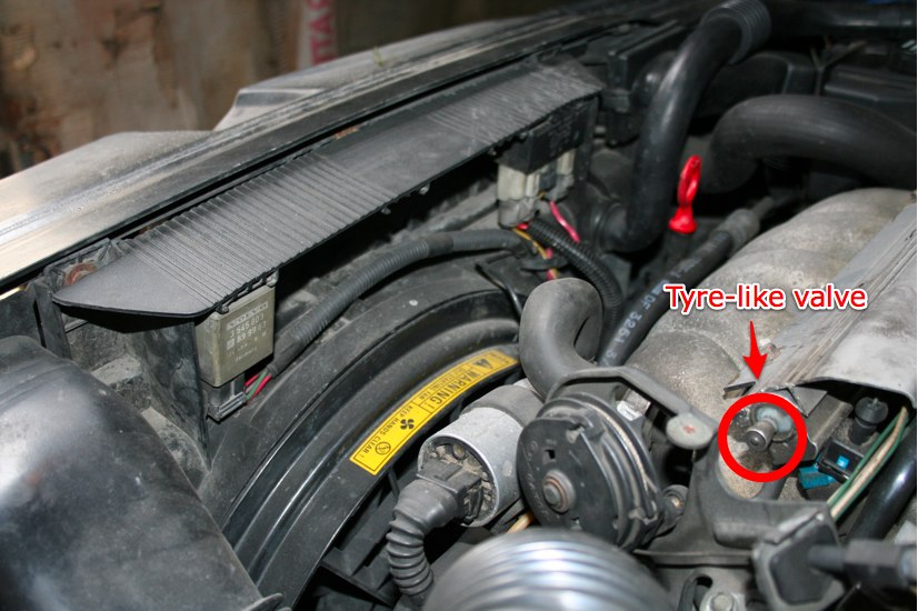

- I opened the tire-like valve at the right-hand side of the injector ramp. It usually is pressurised with fuel. Instead it sometimes has air. When I do a purge, the car starts instantly.

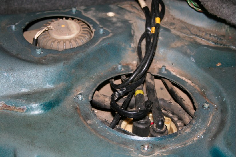

- It could be the EVAP valve... but where is it ? I've looked behind the two metallic round plates in the trunk...

- How can I pressurize the whole circuit so I can find a leak ? Can I use the tire-like valve ?
