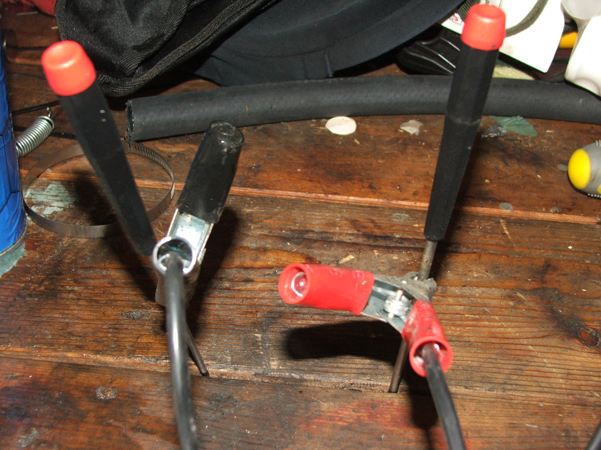

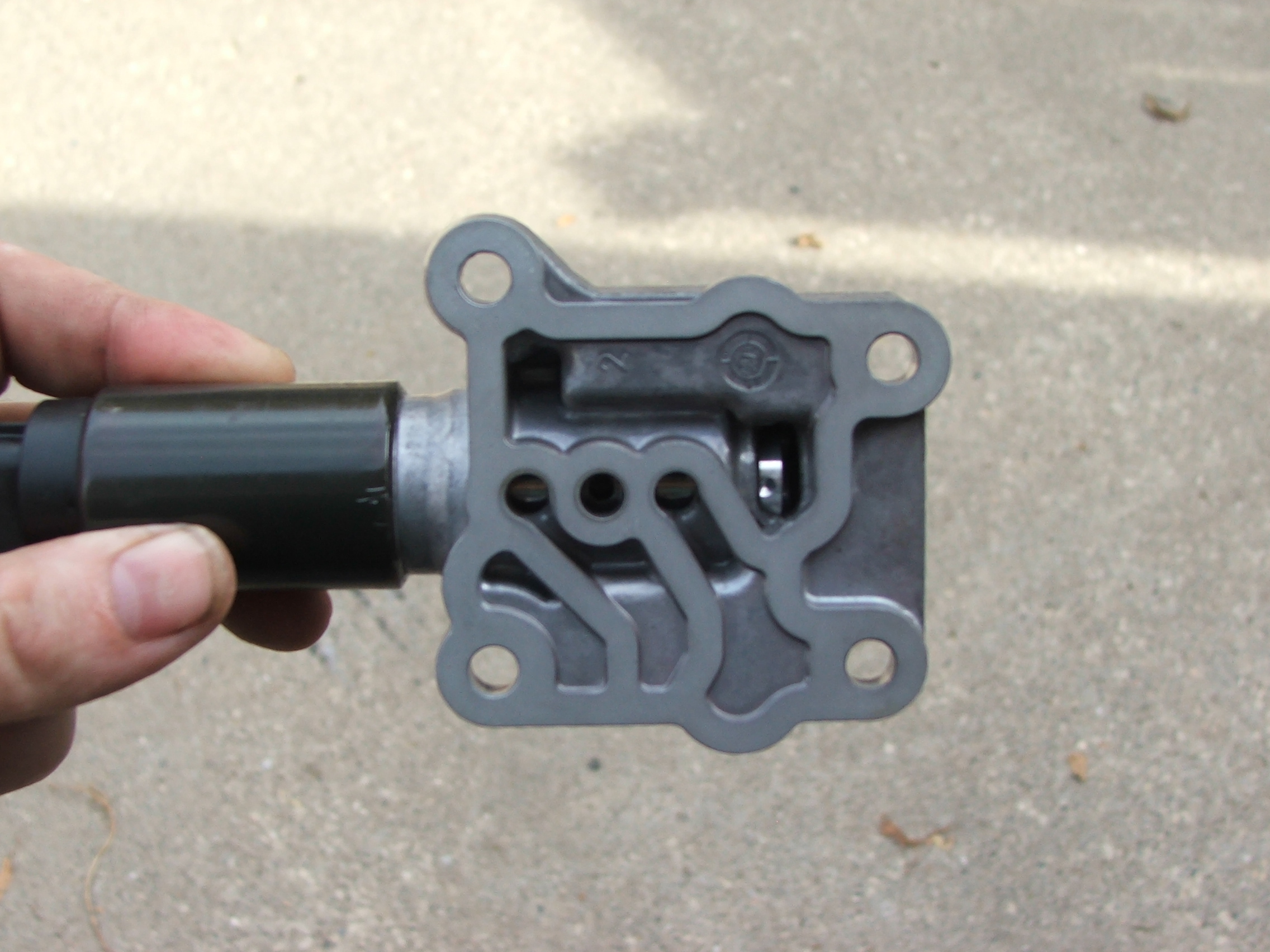

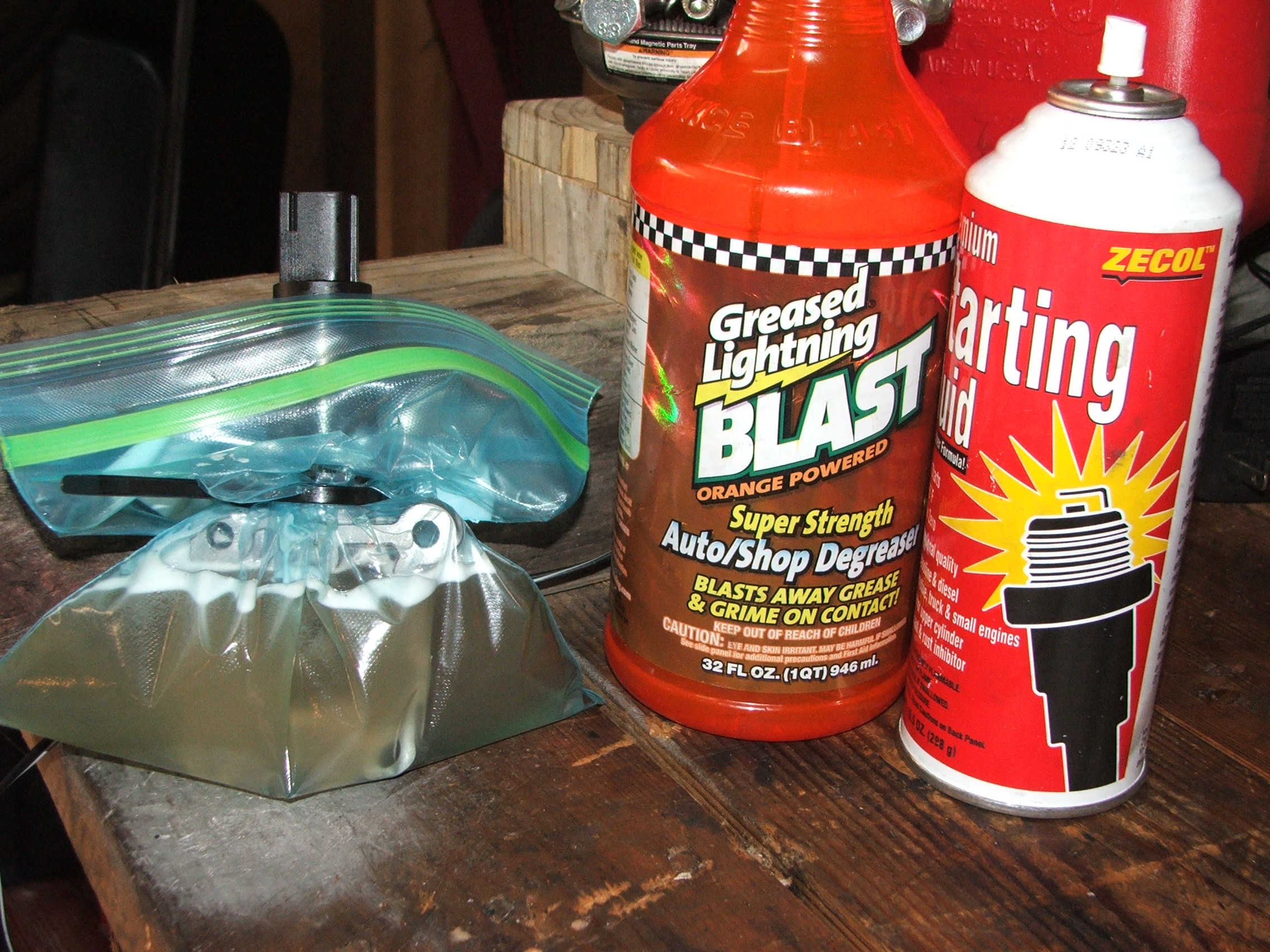

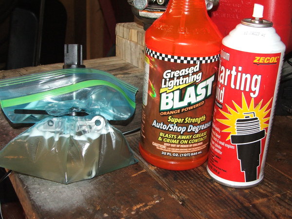

I cleaned mine today, it was throwing a code for it so I pulled it off, put some orange blast degreaser in a zippy bag, immersed the the metal part of the solenoid in the degreaser and excerised it with a 12V current. Finally I cleaned it out with braker cleaner. I guess I'll see how it goes...
The finished product
Ghetto solenoid excersiser. Two screwdrivers and a battery charger!
Solenoid immersed in degreaser
