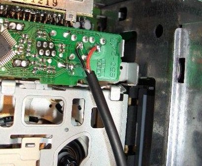

Well, I'm done with all 3 of my radios. I did the mod for the SC-813, SC-815, and SC-816. I had problems with the SC-816 because it would not work like the other two. I tried about 5 or 6 times, just would not work right so I switched the connection method and it finally worked out.
So, I soldered the 813 and 815 to the back board. The volume is standard and sound is very clear. Has better bass response. The level is standard, set at about 80% to be level with the cd and radio.
Volvo 815 radio tape deck mod
The 816 was soldered to the top board like in the picture below. The board was a little different so the ground was in the pin just above the joint in the photo. You really need a ohm meter to do this mod. The ground can be soldered to the chasy. The volume was on the loud side so I had to set my player to about 40% volume to be as level as the radio and cd player.
Volvo 816 radio tape deck mod
I'll do my own photo instructions and post them incase someone needs yet more instructions to do this.
As for my droid cutting off, well, it cuts off and back on as the music is about to play again, on the SC-816. If there is a 5 second pause in sound, I hear a low freq pop as my droid cuts sound from the cord, then another pop as it turns it back on. Kinda sucks but if music doesn't pause it I don't hear the pops. Quality is worth it.
