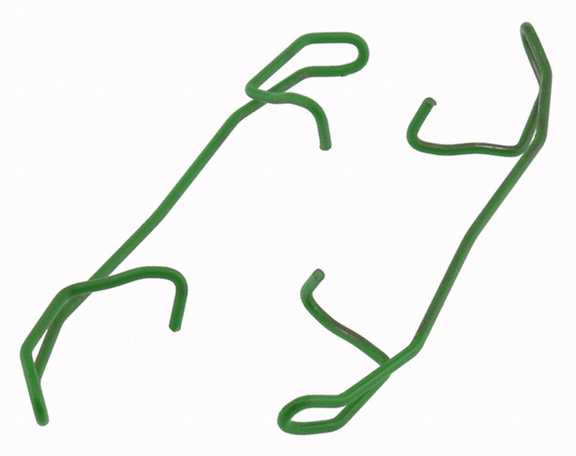

Hey there Justin,did you mean the springs in the pic below?Or, are there other spring hardware?The pic is from Napa you can get 2 for about $7....I do have this spring,maybe I should buy a brand new one.....

That's the one. At $7 it might not hurt - it's there to keep the pads from chattering around which will cause the squealing while braking. Good to know that NAPA has it - Advance carried the caliper bolts, but not that piece. There's got to be one of those somewhere around here - the closest Volvo dealer's about 50 mins and I try to avoid them if possible.

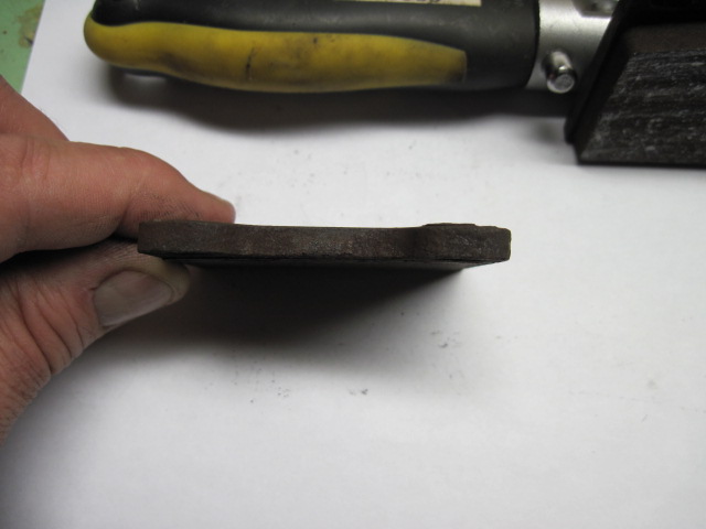

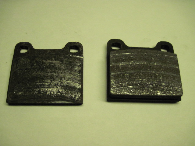

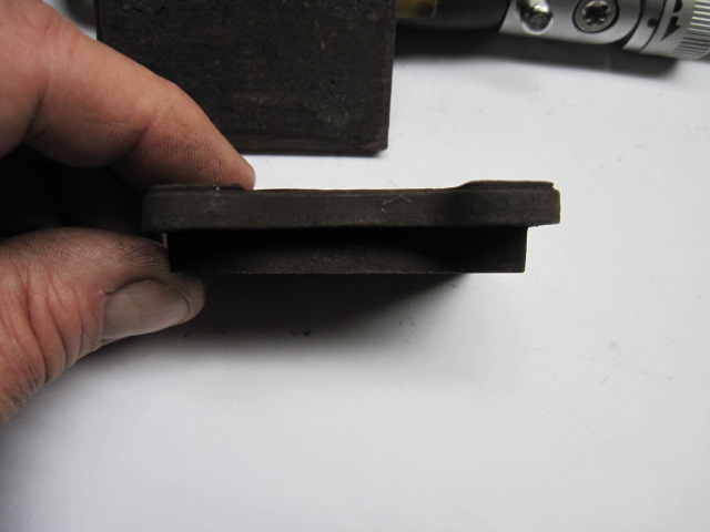

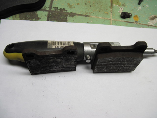

:oops: My bad....even my wife said the squeal was from the rear drivers side.....until i opened the door, and heard it....I replaced the pads,I do need a new rotor,caliper,i'm thinking this is original from '95, i broke the bleeder valve off....anyway,no more mr. squeaky for now!So the rotor,still in good shape was squealing on the bad pad..... :roll:

Either that bleeder valve was stuck good, or you got a little over-enthusiastic with it! It does look like your caliper was sticking anyway - both pads should have even wear on both sides.
