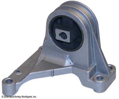

The engine stabilizer bushing on top is wore out. I dont want the OEM one because it requires a special tool and I dont want the two-piece poly one from IPD because of the excess vibration. Will this from Beck/Arnley work? I know it would cost more than just the bushing. But to me it might be worth the trouble it saves.

I think that is the 1999 & 2000 model mount. Your 98's looks much different. - it's sort of a triangle shape.

Yea, the one in the picture is the 99 and later mount. I was wondering, is there anything different from 98 to 99 about where that mount bolts to on the engine? What I mean is, would the later style in the picture bolt on in place of what mine has?

It won't fit - the top of the 99 engine is shaped a little different. There's no place on the 98 engine to bolt that one down.
