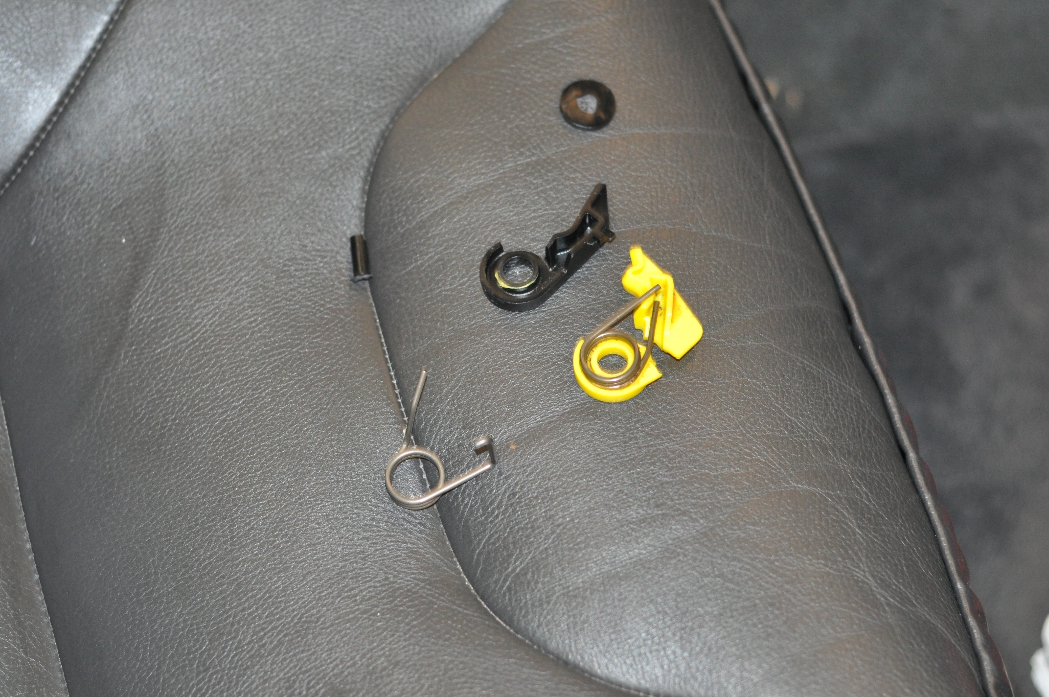

Update: Called the Volvo dealership and when I told them what was happening they knew exactly what I needed (almost like this is common). It cost me $10 dollars in parts and an hour of my time to fix.
Here are some pictures.
The yellow and black pieces hold the shifter in drive. You push the shifter out of the yellow and black pieces when you go into manual mode. So when it won't stay in drive, one of these plastic pieces is broken as seen in the pictures.
This is a fairly easy fix. You have to remove the center console (two bolts in the console storage unit and two bolts under the pen holder thing in front of the shifter. From there it is just popping things out. The hardest thing to do is get the shifter cover off (the black thing I am holding in the pictures.) It is held in by the u shaped clips and requires some gentle persuasion.
Hope this helps.

this is so my problem, removed center console, and there was a piece of the yellow part just laying there. I really appreciate the pic's too. My only problem is, I can't figure out how to remove the is the cover for the shifter box. Can't for the life of me figure out how to remove it.
I'm assuming the cover from the rear is closest to the dash board, I must be doing something wrong, it aint budging. I see the u-clamps your talking about, just have no idea how to get them out. What tool did u use? Just don't want to brake anything
jda2000
- Posts: 584
- Joined: 01 Apr 2010, 17:22
- Year and Model: 04 V70 2.5T 01 V70T5
- Location: Sarasota, FL
no, you pull the back of the cover facing the rear of the car.
Once is loose from the rear, it loosens from the front and the cover can be lifted a few inches to disengage the clips.
Use a long screwdriver for the clips.
thanks for the help. Got it all exposed, and I see the problem. Is there a place on line I can go to that has full schematic of the shifter mod. You guessed it, the yellow piece is obviously held in by the black piece, and that held in by what appears to be a plastic rivet of some kind that appears to be spring loaded. This appears to be a bit more complex then originally contemplated.
