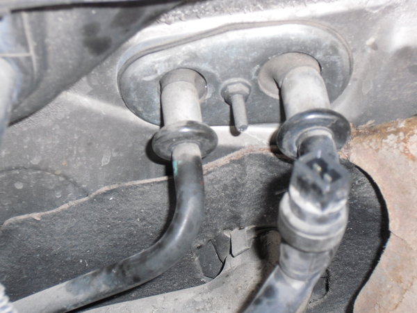

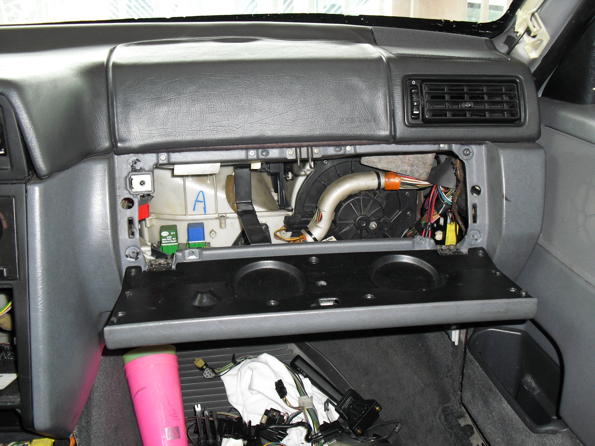

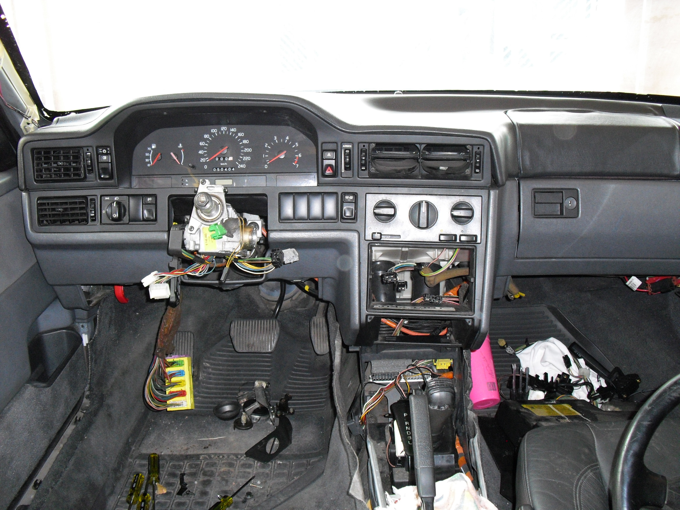

I found this volvo in a yunk yard, and i bought it! the engine doesn't work, and it is uncomplete, so I bought it for spare parts.
i'm working on it, trying to get off the dash, seats, everything, i'm using an excellent document that i found here, but i'm having problems loosing the pipes from the evap to the fire wall, i don't have the tool that is required....
http://www.woodjoiner.com/volvo/VolvoEvapReplace.pdf

Is there another way to release the tubes of the evaporator?
I'm stuck here! I can't pull the dash out, if anyone could send me an advice or maybe another tool, to release the pipes.
Inlet & outlet pipes from the evaporator
Dash
Dash
Thanks
Oscar
Passenger side, air bag disconnected

The doughnut shaped part holds a spring that needs to be expanded so you can pull out the pipe. They sell little round plastic tools to push in to open it and they are cheap here. If you put a piece of wire/tubing/whatever in from the firewall side of the doughnut you would be opeing the diameter of the spring. Once wide enough the tube will come out. Ford uses this type of connection for fuel lines -it may be easier to find the tool that way.
ford fuel.jpg (6.08 KiB) Viewed 1908 times
fuel line tool.jpg (3.88 KiB) Viewed 1908 times

another tool that works
fuel line tool 2.jpg (4.57 KiB) Viewed 1908 times
Retired

Post by JDS60R »
How it works
fuel line how it works.jpg (7.32 KiB) Viewed 1907 times
Retired

I also once did it with a matchbook cover that I wrapped around the tube and shoved into the spring to open it up. It was almost thick enough. it was a side of the road repair.

I'll try to find those tools around here, thanks
