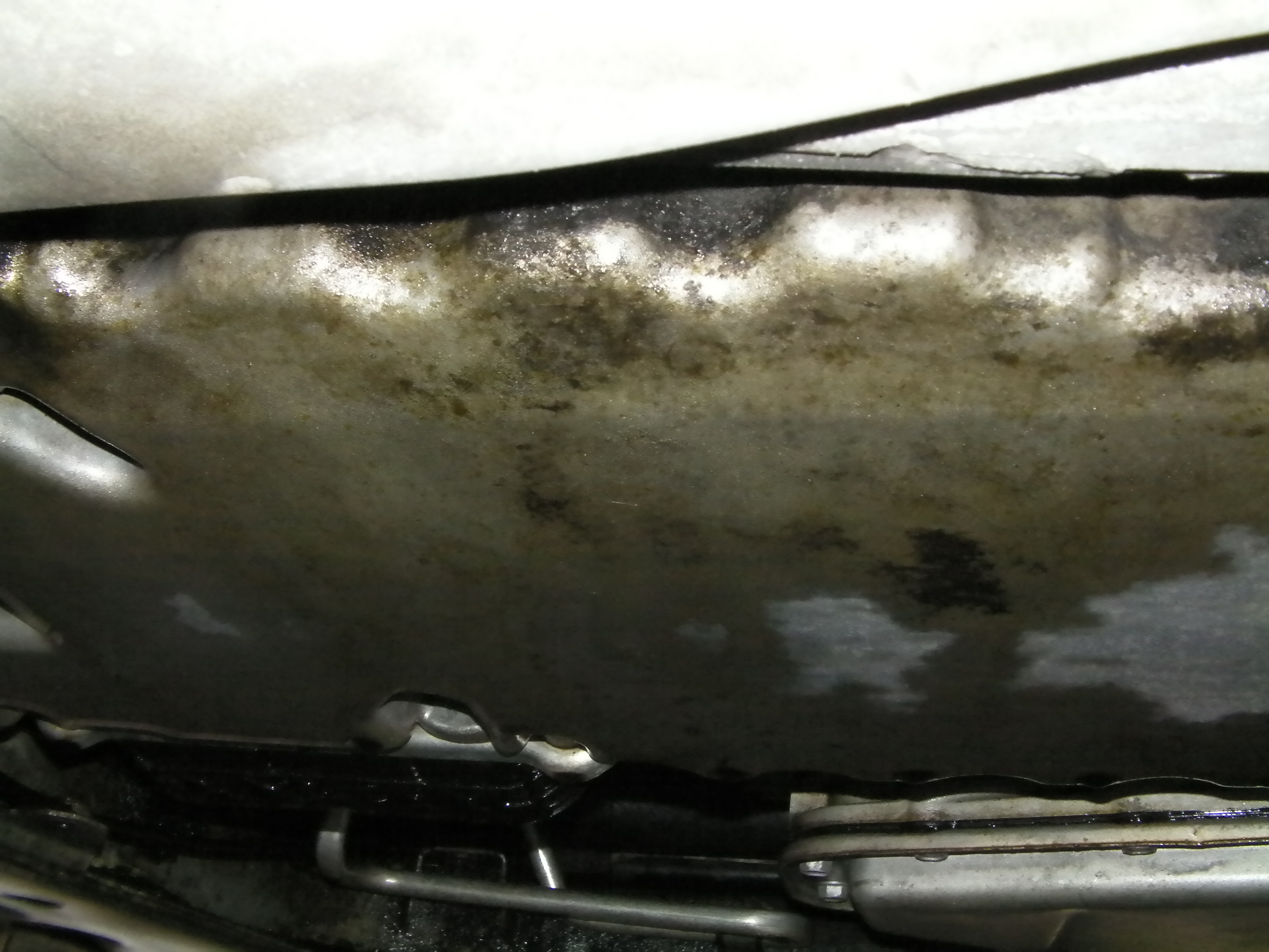

I know my twin turbo return seals are leaking, but now something else is leaking. Hope someone can help pinpoint problem and what should be replaced all at the same time. The pictures attached show the oil pan has oil leaking all around it,(Oil pan gasket?) but is that why everything behind is is full of oil. Is it just spraying back on everything as I am driving? Pressure gage it fine, but the leak has grown. The one picture is from above and where the flashlight is shinning shows oil all over, but I do think it is from twin turbo return seals.
I have a mechanic (not volvo) who is going to look at it. I was told that the subframe has to be dropped and I just want to be sure and replace every seal (any anything else such as oil cooler and so on) possible at one time to save on costly repairs. Also, when this occurs would it be any easier to get to the twin turbo return seals. The oil return lines have already been replaced. Please guide me is possible of everything to get replaced at the lowest possible price. I am confused when reading oil leak forums about the oil breather? What is it? Tnank you.

Subframe dropped? Is he\she kidding? I'd hold off on that for a while and maybe find a new mechanic, someone who knows volvos more intimately.
As you pointed out the PCV system is often the very first cause of oil leaks. The main culprit\area is a black plastic box (AKA oil trap or breather) thats attached to the engine block underneath the inlet manifold, behind the alternator. The part itself is about $35 is its clogged, usually it just needs to be cleaned out with solvents and have the seals replaced ($15!!!). When the seals start to die they can leak oil like you would not believe. It can get everywhere, yes even back where you are looking (I have some there too from mine). when I first got my S80 it was leaking 1qt every 30miles out of the PCV oil seal!! Either way the parts to service the PCV are cheap, its just a bit time consuming as the inlet manifold has to come off. You could do if yourself in an afternoon.
I can do the turbo return seals without removing the subframe and I'm not a professional mechanic. Basically they want to take the "easier" way (which is fair enough) but want you to pay for it. Clogged PCV can cause the turbo to leak oil too if there is excessive crankcase pressure, so start with the PCV. I think you'll still have oozing from the turbo return lines, but really its not a big deal as long as you keep an eye on it.

pcritikos In my car the bolts holding the oil return pipes on the turbos were 5mm allen. If you get under the car with a flashlight you should be able to see what you have. I didnt tilt the motor, but I had the fenangle a lot. It was hard, just be patient.
Thegirl, yes its something you can do yourself, theres a couple of guides on this site under the repair section. If you know how to unbolt and rebolt stuff you'll be just fine, just take your time, mark things, put them in zippy bags and or take pics as you go if you are worried. Its a PCV (as opposed to PVC, the plastic). It stands for Positive Crankcase Ventiliation. Basically it takes the nasty byproduct gases that escape past the ring and feeds them back into the inlet to be burned.
