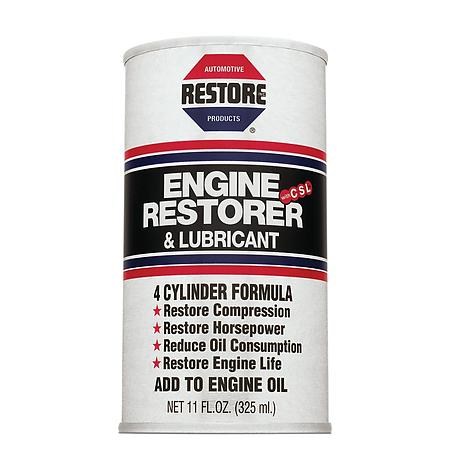

Post by JDS60R »
Try this
It actually works if rings are the issue
