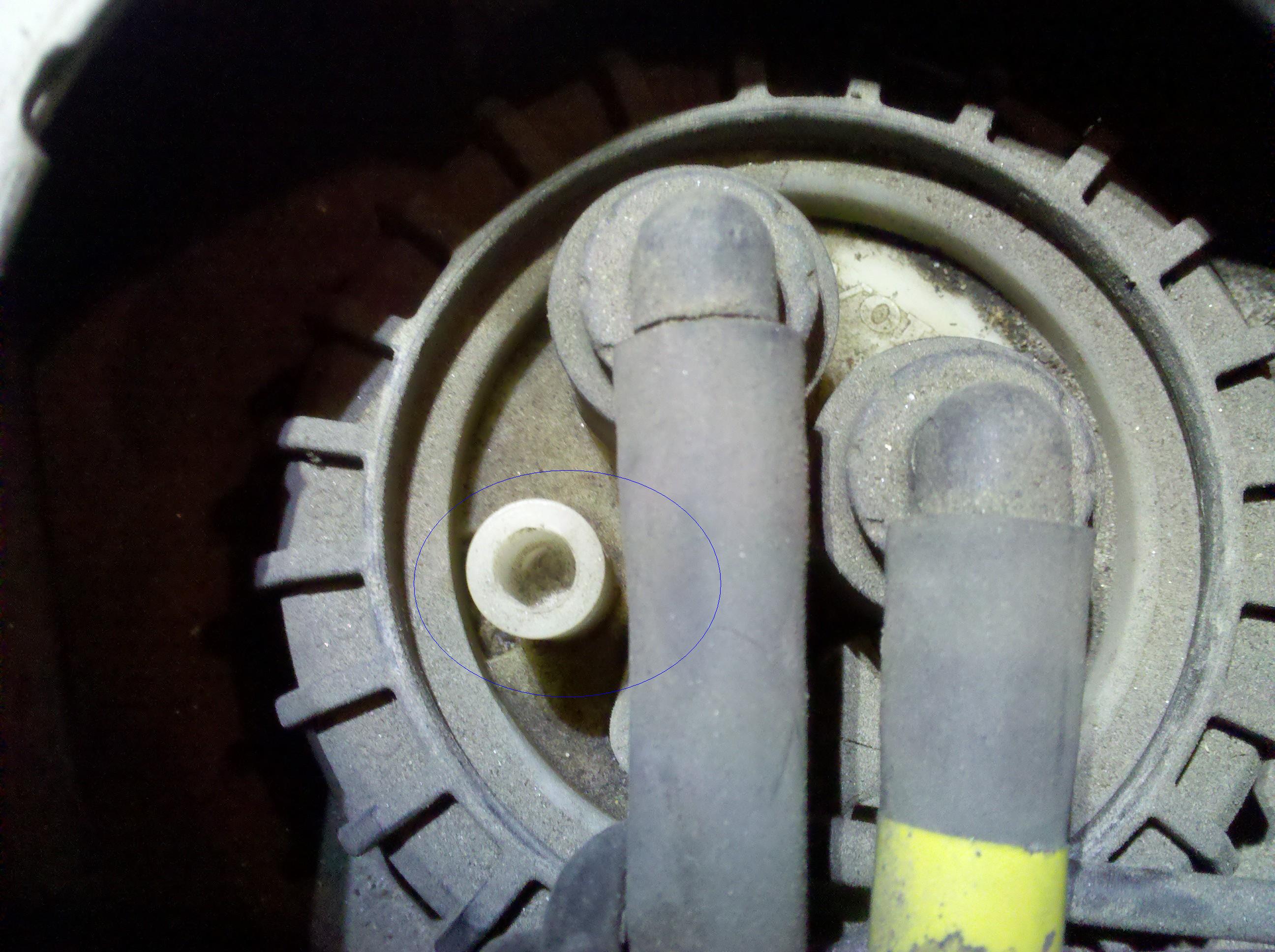

I looked at my gas tank inlet connection today looking to see if that might be the source of my evap leak callout and I found a couple things that didn't make sense to me and was hoping to get some feedback from the forum. I have included pics as well to help.
What is this white piece for and is it supposed to have a hole in it. I do not believe so and am hoping it isn't a relief of some sort, but any help would be great here.

That piece is supposed to be there. I'm not sure what it's for; my guess is that the same housing can be used for another car in the lineup. Can you smell fuel vapors through the little dent that appears to be there?
Usually EVAP leaks can be traced back to either a bad gas cap, or the lines coming out of the tank itself under the car up to the EVAP canister, wherever it's located on your car.

exactly- 1 housing multiple applications. unused in your case.
I doubt your EVAP leak is traced back to right here,
But a strong smell of gas here with the tank sealed is probably reason for some further investigating

Good to know it is not supposed to have anything plugged into it. In the last picture the inside of that unused connection has a hole in it like something punched through it. Is this normal then?
To address the fuel smell, i didn't smell a strong fuel smell, but you can smell fuel and I was curious as to what signs I should be looking for if it were leaking there.

It looks like that piece just has a plug on the inside to keep it from venting or anything.
I would start your search elsewhere, unless you do smell fuel vapors from inside the trunk.
