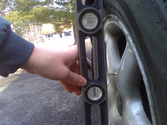

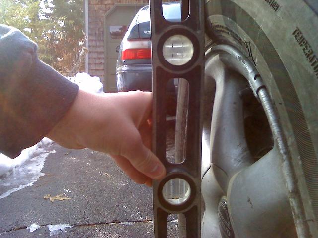

Think I should try and get my money back for the alignment since they didn't center the steering wheel? They might insist I criss-cross the front tires, they told me to do that when I went back after driving a bit down the road. The car does still pull slightly to the left but the tire doesn't look cambered six degrees. Maybe I should post some pictures from a few different angles? I didn't replace the nuts and bolts holding the spindle to the strut as suggested by the service manual after removing them to get the axle out a while ago.

If you have a 2' level slap it up against both wheels and post back pictures of the results.

Okay here are the photos, I don't think my dad's driveway is level so i posted the rear tires too as a reference.
- pf.jpeg (76.34 KiB) Viewed 1939 times
- df.jpeg (70.72 KiB) Viewed 1939 times
- pr.jpeg (66.42 KiB) Viewed 1939 times
- dr.jpeg (78.44 KiB) Viewed 1939 times
