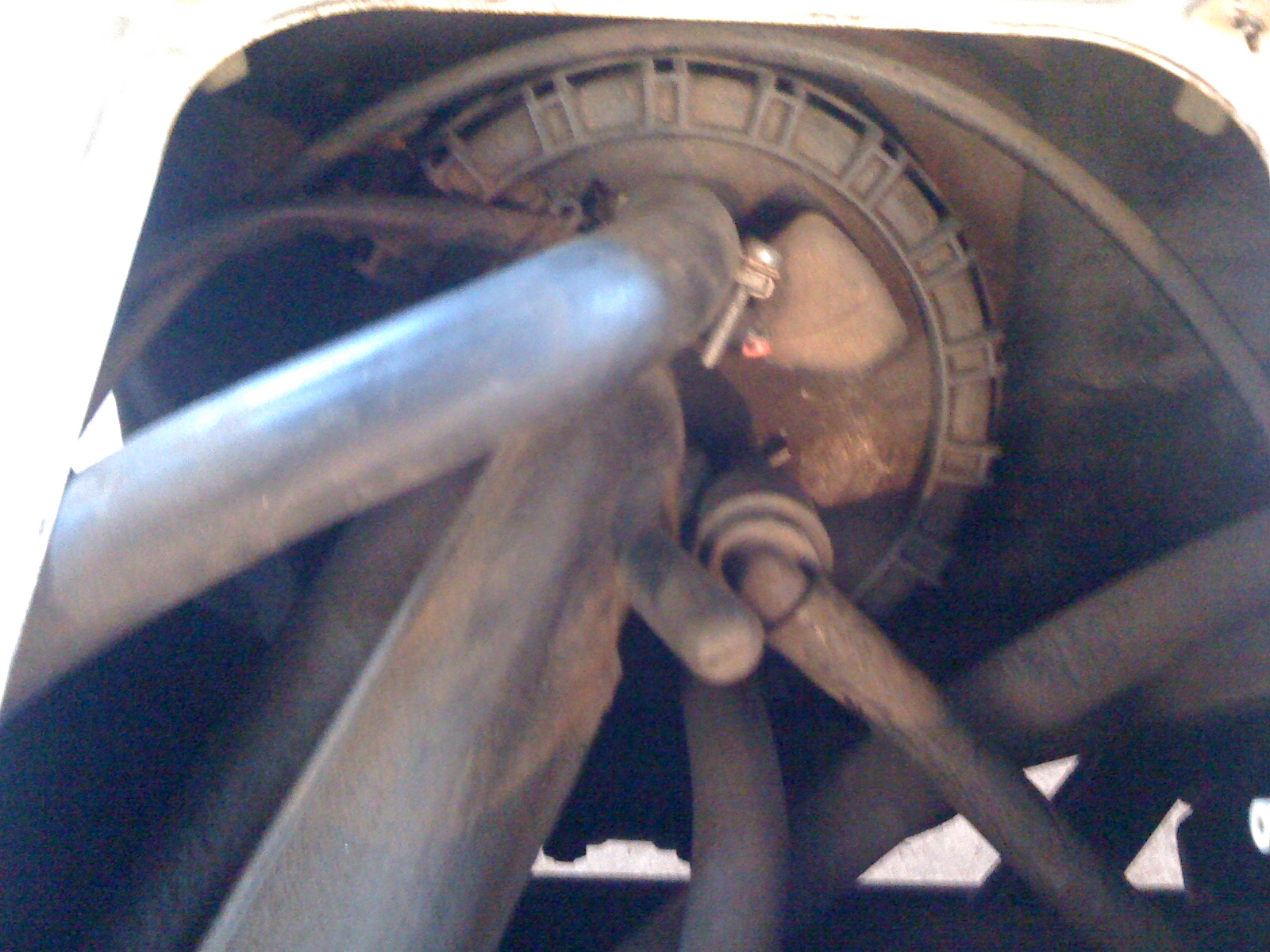

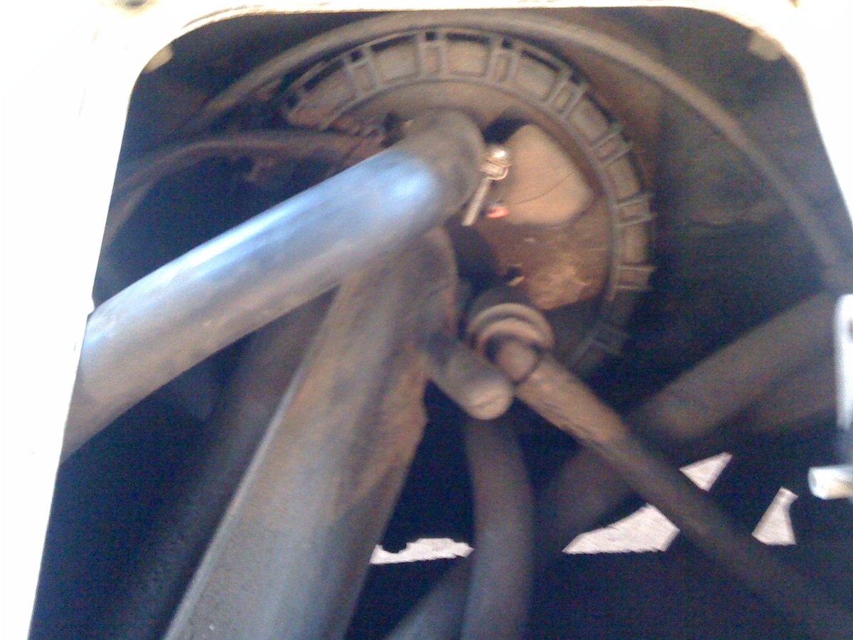

The scanner gave me no codes but followings are some phrases from the scanner:
Misfire monitor ready, fuel system ready, comprehen comp ready, MIL off,O2 sensor not ready,exhaust gas rec not ready,
Htd 02 sensor not ready,second air sys not ready, evaporative sys not ready,catalyst not ready,Htd catalyst not ready....Will
someone shed some lights on these for me please?

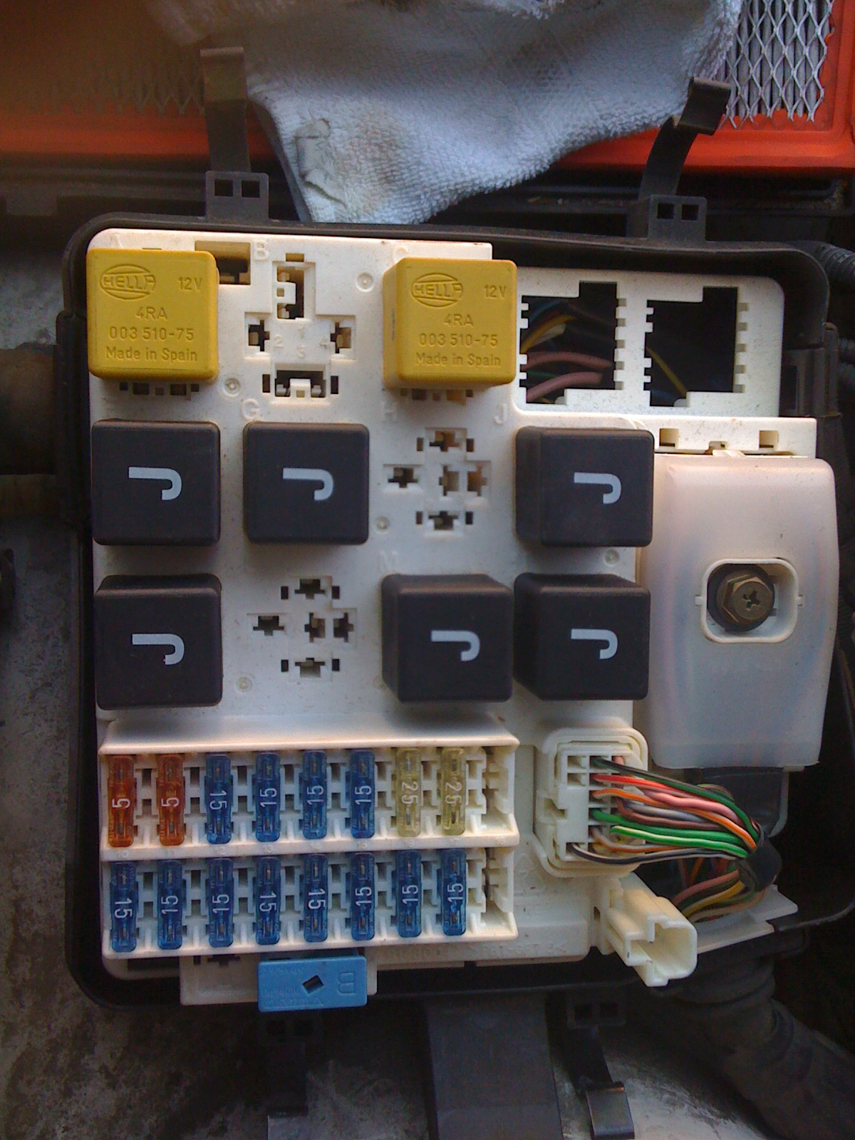

A. the right yellow relay is fuel system relay. is this a master fuel control relay?
B. How do I test the in-tank fuel pump (also called sending unit right?)...this is what i did: I measure the red wire
after i turned the key to pos II but not cranking and the reading is like .05v ...,the other wire like light blue color not
registered anything... Do I need to crank in order to read them correctly? And if they don't register anything (no reading)
can I say that the faults are with the relays or wiring but not the sending unit (the pump itself) ?
Thanks a lot
Ken
in-tank fuel pump
in-tank fuel pump
gas sending unit (in-tank fuel pump?)
volvo 97 960 sw fuel box

Post by precopster »
Don't bother with the in-tank pump. My Volvo 960 starts just fine with half tank of gas and in-tank fuse pulled.
In your previous post didn't you say you already swapped the relay?
The main pump will prevent starting.
Its function is to provide 80-90% of the fuel pressure. My own genuine pump failed at 120K miles and I had similar symptoms.
If you can provide power to the pump by bypassing the relay and shorting the live +12V at the relay to the pump positive terminal (also at the relay) this as about as definitive a test as you can perform, short of crawling under the car and testing for +12V at the pump while you have this short in place.
In normal operation the pump's power is cut when the ECU doesn't receive cam sensor or crank sensor input, to prevent fuel spillage in the case of an accident.
In right hand drive models, it's under the passenger seat. It may be under the drivers seat in the U.S. It's located behind a cage with four bolts going through four rubber grommets. The fuel filter is close by. It may pay to replace the fuel filter while you're there and have things apart.
The test about bypassing the relay is only to be totally be sure that +12V power to it is present. If you're not convinced and fear that the wiring to your pump is suspect just run 12V directly to the pump and see if it spins.
