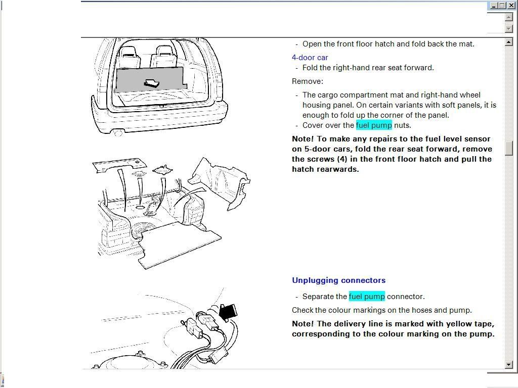

on 850 the fuel pump go bad. if you hit the tank with hammer at the sametime try to start it and it start. replaced fuel pump. the fuel pump under the cargo carpet in the back. remove the acess hole. the acess hole
has wire going to it.

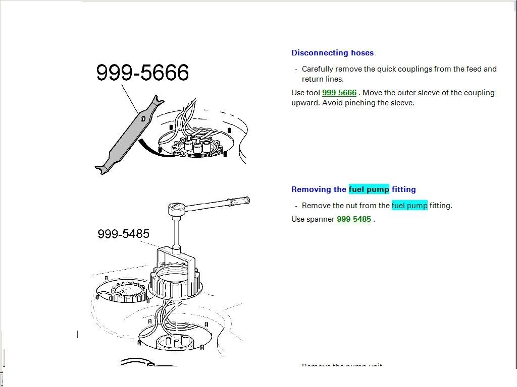

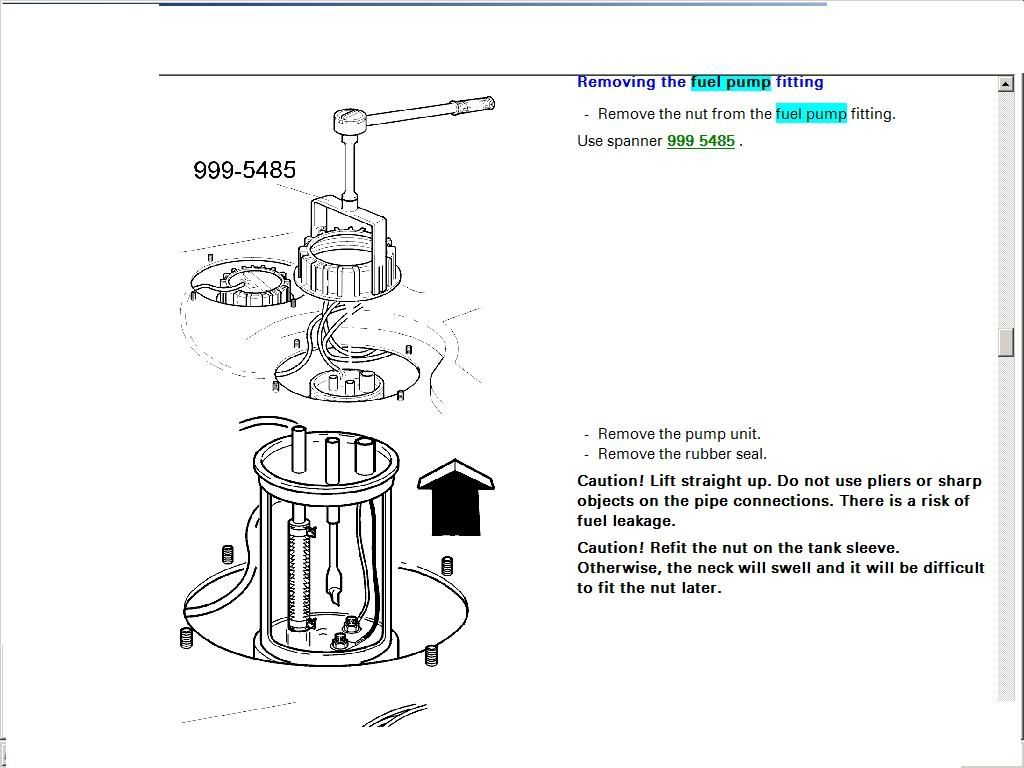

How do you break loose the large plastic nut to remove the fuel pump. I tried using something like a chisel but it just broke off one of the plastic tines.
Guest
Hi ... I tried making my own tool (without success) ... in the end I just used the wheel brace (which has a red plastic coating on the sharp end) to lever it in an anti-clockwise direction. Worked great!

Today i changed my fuel pump on my 850 93, i took an oil filter wrench
(ajustable you put a 3/8 ratchet on it). It worked great.

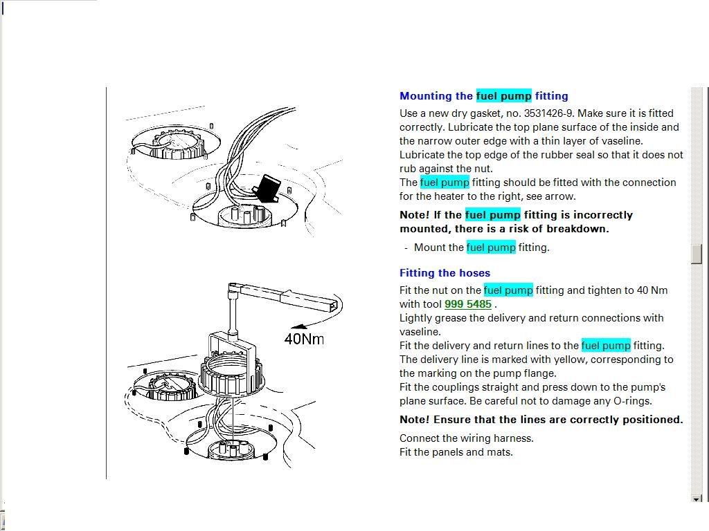

I am planning on replacing a fuel pump on a 1993 850 series volvo, I am pretty handy with doing mechanic work that isn't a problem but, i have never replaced a fuel pump before. Can anyone tell me before I tackle this project what tools are needed? And what will I be encountering?
Thanks for your replies...

MadeInJapan
