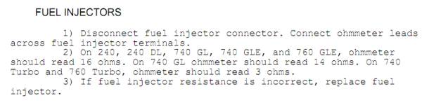

The only true way to check injectors is on a specialist machine. If you just want to find out if an injector is working try this:
240 fuel injectors.jpg (16.74 KiB) Viewed 3838 times

I'm pretty sure the injectors are -working- just not efficiently? I'm going to run some injector cleaner through and see if that changes anything. If not, I might try and test with the Ohmmeter... If I know how. Anyways, I'll report back with any info- Thanks!
