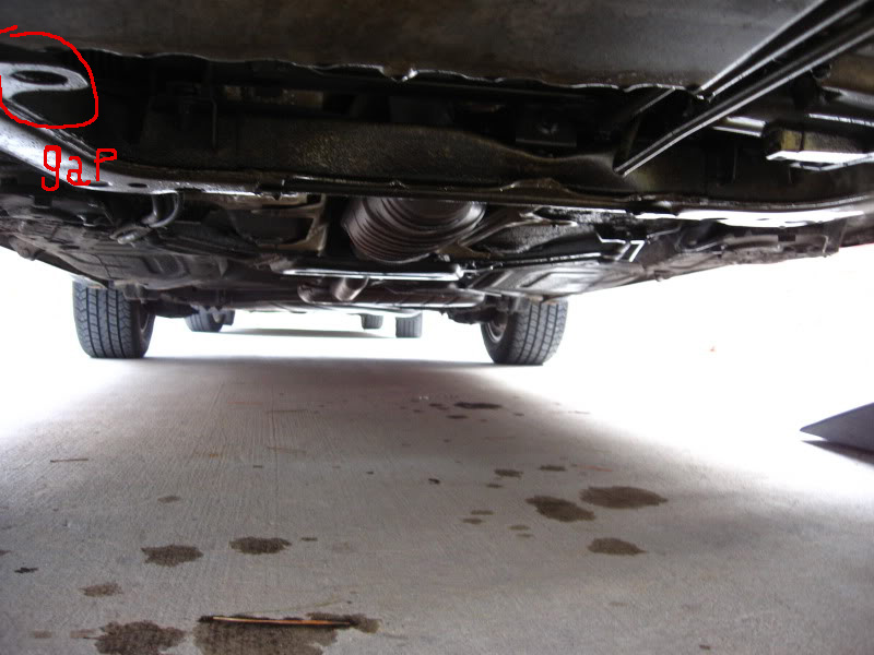

For the upper mount, you may notice the engine rocking significantly when you shift from R to D.
A jack under the oil pan will tell you if any significant movement is there from a broken front (lower) engine mount. You'll also notice if you can't fit a finger in between the oil pan and lower part of the subframe. The transmission buckle mount, if worn out, is visible just looking at it.
The hydraulic ones are usually ok; I doubt you'll have to worry about those yet.
