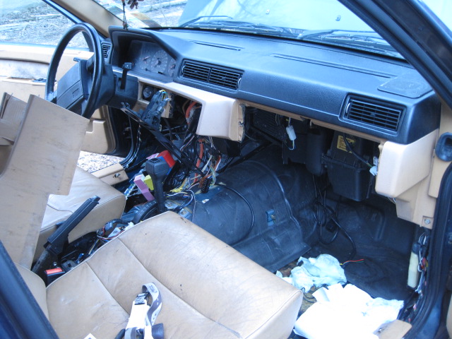

I just finished replacing my heater core yesterday! Here it is dismantled

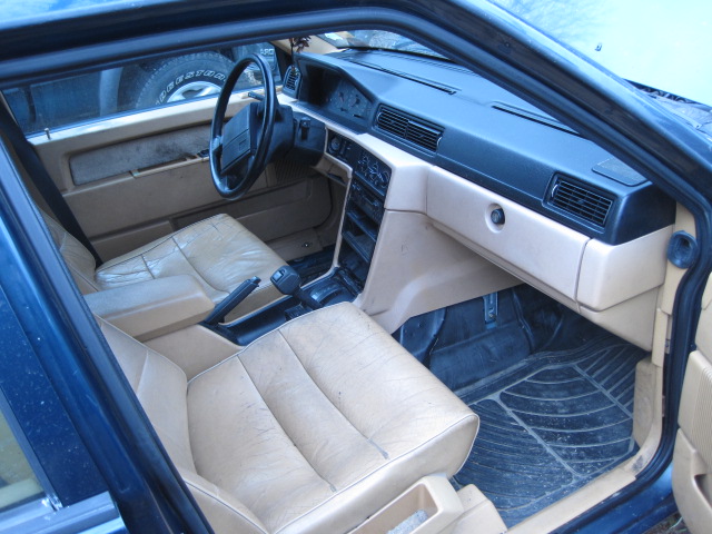

And here she is all put back together. I'm pretty proud of this fix, as I'm just learning how to fix cars. Wonderful resources, like this site, has made it possible!
