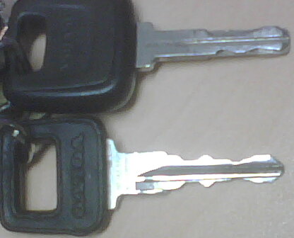

Post by jblackburn »
Take us a picture of your existing key - NO 850's that I know of had a chip in the key.
Someone here should be able to identify immediately whether or not your key has a chip. 850 keys were very skinny; 98 keys were a little fatter; 99 keys (with chip) were even fatter than mine.
Your key would be even fatter around than this one if it contained a chip.

Post by karltheozy »
I have to maintain two '96 850's both standard models - - both with the same type key - -
In this picture My wifes much older 940 key is the pointed plain handled key - - - - .
The much bigger thick handle ( nearly twice as thick ) is the 850 key .
940 key is much smaller and nearly half thickness - - -
I hope the Image shows up - - !
I also have had 2 x older 850's - - 93 and 94 - - they have smaller thinner key handles that do not have chips and look like the examples you have put on line .
Cheers Karl
Hmm. That looks like it might actually have a chip in it. If so, your next step would be to call a dealer and ask if there is a part number for an "ignition antenna ring" on your car. This is usually the problem the newer vehicles have communicating with the key.
