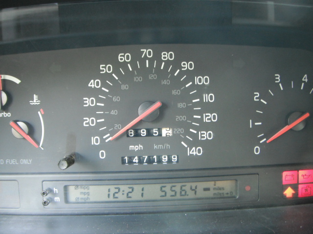

SO, I replaced my odometer gear and now my cluster records the mileage in KM not miles.
I reset the mechanical odometer and the digital trip meter at the same time and the ratio is exactly 1.6096 : 1.

- Pic of mileage difference
- DSCF0513.JPG (198.37 KiB) Viewed 2502 times
