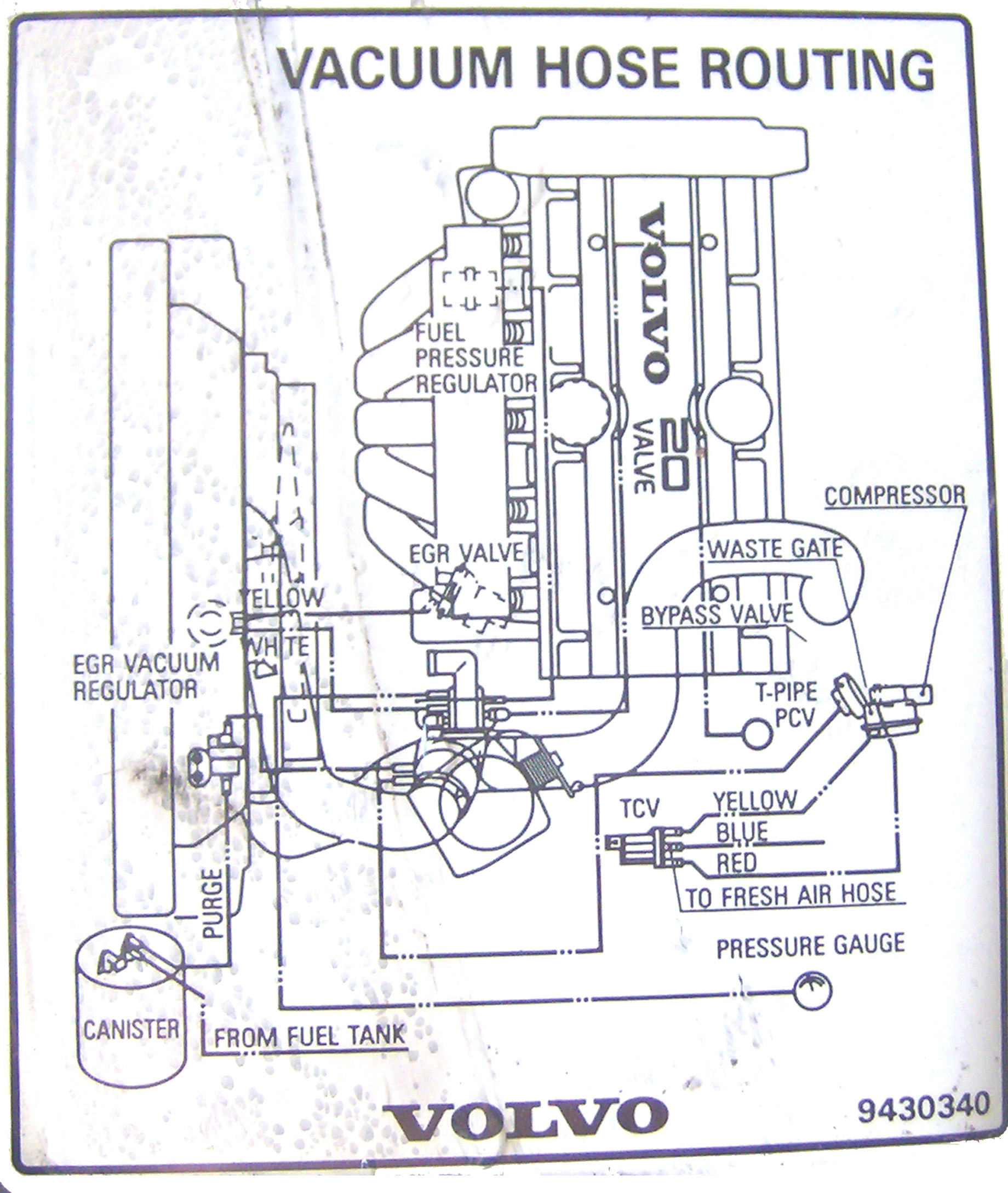

I may just go buy a new maf then. Is there some sort of diagram of vacuum hoses to check?

There is indeed!
If it idles consistently, a can of carburetor cleaner sprayed around suspect vacuum lines can help you look for broken lines - you'll hear a surge in the engine speed.
