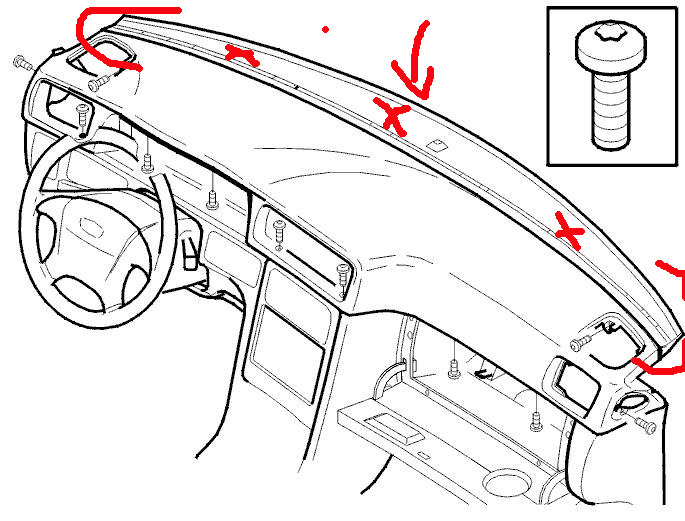

My wifes car was recently on an accident, the front plastic part on the dash that holds the security system light broke in pieces.
I need the name and or number of the part so we can find and order one.
Is it the actual plastic dash? What is it called?
Heres a diagram, its the part with red x's marked
Is it a complete part?
I thank you in advance for your help
The car is a 1999 s-70 T5

I looked it up on VADIS. It appears to be part of the entire dashboard. In other words, the top, is a separate part, and the under part is another part. The part number for the part you want is 9420907 for a beige interior, replacing older part number 94276999. That part is fragile. I have to replace one on our '97 850R.

I think your referring to the plastic black piece which appears to be running just below the windshield and sometimes contains the flashing security light. This is actually part of the whole dash and is not sold as a separate piece. You can unscrew it by removing the cover outside the car right under the windshield wiper stalks as well as a few other screws inside the car.
The dash pad is a separate piece and contains the passenger air bag.
Quite often these develop cracks on the front and can squeak if the support bolt brackets which are plastic break.

Correct. That is what im looking for.
So theres no separate number/ name for it?

i do not think your going to want to buy a new one at $$$$$$$. You should just buy a used dash. Most of the parts which are the wood inserts can be removed from your old one and installed. If there are cracks in it but still supports the dash your better off trying to repair it or glue it together.
