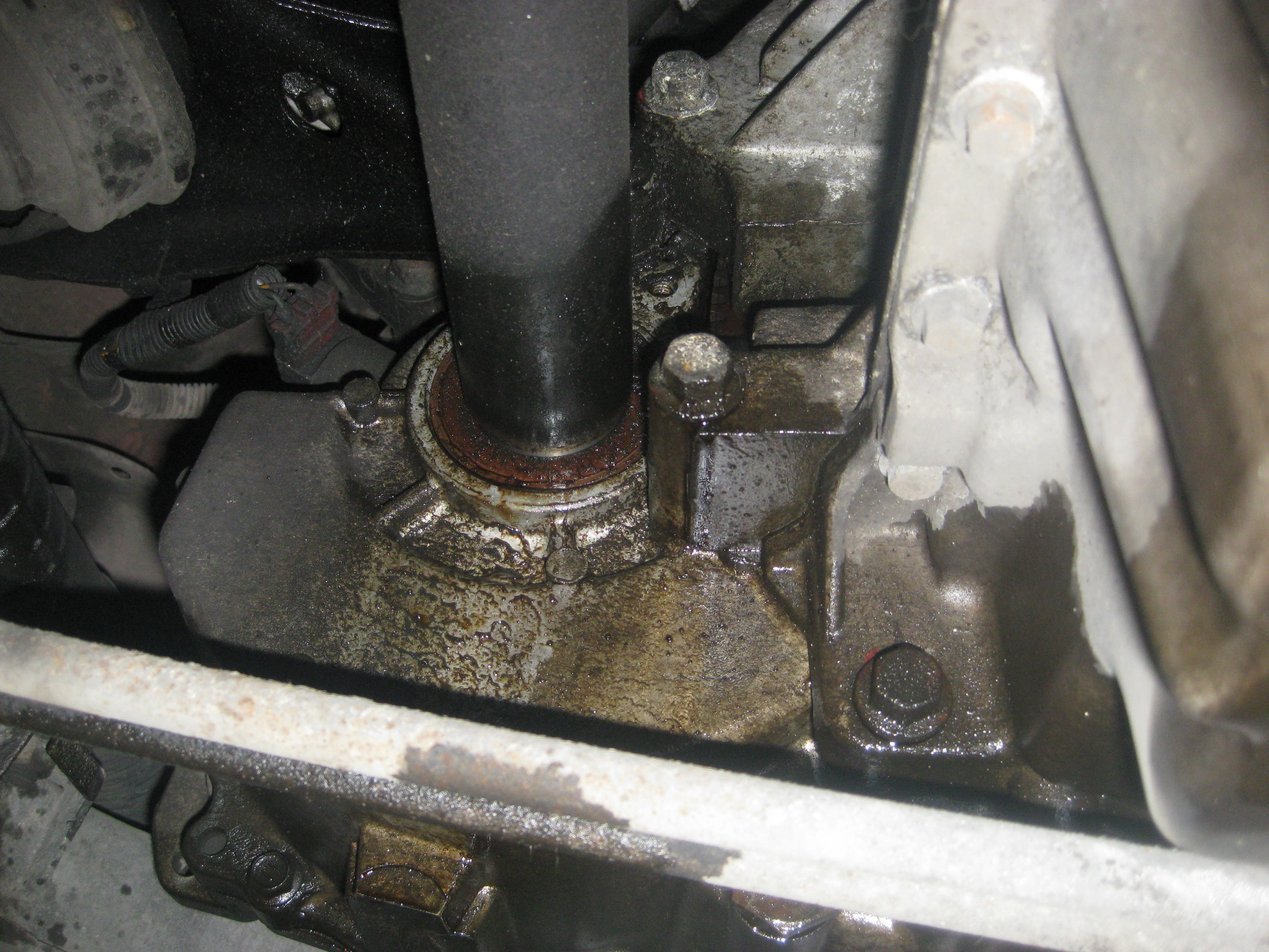

Anybody know what this leak is?

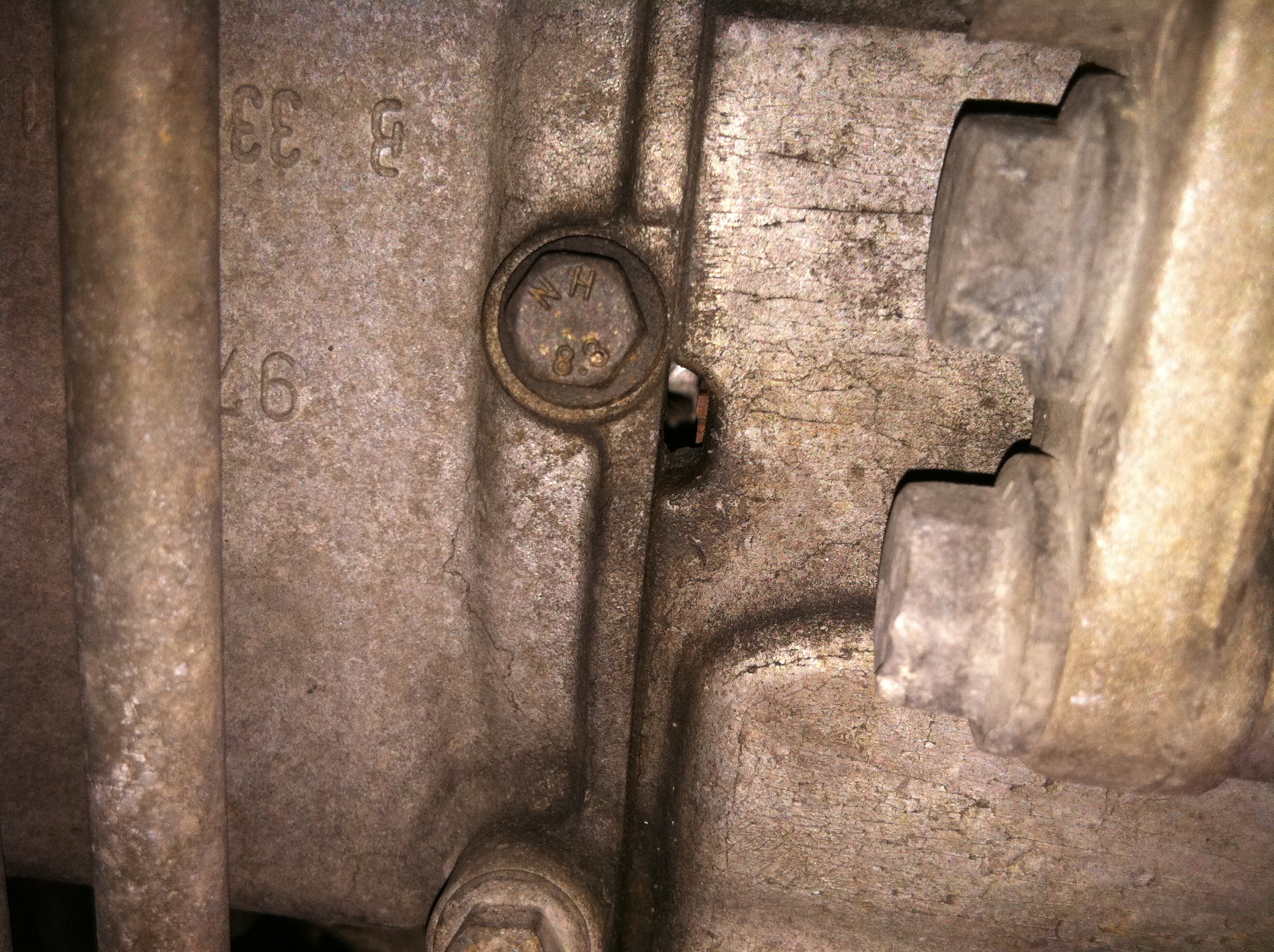

Transmission weep hole
That's an odd one, really. It's not the distributor cam seal as the front of it's dry, but the oil does travel up a bit to the front of the transmission. Hmm.
Like others said, I would clean up as much of the oil as possible and then try to spot where it is coming from. Check this area too for oil. That's your (other) rear cam seal.

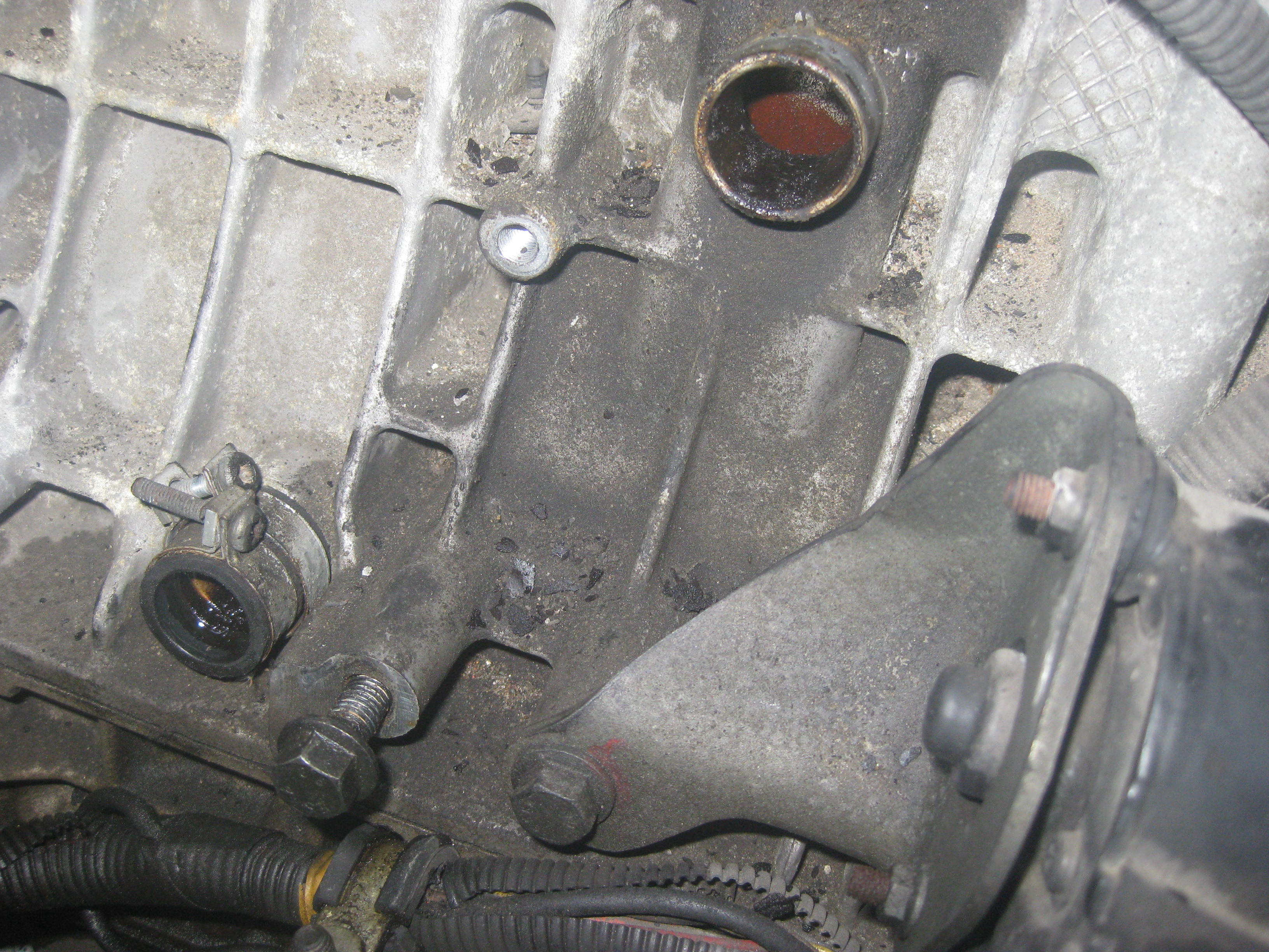

Thanks for the photo of the weep hole, here is mine.
I think this is the weep hole!

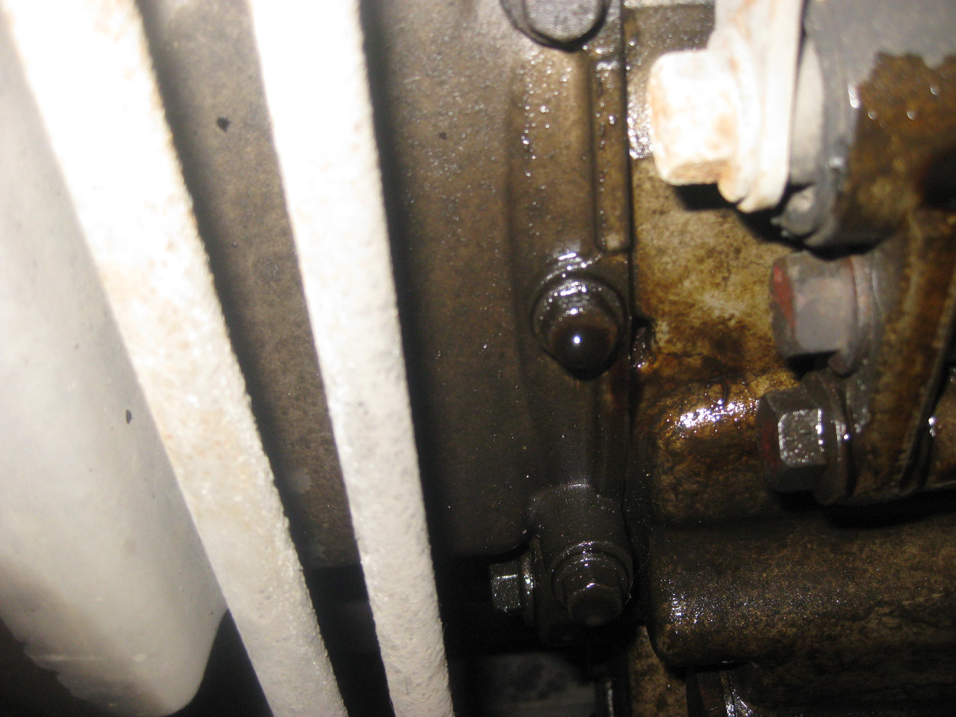

could this axle seal have gone (photo is upside down)?

that big drop of oil on the bolt for the oil pan is not a good sign. Main seal.

Hrm, yep - it looks like at least some (most) of it is from there. I still don't know if that would explain the oil on the side of it - but that's the only real scenario for the underside of it being wet right at that hole.

Yeah, looking up at the engine it doesn't look like its the oil return pipe. Main Seal is most likely gone.

crezzy2k1 wrote:Yeah, looking up at the engine it doesn't look like its the oil return pipe. Main Seal is most likely gone.
I checked and no oil stains at the back of the motor, there is a lot of oil under the turbo and the grey part of the turbo is covered in oil!

To be 100% sure change the oil return o ring and gasket, and get some carb cleaner and clean it up good under there. Check to see how much oil is coming through that weep hole. I couldn't say how much a garage would charge to change the rear main as the engine and transmission must be removed from the car (not an easy job) here in the UK it would probably cost more than what the car is worth. There's a good write up in the repair section on how to do it yourself (if you fancy it ;-)
You never know you might be lucky it may well be that o ring and gasket!

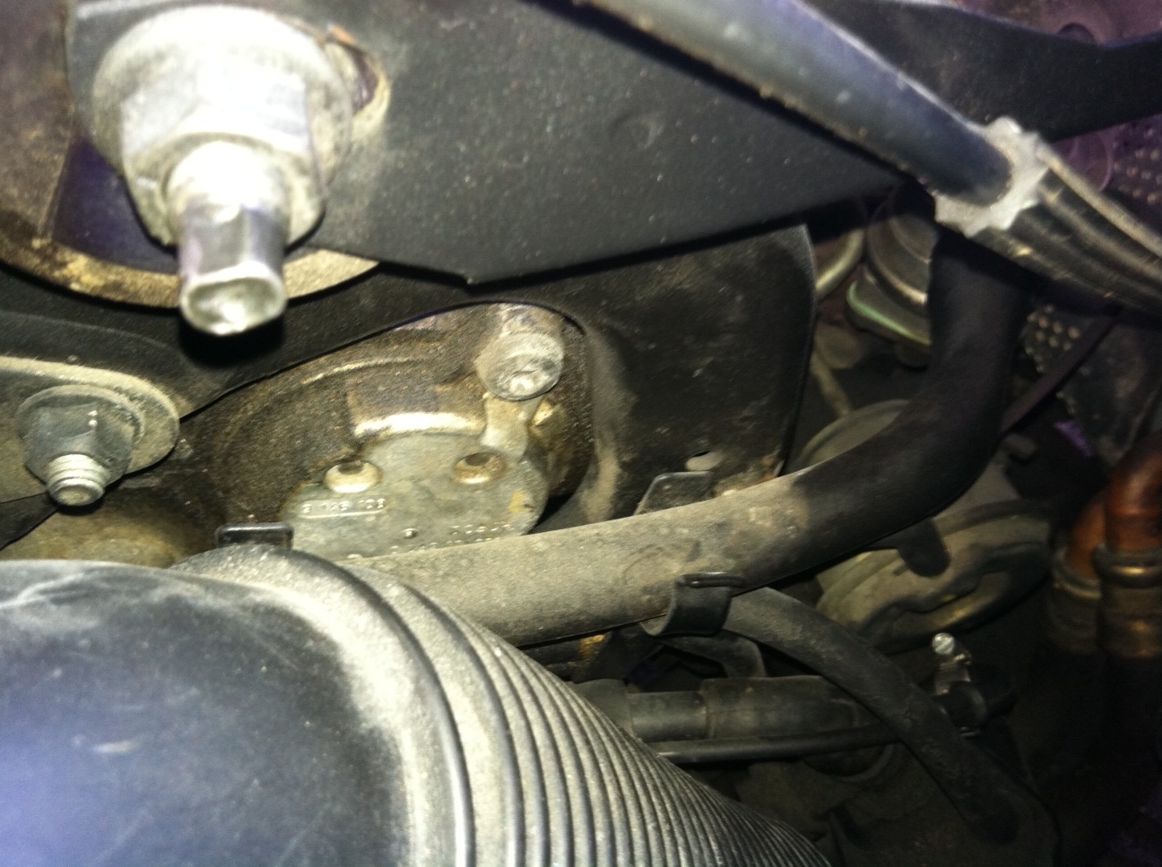

Oi, that explains something then. I was trying to see how ALL of that would be from the RMS - the pattern is weird.
The good news (maybe) is that oil on the turbocharger is from a blown-out rear cam seal under your cam sensor. Change that seal, clean up as much of the oil as you can, and see if the RMS is still leaking significantly.

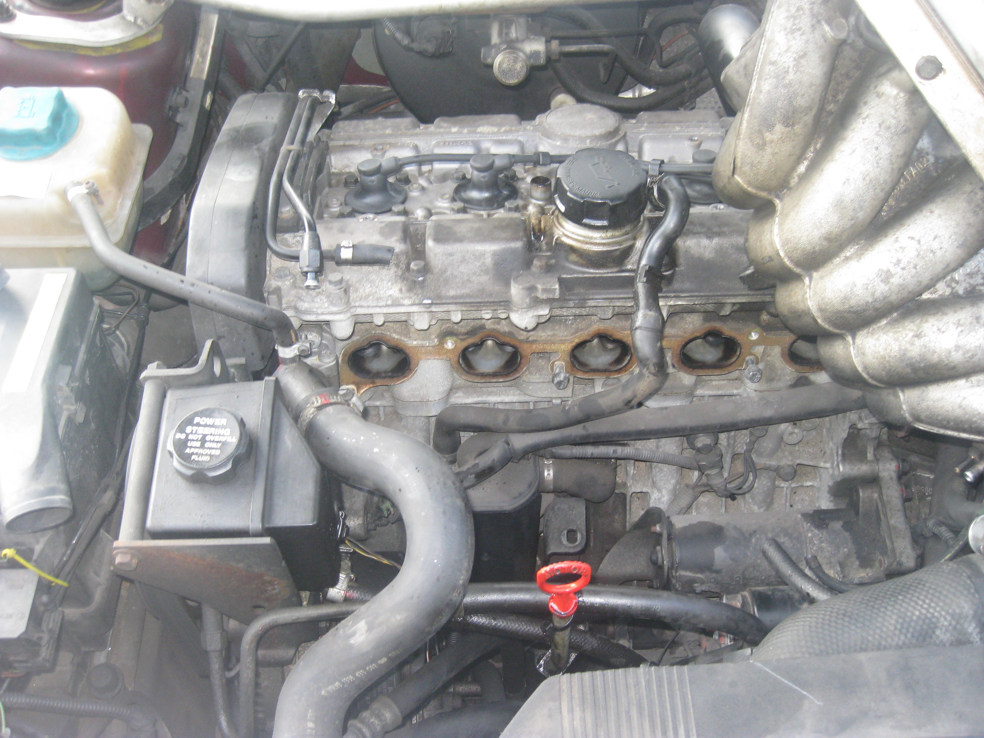

I thought I would update everyone with the current situation. I am getting the car looked at on Thursday but all indications point to a failed rear crank seal. I lost nearly 2 quarts of oil since Friday, it is blowing out past the seal and under the bottom of the car. I have the tell tail spots of oil all over the tailgate. Also the dipstick was pushed right out of its sleeve and oile was all over the top of the engine. Worst is going to be the clean up!!
Anyway, I surprised myself and completed a full pcv system overhaul in 3hrs!! I did my first one 18 months ago. Wish I had the confidence to do the RMS. So the garage are going to quote me on Thursday for replacing the rear main seal.

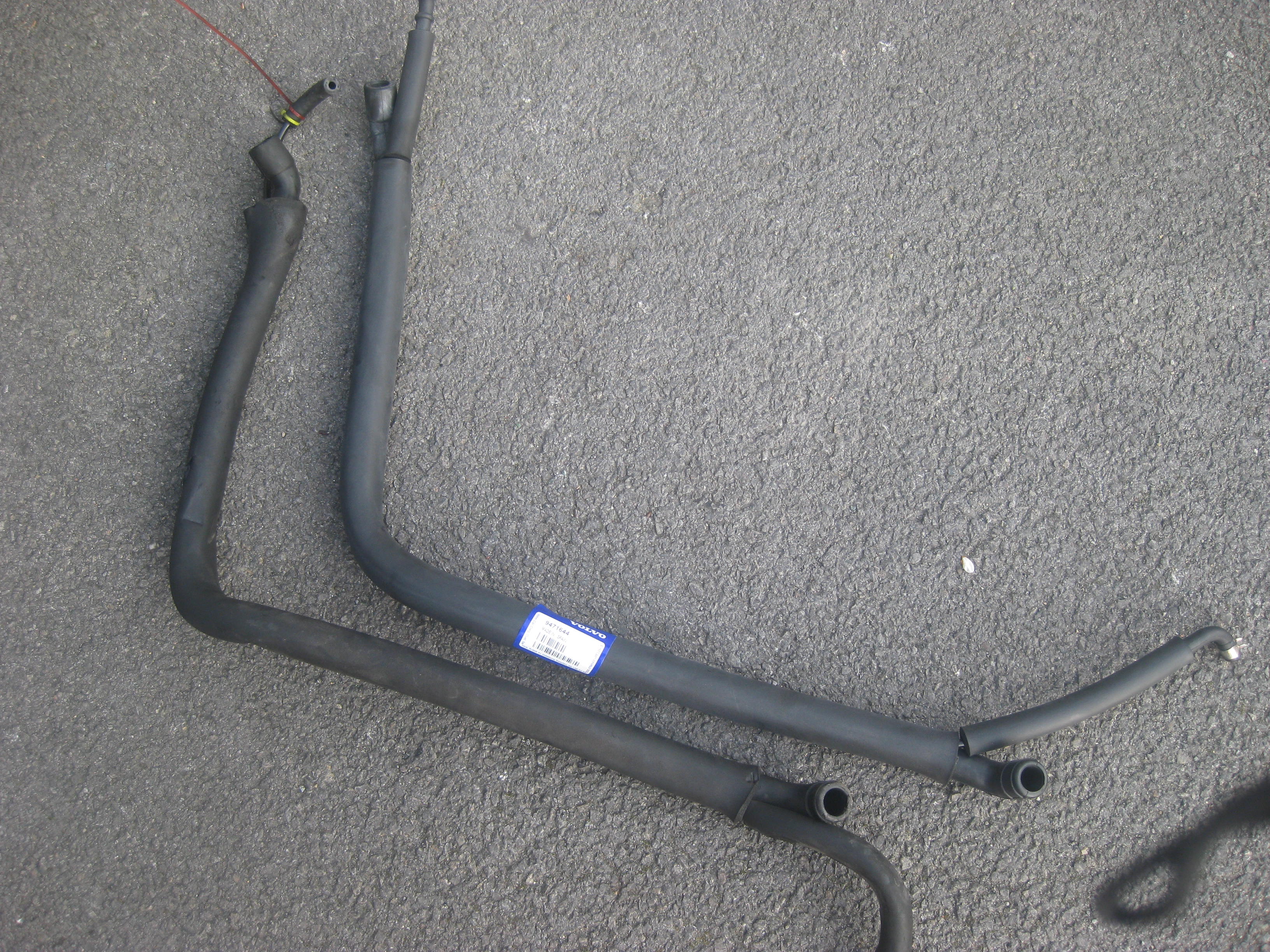

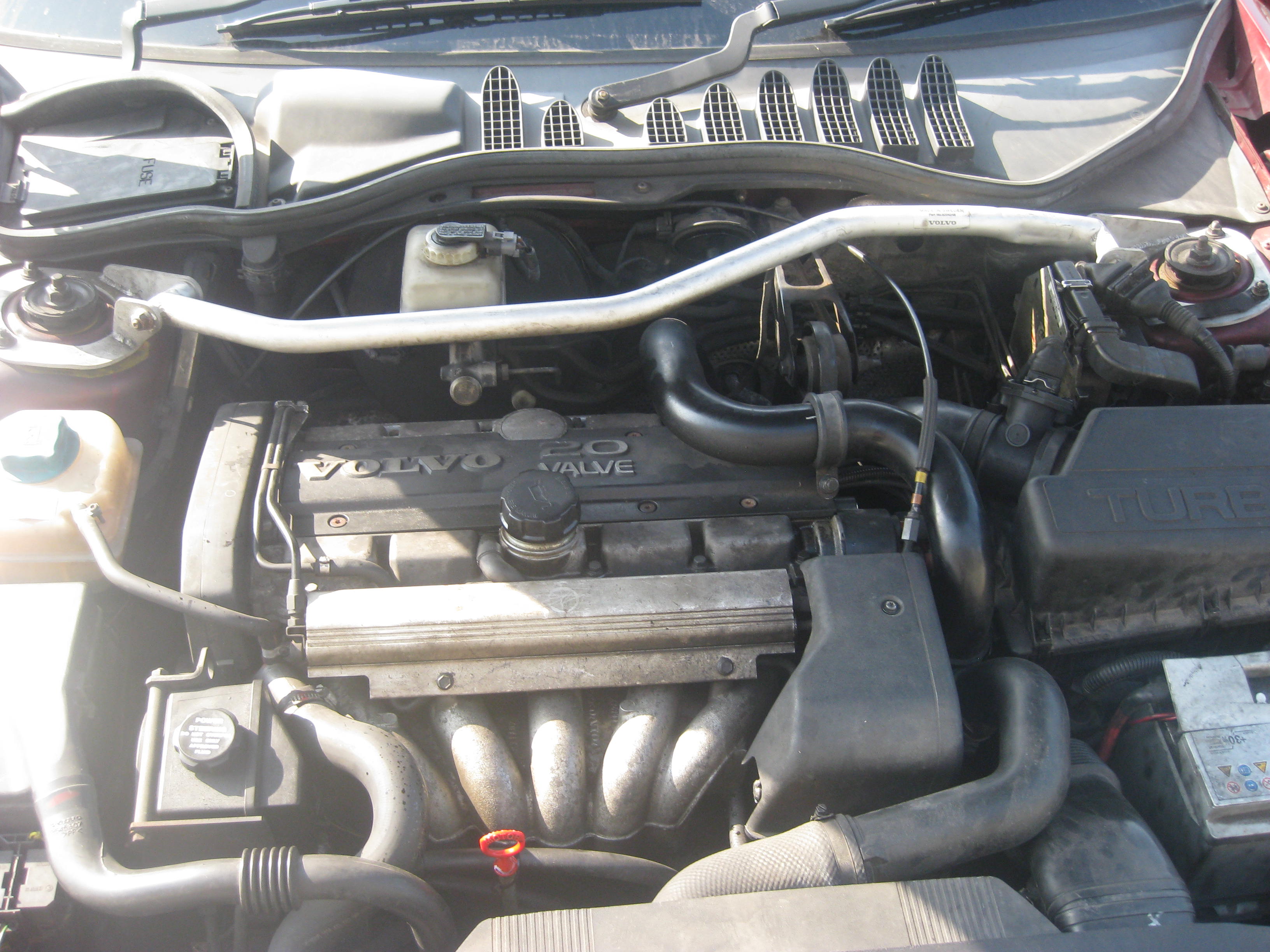

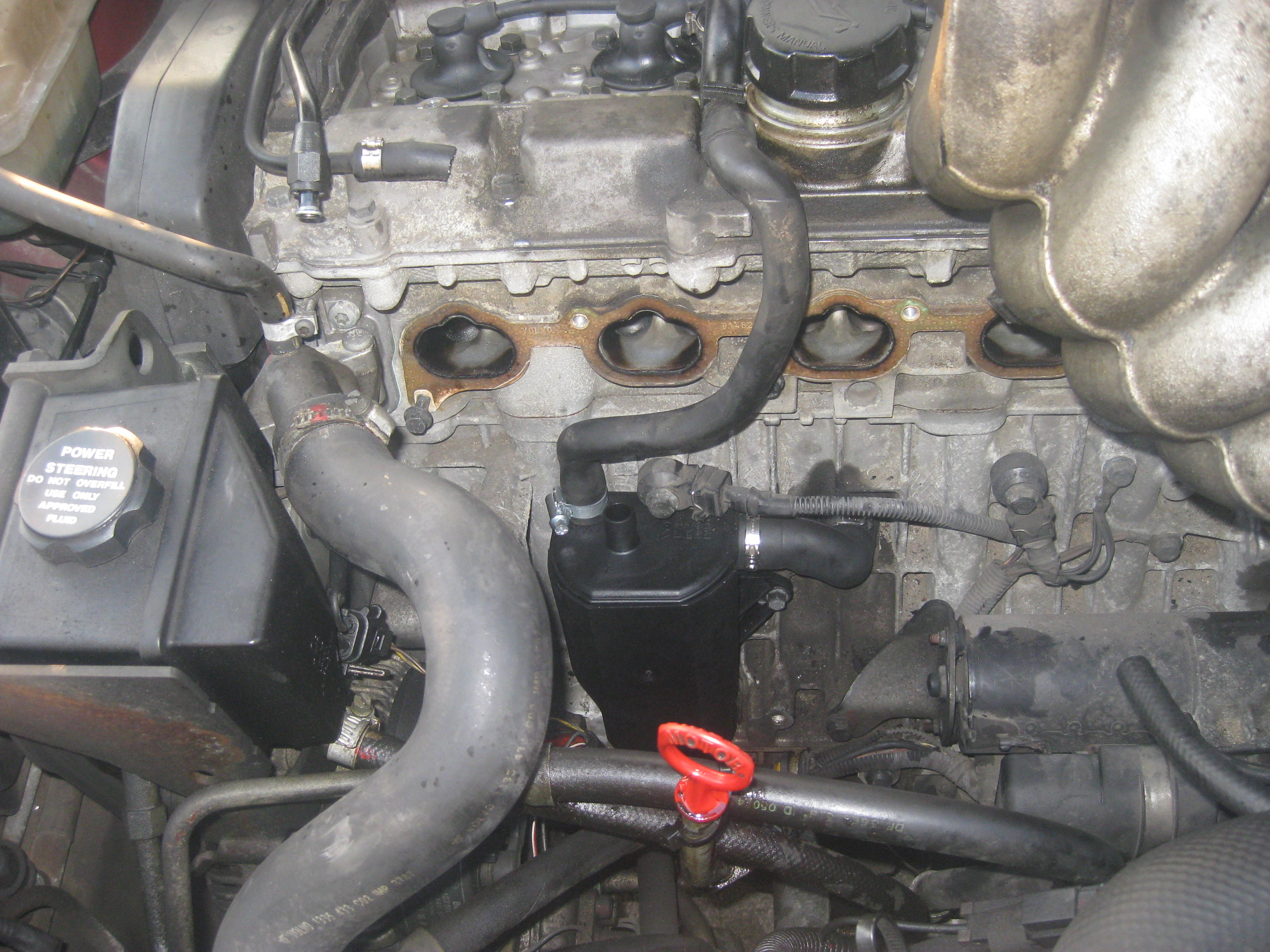

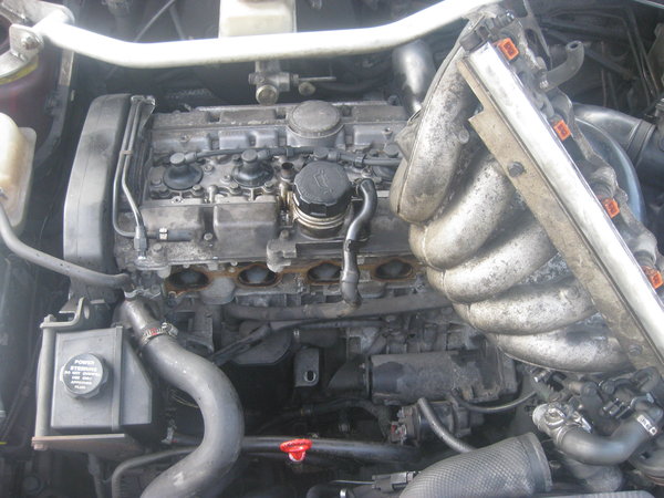

Here are some photo's of my pcv work.
Regards
Matt
The breather box and the 2 holes in the block were clear.
The hoses weren't in good shape, the large hose had a split in it and the small vacuum hose was blocked solid.  I don't think the pcv was doing its job but I don't think it was the cause of the rms failure.  Hopefully the engine isn't too worn and causing excessive blowby.
