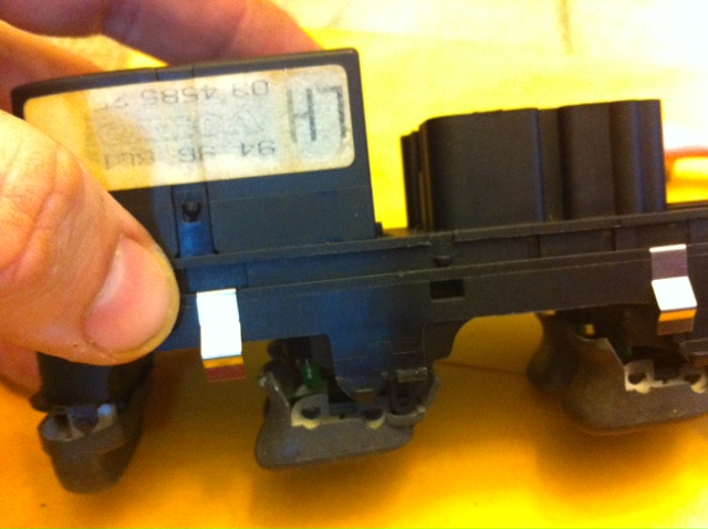

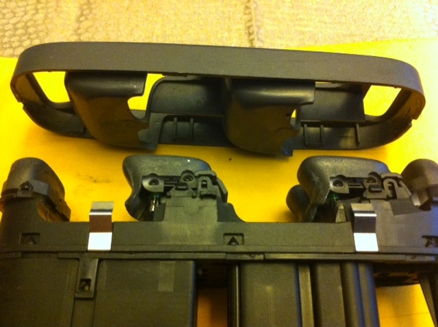

Now take the switch to a clean work area then using a small flat screwdriver pry off the grey trim piece from the top of the switch. There are 3 tabs on each side and one tab on each end.
photo 5.JPG (177.06 KiB) Viewed 35175 times
photo (6).JPG (188.82 KiB) Viewed 35175 times
Optional: give the trim piece a good cleaning with soap and water

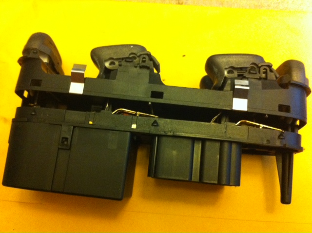

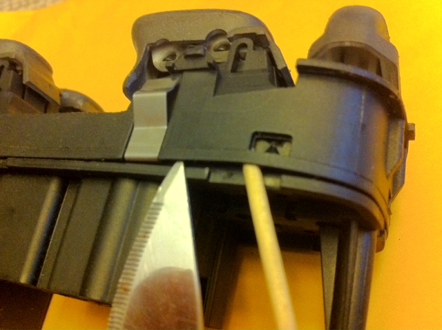

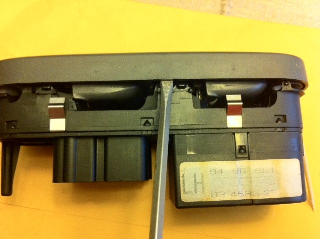

Set aside the trim piece and now lets open the switch assembly. It has 3 tabs on each side and one on each end. I used a thin knife blade to release each tab and then inserted a toothpick into the tab to keep it from re-locking while I worked on the next tab.
photo (7).JPG (108.65 KiB) Viewed 35175 times
photo (8).JPG (100.77 KiB) Viewed 35175 times

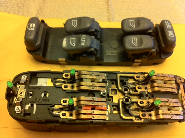

Here it is opened up. You can give the top piece a wash with soap and water is you wish. Don't use water on the bottom piece.
photo (9).JPG (136.76 KiB) Viewed 35175 times

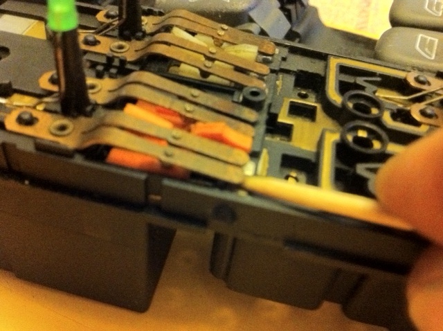

The brass spring fingers are the contacts for the window switch. This is what we need to clean. I used a toothpick wet with some electrical contact cleaner to clean at the contact point of each brass finger. Do not bend the brass fingers just lift them enough to get your toothpick under them. Don't go after the contacts with sandpaper or you will be buying a new switch soon.
photo (10).JPG (130.61 KiB) Viewed 35175 times
Here is what was under mine.
photo (11).JPG (102.51 KiB) Viewed 35175 times

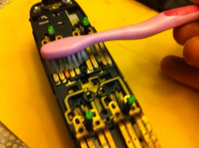

Now I brushed off the inside of the switch assembly with a dry soft toothbrush
photo (12).JPG (109.16 KiB) Viewed 35175 times
