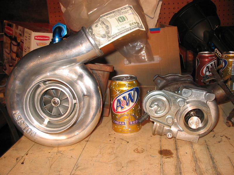

The photo is a standard S80 T6 turbo as opposed to something larger, well VERY large.

- Standard sized turbo
- 59118560.jpg (85.08 KiB) Viewed 4266 times

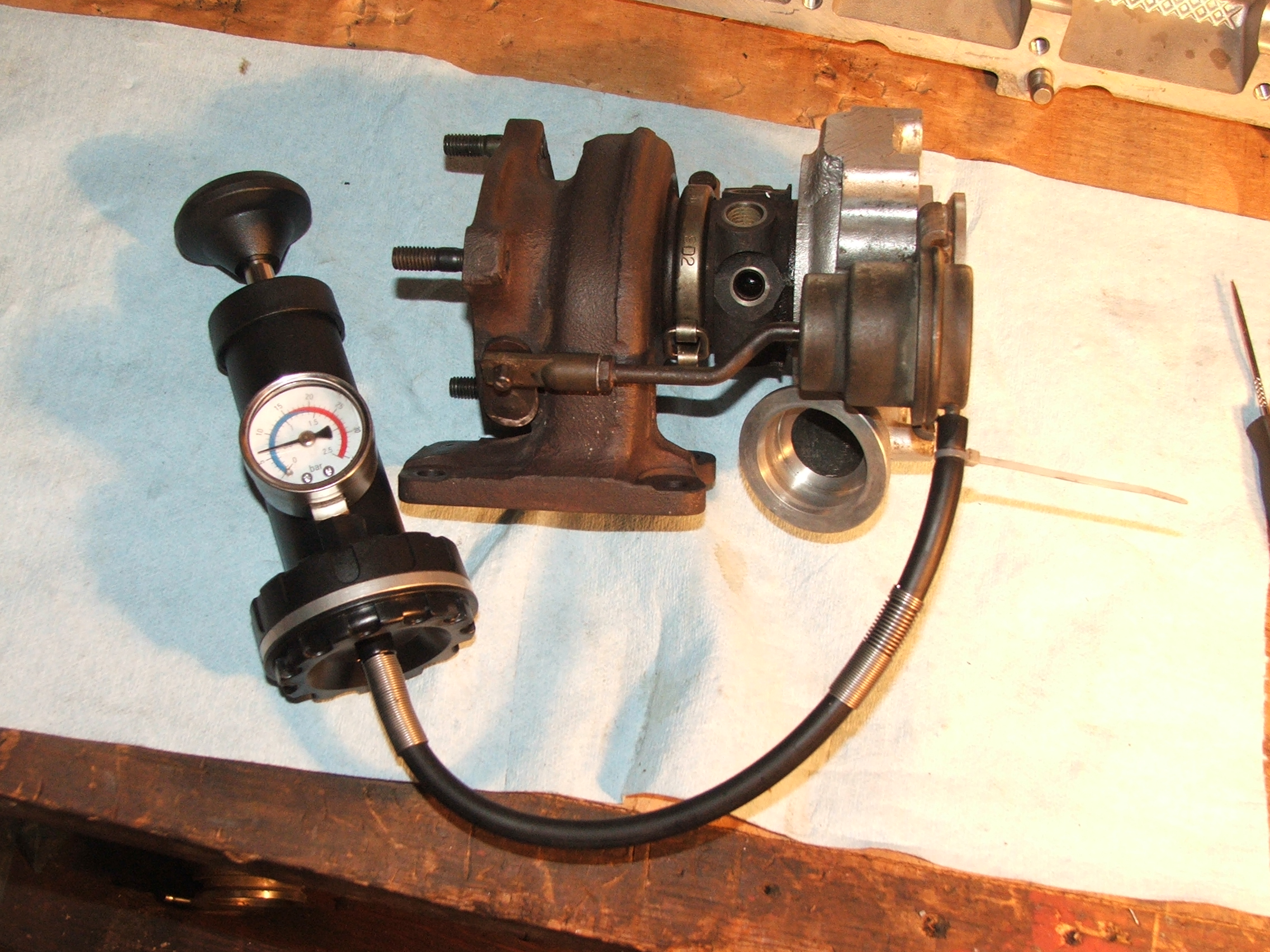

To set the wastegate actuators, spray a little WD40 on the threads for the adjuster, and loosen the locknut. Then disconnect the rod from the wastegate(s).
Next apply 6.75psi to the actuator line (metal pipe at the back of the motor, near the transmission dipstick. It should hold the pressure, if not, fix the leak before you go any further.
Go to one of the turbos, ensure the wastegate is closed fully by hand, then screw the end of the acuator rod until it drops perfectly onto the pin on the wastegate shaft. Its important to make sure the wastegate definately closed by hand and that the hole in the acutator rod drops right onto the pin with not movement of the rod or wastegate.
Hope this helps
